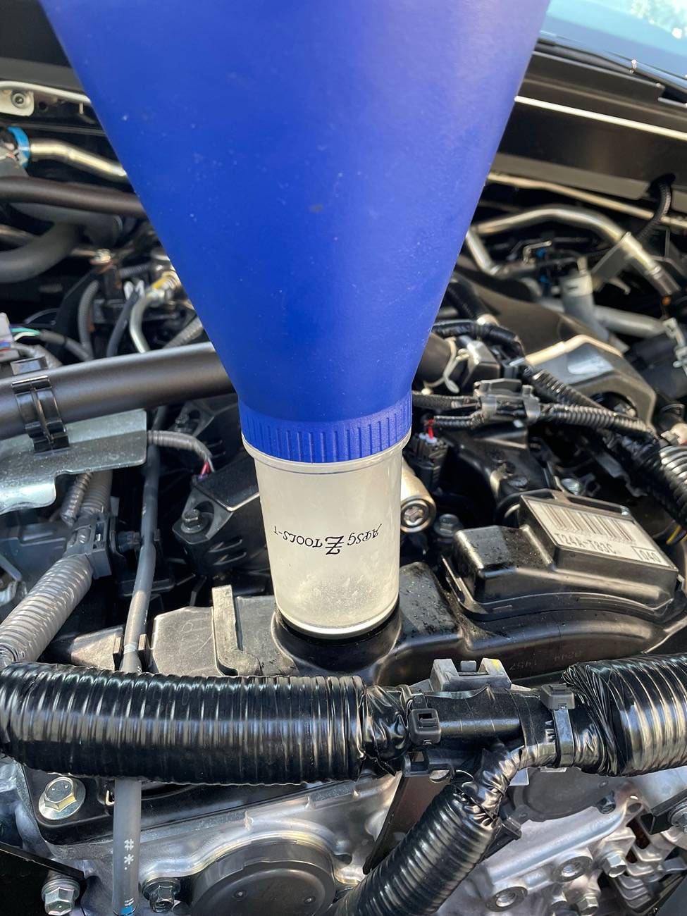

Anyone have any idea what spin on oil fill funnel would work good with our trucks? I’m trying to avoid buying a universal one and can’t find anything specific. Any links would be most helpful as I’d like to get my oil changed soon.

The APSG Locking Oil Funnel here https://amzn.to/3Gug0sm is the one you want.
Also suggest a moldable, foldable oil drain funnel (here: https://amzn.to/4lc1pAR) to wrap around the crossmember for when you take off the oil filter. Even though there's a lip and drain under the filter, it's too far back and drips oil on the crossmember. This redirects it and cleans up nice with a shot of brake cleaner. Don't forget crush washers if you don't already have some: https://amzn.to/3TUQ7Fc

I cut the bottom off a quart of Mobil 1. Fits just fine in the oil fill tube. No additional cost. Regarding the use of a shapeable funnel when removing the filter, good idea - I drained more oil from that area than I expected. I bought the cheapest one I could find on Amazon - works great. One factory - lots of sellers.

What kind of funnel do y'all use when refilling new oil? I performed my 1000 mile break in oil change last week and noticed that a skinny neck funnel was all I had that wouldn't make a mess, but it took forever to pour all the oil.
2,365
3,061
Thanks @saerandy! I already have the formable one, which can stop a really nasty mess for sure.
I have never used a spin on oil filler, but that looks like a great idea and should save some time and possible mess too.

Recently changed mine and used the Toyota oil quart cut half off it screws into the oil fill perfectly

I will second this. I used my flex funnel for the first time this morning on my third oil change. It worked as expected. No fuss. No mess. Combine this flex funnel with a Fumoto F103N drain valve and oil changes could not be easier.
