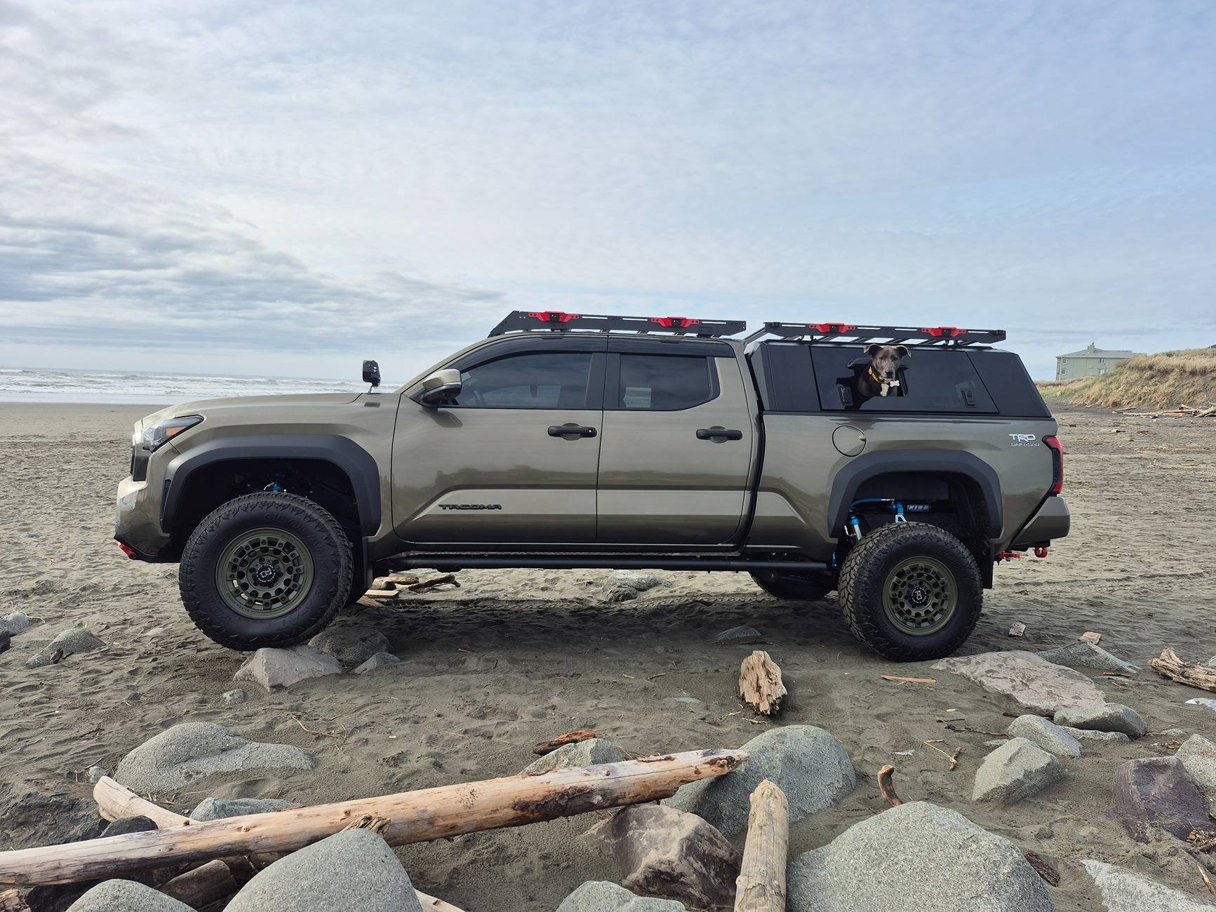

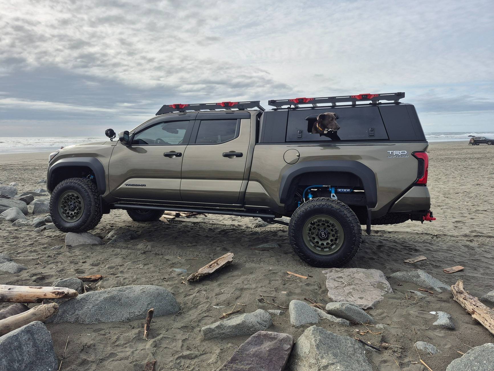

Thanks, but fortunately ☺ I am early retired at 55. My taco, aka (The Widow) She is my mid life crisis paid for by my wife.
I'm building this for overlanding
Sanhema roof tent ( this week )
Bunkers 270 awning ( already have)
Waiting on canopy.?
Full graphic wrap
Still have front aluminum bumper winch rear winch bumper and swing out Planning on camping all over the state with the wife and I hopefully, we'll hook up with groups
