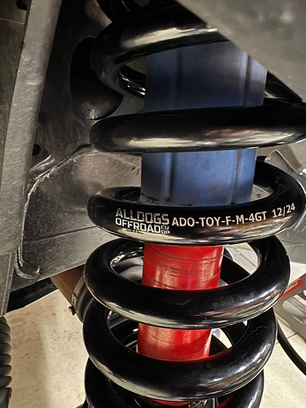

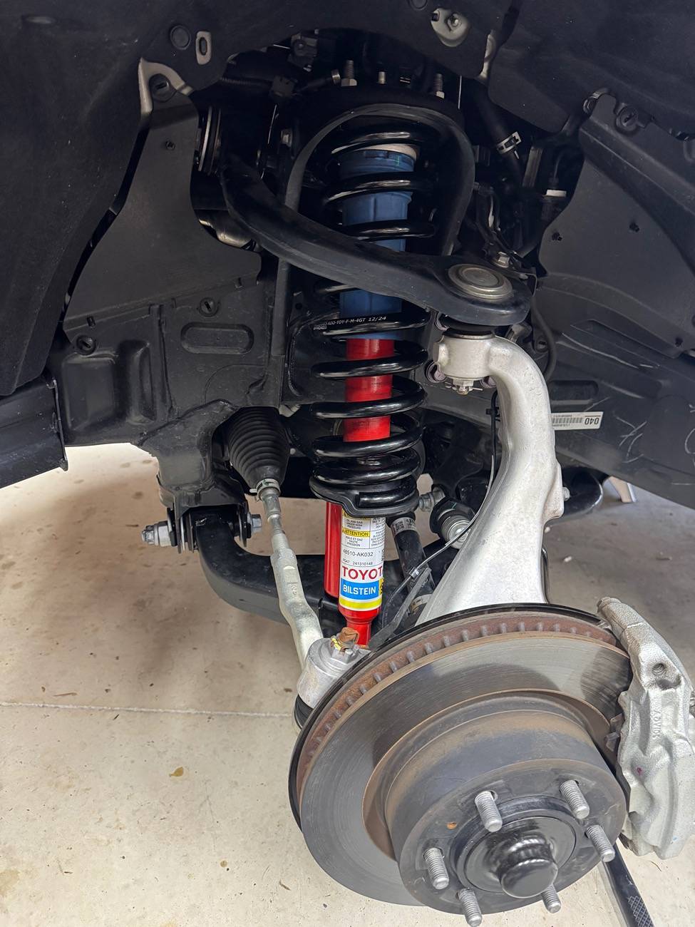

Blue_Taco
Mark
Jan 12, 2025
DFW
Mike, it looks like you just installed the front springs? Did you get the 1.5" Alldogs shows on their site? In the video they got 1" up front which would be perfect for me.
mikeymtbs
Jan 24, 2025
102
109
Atlanta, GA
24 TRD Offroad Premium
Hard to say because I had a Westcott Designs precollar spacer on the front before, and still have their collar on the rear springs. I’m not sure what the OE floor to fender measurement was previously, but now it’s ~38” from floor to bottom of fender thru the center of the wheel. It has continued to settle some, too.
I also have 285/70/17 tires in, so that adds some height, too.
