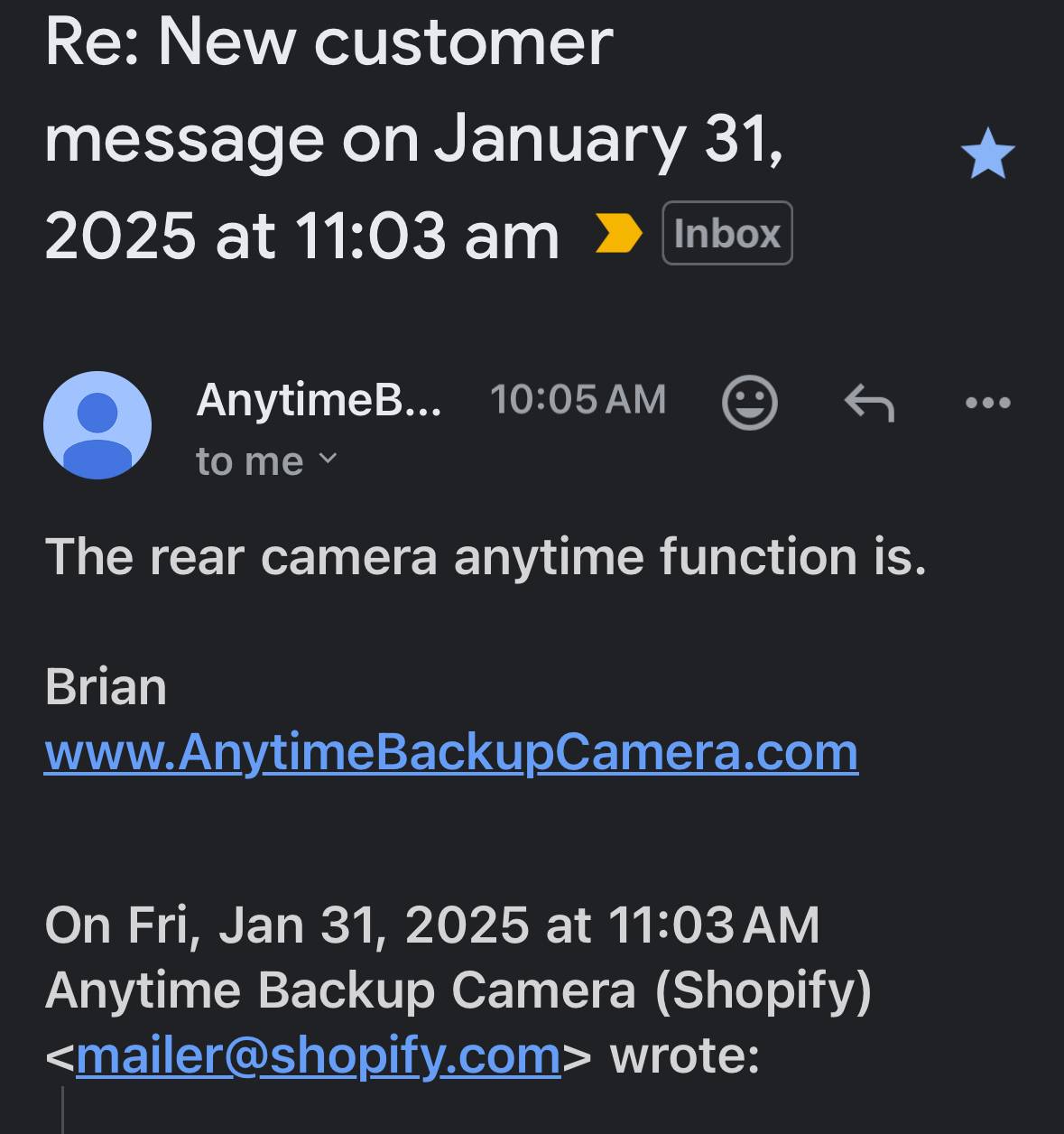

Also emailed anytimebackup camera they said only their rear camera is compatible on 2024 tacomas.
