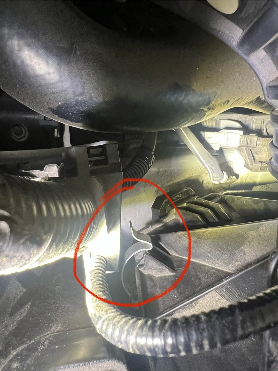

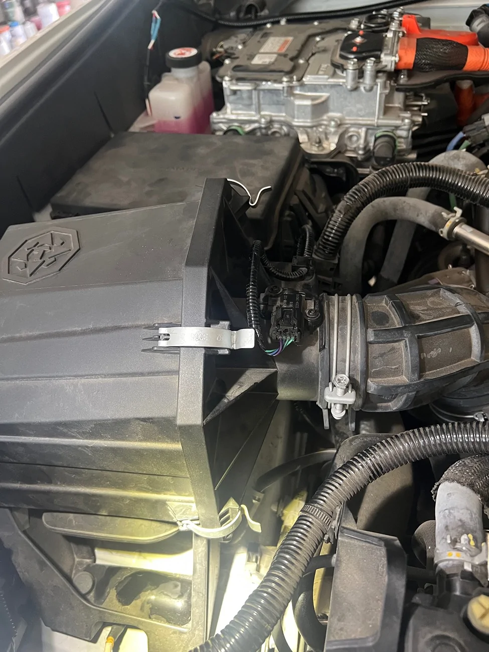

Hey guys - when I picked up my trailhunter from the dealer for its 20K mile service, I noticed one of the clips on the airbox was unclipped. I could not get it to clip down. I called the tech out and he kind of forced it to clip.
I got home, undid all the clips and the filter appeared seated correctly. So, I re-attached the filter cover (using the slot on the bottom to guide it and secure the bottom part). And I still had a hell of a time getting the last clip to secure. I was able to do it, but something feels off.
I am wondering if anyone has had this issue or I’m doing something wrong.

Thanks! If you get in there, you can close it but it does cause the plastic on one side to bend a little bit. But the filter on the inside looks flush and fine.
Second question - when you want to change the filter, do you pull the side closer to driver side up and out, to move it out of the way? I don’t want to damage the intake.

All true. But are any of your clips particularly challenging to attach? One of mine is. The filter and housing seem to be seated correctly. When I force it to clip, it bends the housing slightly. So I’m wondering if this is normal. It’s the fourth clip down low near the fuse box (closer to the cabin). Would you mind looking at that clip on your truck and just checking if it clips and unclips normally? All the other 3 clips on my truck attach on and off super easy.

It’s the 4th clip that’s a mutha — the one hardest to reach in the tight spot near the bottom of the box. Clipping it first is the way to go. Had to pull it since a human hand butt can’t fit, lol. Might need to press the lid on either side before clipping it in.
The system won’t let me upload a video of the successful easy closure…but here’s a pic of the step used for leverage. If you want the video, be glad to shoot it to you, just DM me your phone number.

Haha, yeah I did the same exact thing. I got a step, got my hand underneath, and clipped it from the side. It clipped right on.

Also, I found it incredibly challenging to remove / inspect the air filter. I kind of inspected it from the side by pulling it out some, and it looked fine, but I could not remove it—not with the other half of the housing basically forced against it. How do you get the two halves of the housing far apart enough to pull the filter out? First off, they are jammed together like the devil. Secondly there’s a sensor wire that doesn’t let you move them that far apart. Any tips?

As far as getting the filter out, I will look into that and update us on what I find. Probably need to loosen the hose but will confirm unless somebody else chimed in with what we can do to make it an easy job.
