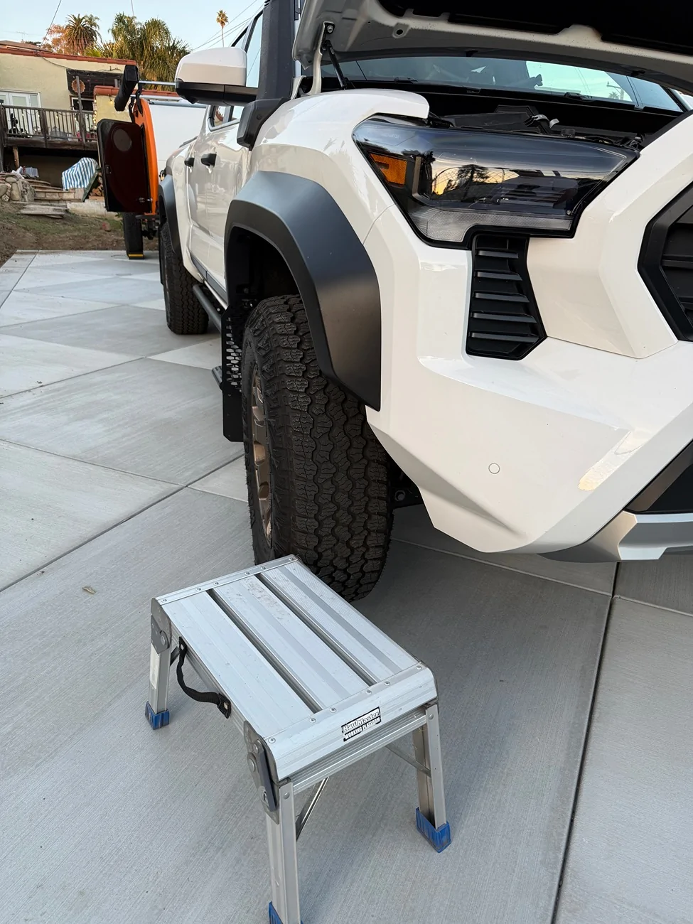

It’s the 4th clip that’s a mutha — the one hardest to reach in the tight spot near the bottom of the box. Clipping it first is the way to go. Had to pull it since a human hand butt can’t fit, lol. Might need to press the lid on either side before clipping it in.
The system won’t let me upload a video of the successful easy closure…but here’s a pic of the step used for leverage. If you want the video, be glad to shoot it to you, just DM me your phone number.

Haha, yeah I did the same exact thing. I got a step, got my hand underneath, and clipped it from the side. It clipped right on.
