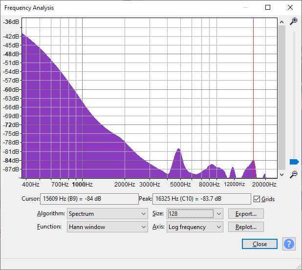

Sorry for the delay. I have uploaded a clip of the sound (in a zip folder because apparently you cannot upload audio files).
The high pitch whistle is very faint and starts about 1.5s into the clip. If you do an FFT on the sound file (I used Audacity), you can see a spike at~4800Hz and a few much higher (~8kHz, 12kHz, and 16kHz). I suspect the high pitch noise is probably the8+kHz sounds. After using a real-time FFT app Spectroid, the 4.8kHz spike is the prominent frequency of the high pitch whine in the cabin.
2024 Tacoma Trailhunter Hybrid high pitched noise unnamed
Some things to note about the high pitch sound:
  • It does not go away at higher speeds (I've heard going 65+mph)
  • If you are on the brakes at a stop it will sometimes stop, but if you release any pressure from the brake pedal it will come back
  • It is very faint and seems to come from the front passenger side (also where the hybrid inverter is)
Today at lunch I will go and get a recording of the pedestrian alert tone.
EDIT: Crossed off a section and added correction sentence afterwards.

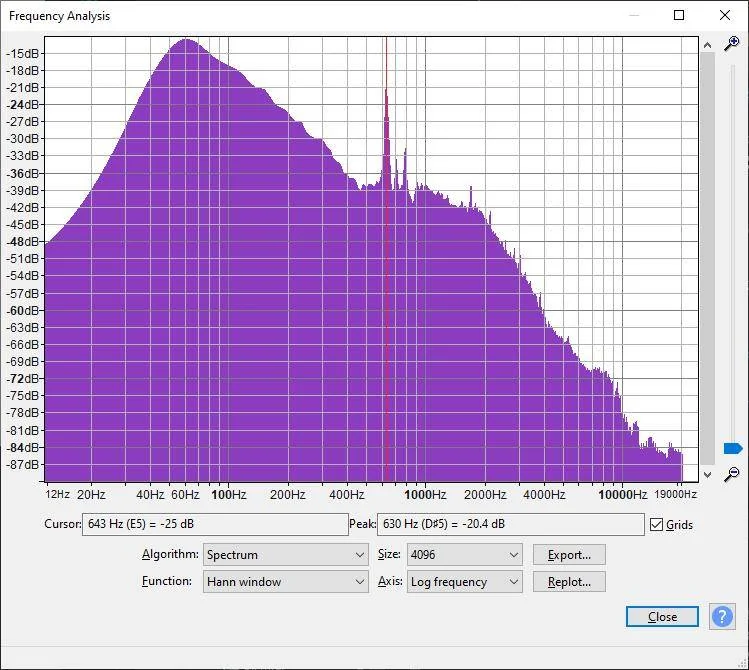

Full audio file uploaded in zip folder. For this clip, I put my phone on the hood of truck, got in (door close sound), put in gear (parking break noise), you can hear the pulsating whir that is the pedestrian noise as I idled around parking lot getting up to ~10mph, stopped and took phone off of hood. For this reason the FFT in the image below is from 10sec to 15sec.
You will notice how there are peaks at 630Hz, 700Hz, and 785Hz. I suspect this is the whirring pedestrian noise in the comments above. Also notice the noise at 4.8kHz is missing from the audio track (even though I could clearly hear in the cabin).
2024 Tacoma Trailhunter Hybrid high pitched noise 1732300497135-po
Anyway, let me know if there are questions or if you hear the noise now that you know what to listen for!
