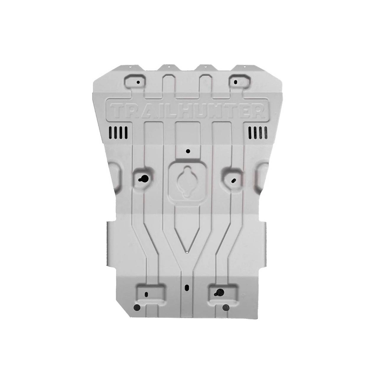

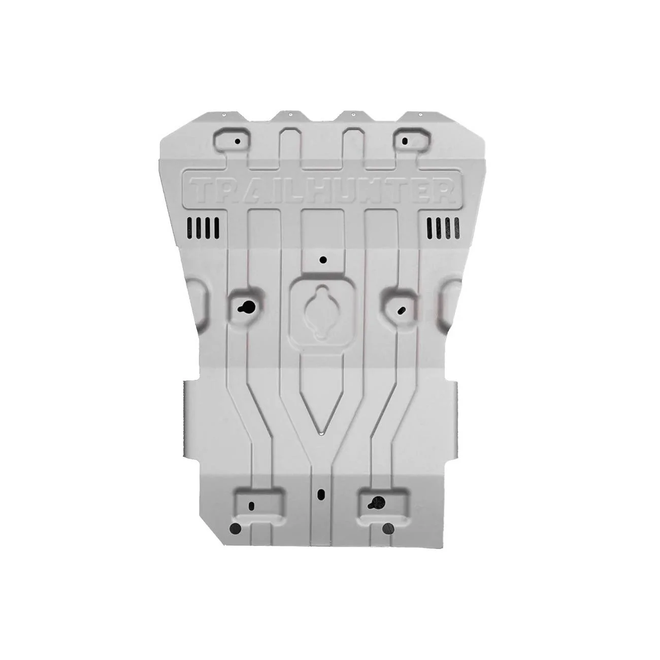

great question. following. Probably need to remove the entire plate for the oil filter too?
Yota's garage is claiming installing the TH skid plate can be done in under 30 minutes. I'd say it'll take longer than 90 seconds to remove those bolts! But not 25 minutes either! There's an indentation centered on this plate where you can jack the truck up. Need a floor jack or 2 sets of hands to lower it/re-install it IMO. Doesn't look too heavy in the video. A good time to clean it off or store for the winter.
2024 Tacoma Trailhunter oil change without removing skid plate? Trailhunter_Skid_Plate

@Independence Overland pointed out in his video at 17:55 that they made the removal and installation of the plate a little easier by allowing the plate to hang off a front and rear bolt. Still not a easy to remove hatch like I had on my Raptors, but still helpful.

With the TH skid, its not worth trying to change oil without removing skid plate. The bolt holes that allow the skid to hang make it easier. Very quick to do without lifting truck but i like to lift it for easier access.
