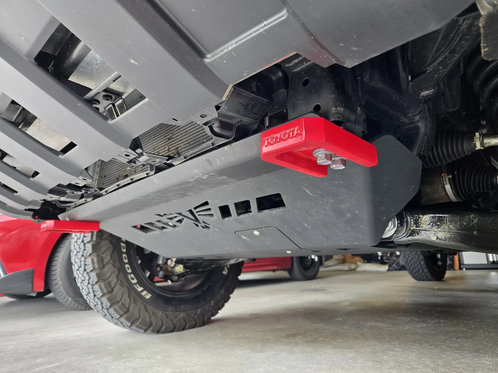

Victory skid has a notch cut out for oil drainplug access and the front door for oil filter access.
And the dealership mechanics have no issues or problems with this skid plate, no need to remove the whole thing.
