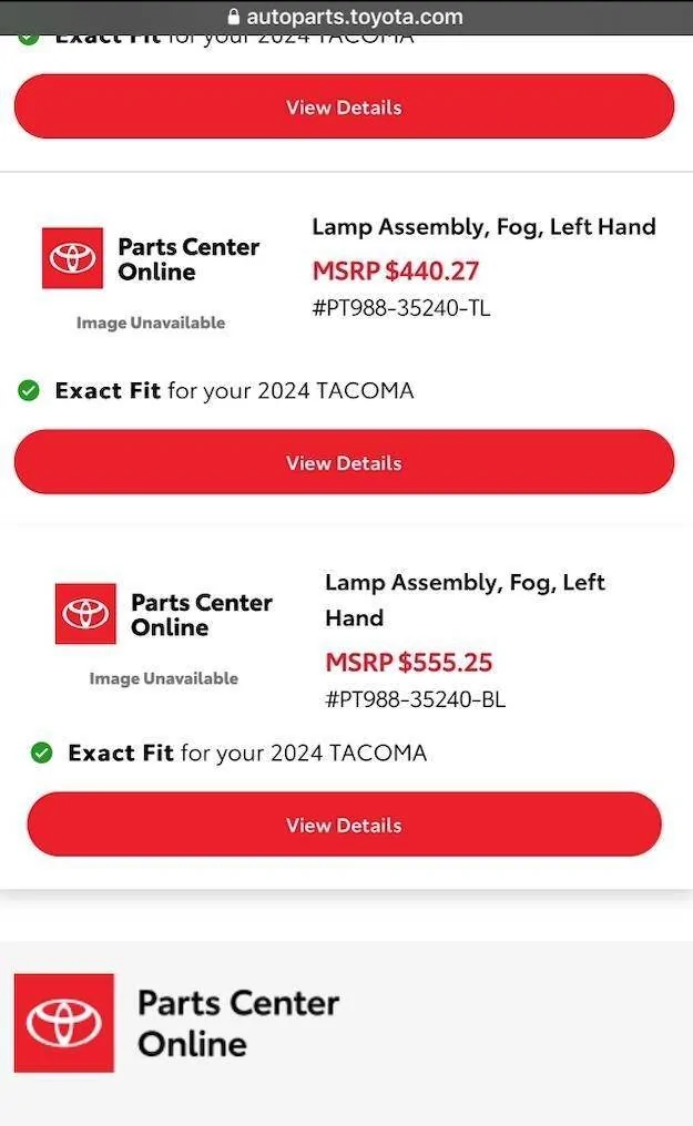

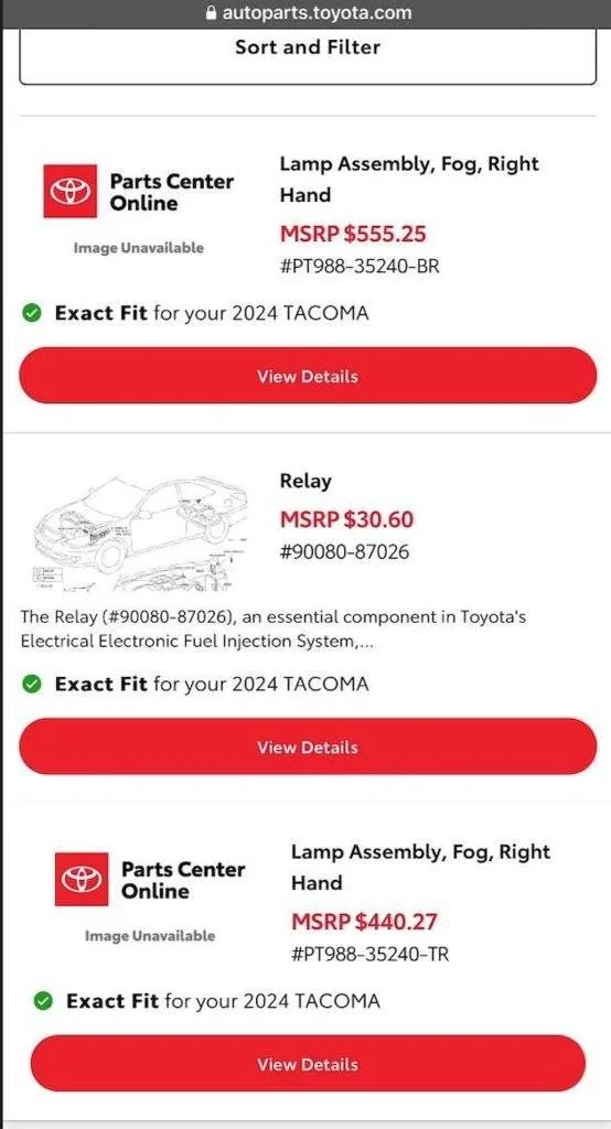

So here's a small bump for the thread, I was in the parts department at my dealer and asked for the part # for the fog lights in the TH. They gave 81220-YY030 left hand, and 81210-YY030 right hand.
Now here's where things get interesting.
Thanks to @TacoFish, they had two options for foglights when looking at the app, part #'s were pt988-35240-br and pt988-35240-TR
So with that info we are left with a 50/50 chance guess and who knows what the BR and TR stand for, could order both but cannot test the switchback function without the proper wiring and removing the front.

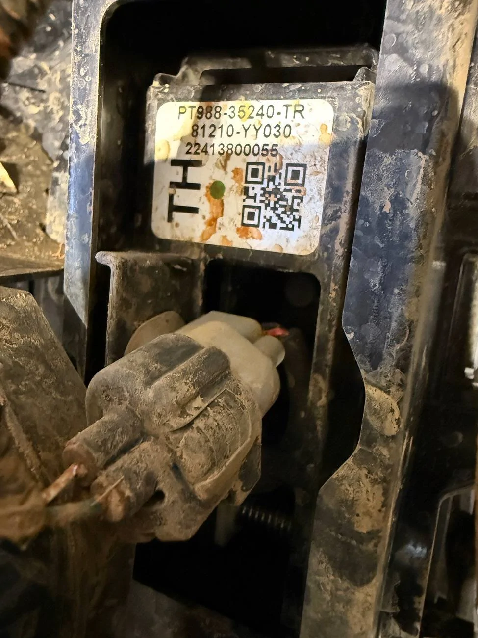

Here's the answer to the question about the Rigid part numbers. I put a covert bumper on my Trailhunter this past Saturday. TL is left front, TR is right front. I've been out on trails, that's why so much dirt.
2024 Tacoma Trailhunter Switchback Fog Lights Part# IMG_5120
2024 Tacoma Trailhunter Switchback Fog Lights Part# IMG_5121
Thank you so much for providing this info, this helps a lot. one step closer to possibly retrofitting these.

After having my trd pro front bumper off and see all the same connectors and wires being ran to the white only rigid foglights, while they are different part numbers; It would make me think they are pre wired for the dual color Toyota set.
The factory button and the TH fogs should be a simple plug and play and work.
the alpharex fogs at the moment are not compatible with the TRD Pro .

Does anyone know if you can just replace the lights and plug in the the switch? Or is there an entire wiring harness you need to buy also?
Drunkmonkey
Oct 31, 2023
67
Soflo
2024 Tacoma TRD Pro
You can just replace the lights and the switch. I did on my trd pro everything works 2026 trd pro
