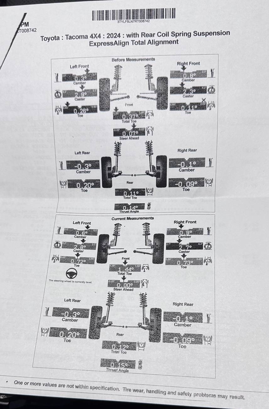

Update: Brought the Trail Hunter in today. They pulled a TRD Pro out for front to front view. The Trail Hunter clearly has substantial more camber. Politely requested they open a case with Toyota on the issue. At the rate of camber edge wear, doubtful these will last another 2000-3000 miles. Just to be sure, I will contact Toyota as well. Appointment is June 2 with the area service manager

Not good for you, but good for us that another TH is being addressed like mine was. We all think they got the geometry wrong and they’re still trying to figure it out. please keep us posted as I will also.
2,384
3,080
If the camber is not correct on a TH's front wheels, why can't it just be adjusted to be in spec?
My sr5 is the same way, you can clearly see how much positive camber it has, wheels slightly off enter but it tracks straight down the road

If it can't be adjusted to be in spec then it was built wrong and Toyota needs to step up and fix it IMO.
yup! now you see why were on that path of thinking, (but it's not going to happen overnight just like the leaf springs or heated seats) Mine has been at the dealership twice and corporate was involved both times, the 2nd time, they took my truck.

Just opened a case on the alignment issue. The concern is the dealers state they are aligning to specification. The issue is the camber specification has too much + Camber. A few minutes digging and it appear camber should be around +.3. This whole situation is exactly what happened with the Tundra alignment issue

The Dealers will not go outside of posted alignment due to warranty and liability
And I can understand why they wouldn't. so far, Toyota corporate has replaced 2 of my tires because of this issue....

Well turns out my 2025 has an issue that can't be resolved...
The problem is the thrust angle which is the direction the rear axle is pointing its +0.24 it should be 0.0
The trucks pulls to the right "slightly" where others cars that I own would not....
Do you guys happen to know a fix? dealer is no help and apparently the rear axle is not adjustable...
Any advice?
Thanks
JC
For what it's worth, My 2024 Pro rear thrust is -.11

What was your positive camber set at to go trough tires?
This was the numbers the first time they did an alignment after talking to Toyota, techs because the numbers that were coming up connected to my Vin would have been way off according to their senior tech at the dealership so they came up with these numbers and those are the ones that annihilated my tires in 3000 miles.
