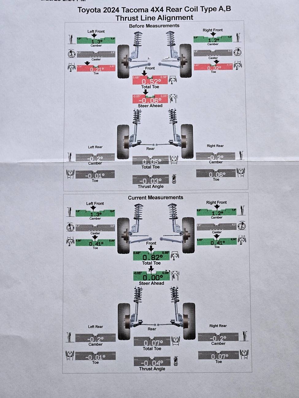

How mine came from factory, and what it was able to be corrected to. I don't know about other shops, but this is a standard report from Goodyear tire shops.

Your thrust angle is similar to mine... I wonder why and if it can be adjusted by some obscure way lol.
Does yours pull to the right?

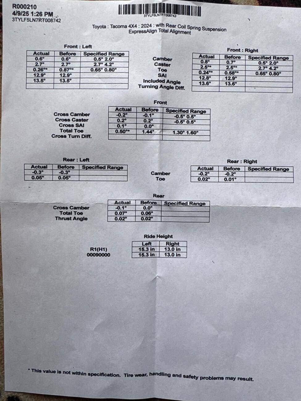

This is the numbers they ended up with on mine from Toyota, corporate after they got involved.

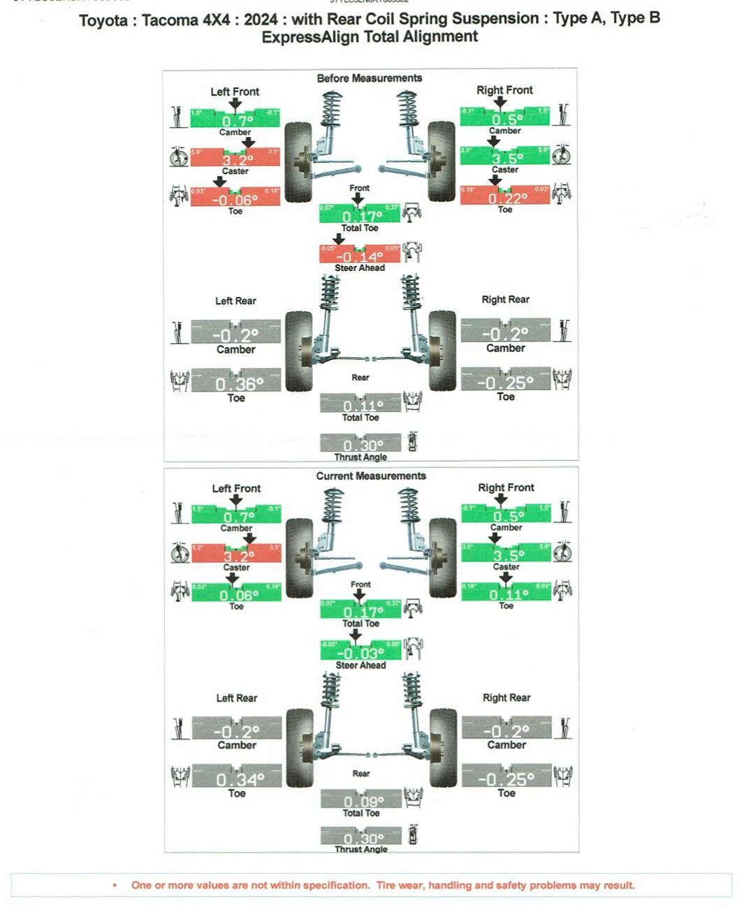

This is true. I originally went to get my alignment checked at my local Toyota dealer after I told them it visually has positive camber [I'll be honest, I didn't notice it when I first got the truck as I was too excited]. I know trucks may have some slight positive camber, but I feel like the Pro's have too much of it....but I'm not an automotive engineer, so what do I know.
Anyway, they said that the camber was within spec for the Pro [supposed to have some positive camber], but the toe was out of spec, so they took care of that under warranty. Below is my alignment sheet.
My truck does ever so slightly pull to the right, but I really do mean ever so slightly in a very micro way.
