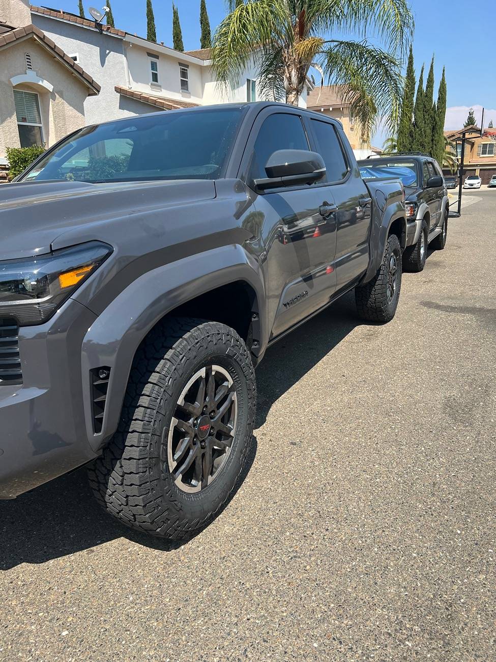

Hi, I have a 2024 Trd Sport. I replaced the factory 265/65/r18 with 275/70/r18. Fit perfectly, no rubbing, no lift. In fact there’s enough space I think 285/70/r18 would fit as well with no issue.
WHAT IS YOUR OFF SET? IM LOOKING TO UP SIZE TO 285/70/R18

I am running the factory rim only changed the tires. So the offset is whatever it is factory. I did some research and found +56 is the offset but I’m not sure if that’s true. I will say my wheels don’t poke outside of the fenders, 285 apparently match up perfectly with the fender flares. I opted for 275s instead of 285 so I wouldn’t kill my MPG. I got about 21mpg stock. I get about 18mpg now with the new tires and air dam removed.
Looks good. I’m thinking about doing the same. Can you share more pics?

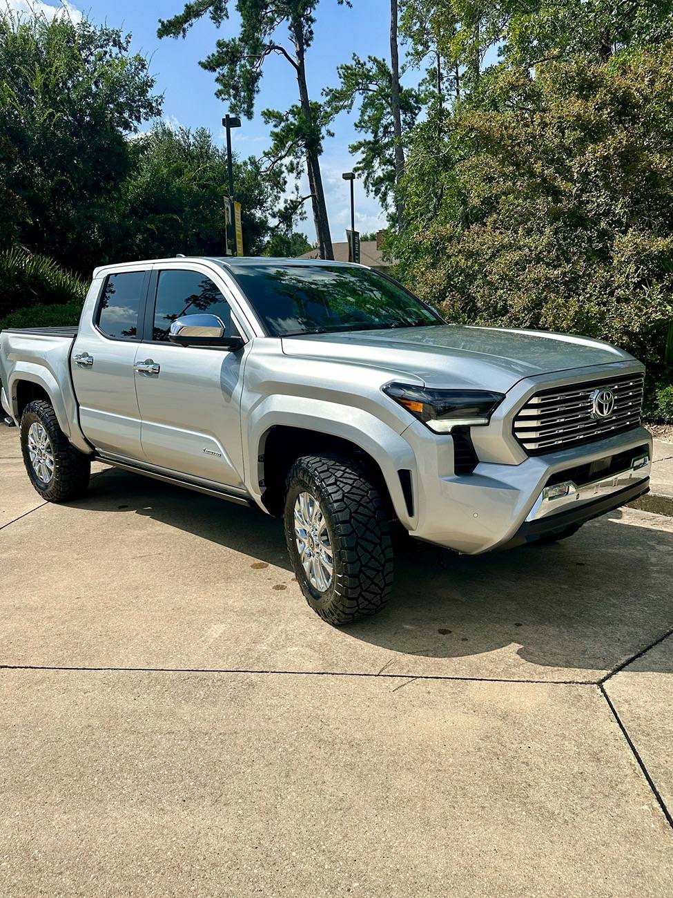

I did the same, Nitto Ridge Grappler 275/70/18 on my Tacoma Limited. Removed valance and mud flaps too. The tires are 10ply and pretty heavy, you can see it in the MPG. I”m still getting use to the drive modes and feel of the truck. Only driven a few hundered miles, mostly city miles. Im having trouble getting use to seeing 14-16MPG average! They look good though! My 2020 Limited had same tires but a bit smaller 265/65/18 and didn’t notice the difference.
hi, new here. this is exactly the truck i just put a deposit on today and exactly the tires i plan to put on it. this looks awesome - do you have any more pics, like maybe a side profile?
Are these Falken Wildpeak AT4? I can't quite make out the AT part. How are they as far as performance/noise/mpg drop? Just got a sport and looking at getting these!
