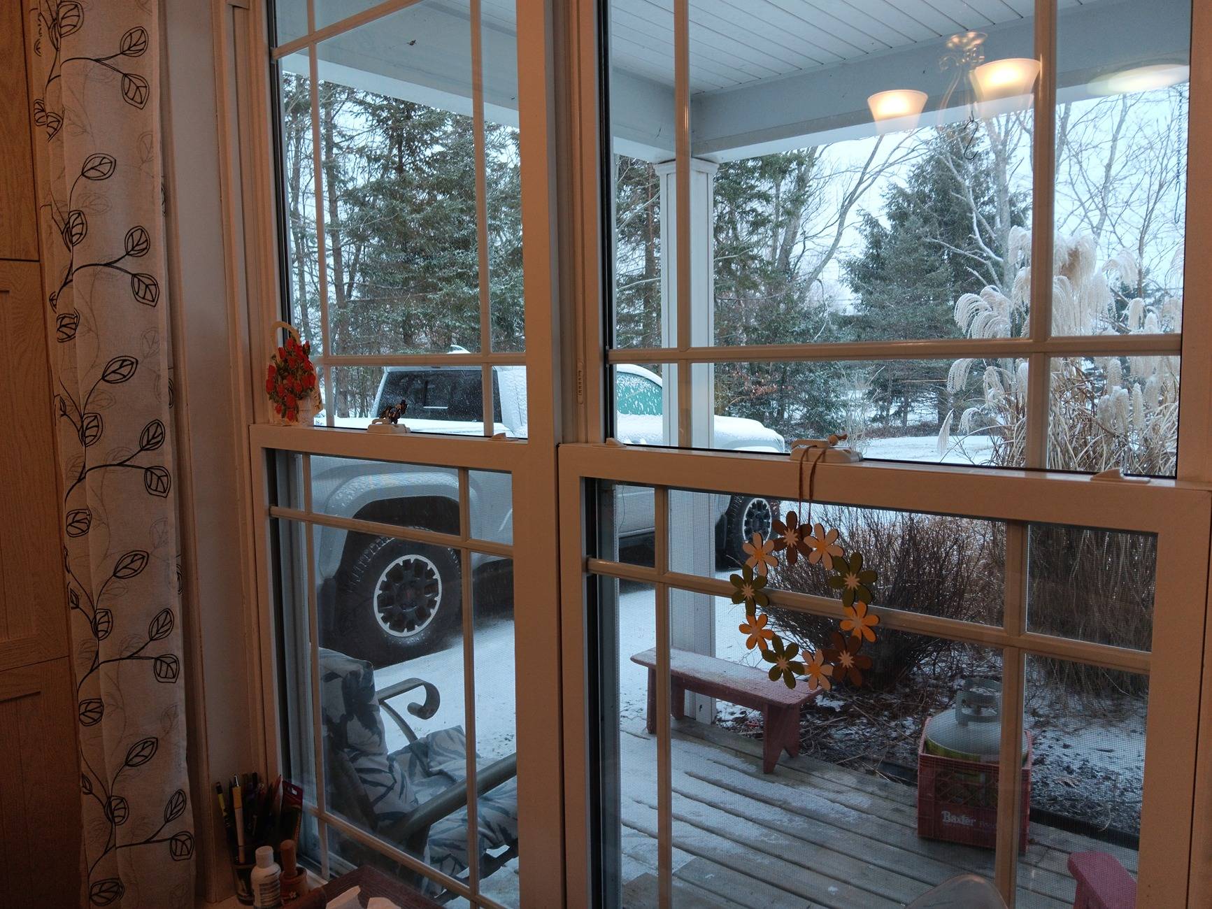

I agree,the range is very weak. But it's just enough for me.
