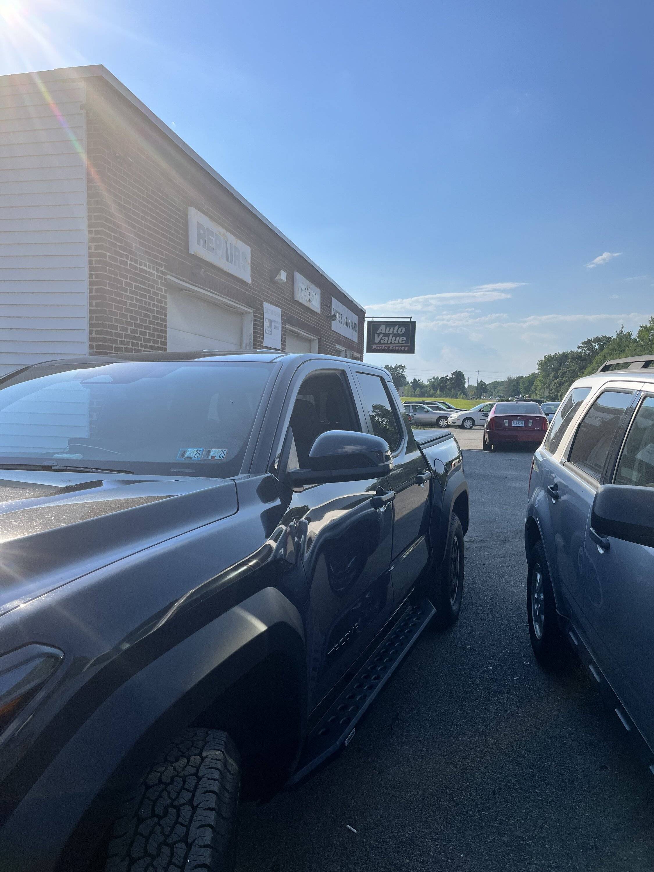

5 hours away from home, stuck outside Richmond VA. Truck making awful rattling noise on the highway. Pulled off and somehow pulled right up to a service station
They threw it on the lift they said the rear end is smoking hot and there is play in the driveshaft/ujoint. (Edit: the prior statement was not proven to be an issue according to Toyota everything is normal)
AMA I guess as I am now waiting 2 hours for Toyota to tow me. Oh and this is the start of my vacation which is looking like is ruined.

result of a 5 hour drive mostly highway, No I wasn’t in 4 hi, no way the locker was on accident. Pulled into a service shop the guy threw it on the lift said the rear end was smoking hot like it lost the bearing or a shim who knows. There was grease in it. He opened it and some poured out.

I removed the picture it had my plate in it. But it is on the tow truck.
