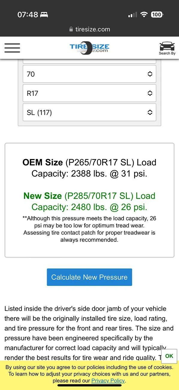

You can plug in your information here to get the recommended pressure: https://tiresize.com/pressure-calculator/
That comes up with 26psi, but 26 feels a little low to me. Other people do the chalk test and have also determined the correct psi to be a little lower than 30. I feel good at 30 so that's what I run.
If you like 35, then run 35. As for me, I like 30.
