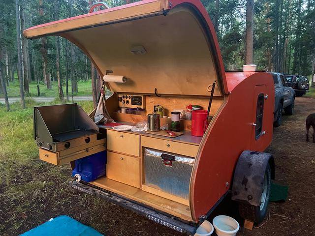

Title. Let's see the kitchen setup w/the big daddy inverter cooking up dinner!
Especially exited for wintertime stealth camping /generator mode / seeing what a propane-less setup will look like here-forward...
My TH delivers in September/ camper in October...
