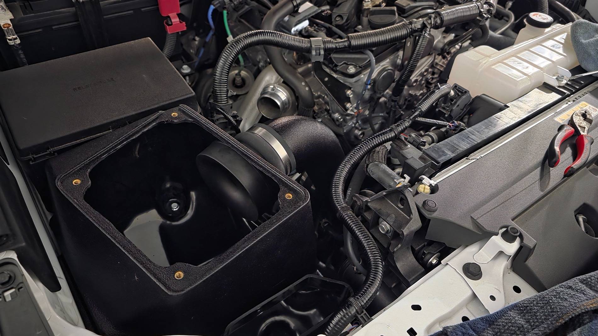

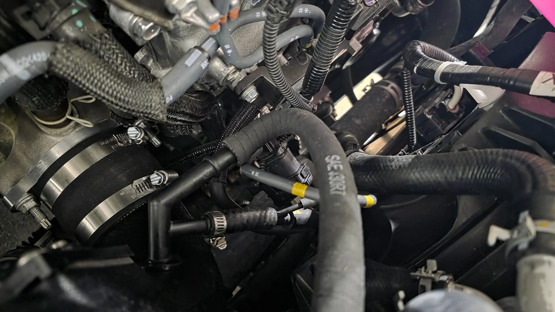

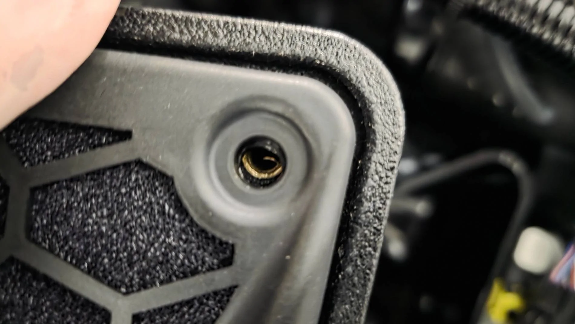

Installed this intake with high hopes of a clean and easy install. K&N does a great shop in r&d and fitment always seems on point. However, this wasn't entirely thr case with this new intake..I chose it over others for the full inlet replacement. Where those vacuum hoses all tie together is a mess, and the provided hose too small i.d to fit on. Seems like a few small hose clamps should be used here and there but arent. It was also missing a bolt to hold the airbox down. The holes in the lid of the airbox dont align with the airbox itself and took some effort (one shown in first pic).

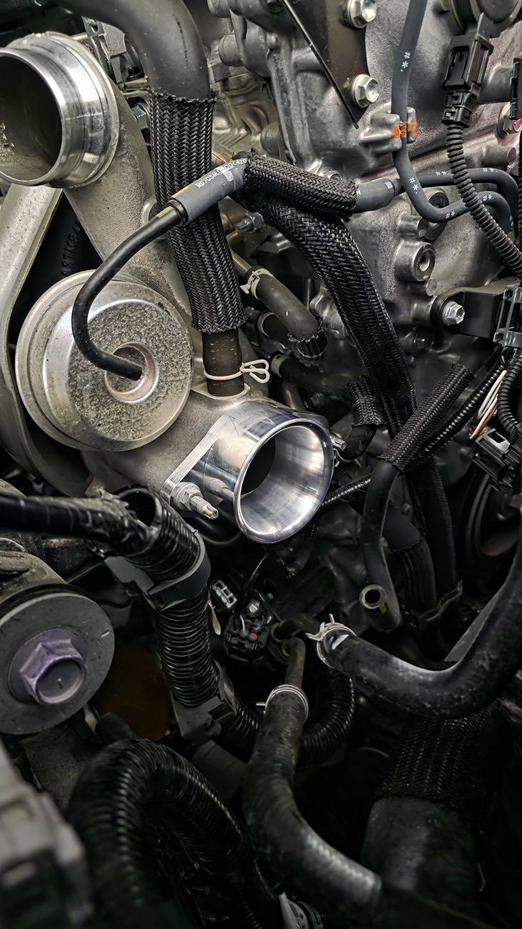

Once installed it looks very nice, turbo noise in much increased at initial spool up. I like the aluminum flange that ties the turbo to intake they added. I've attached a few images from the process. I'll be looking for ways to better finish the vacuum lines though, those appear like a complete after thought from K&N.
Any questions feel free to ask. Kit does come with b/w install instructions, the website has them in color. The MAF orientation can be confusing and the wire is a little tight once in place.

2 bolts were easy, the next to were off enough they were very difficult to get started.

Completed install, does look very nice IMO.

Mess of vacuum hoses.

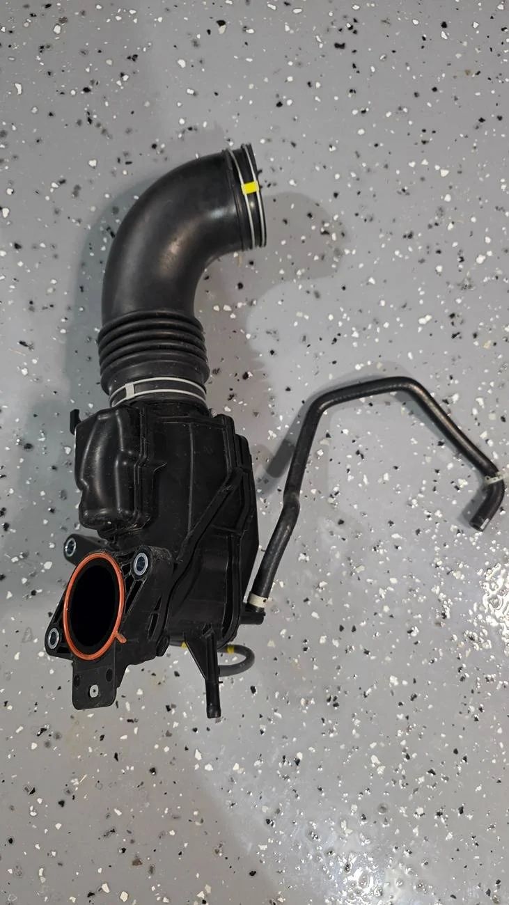

Factory turbo inlet silencer "manifold"

K&N turbo airhorn installed.
Part throttle initial boost is the most noisy, the "dose" from no bov is fun too.
