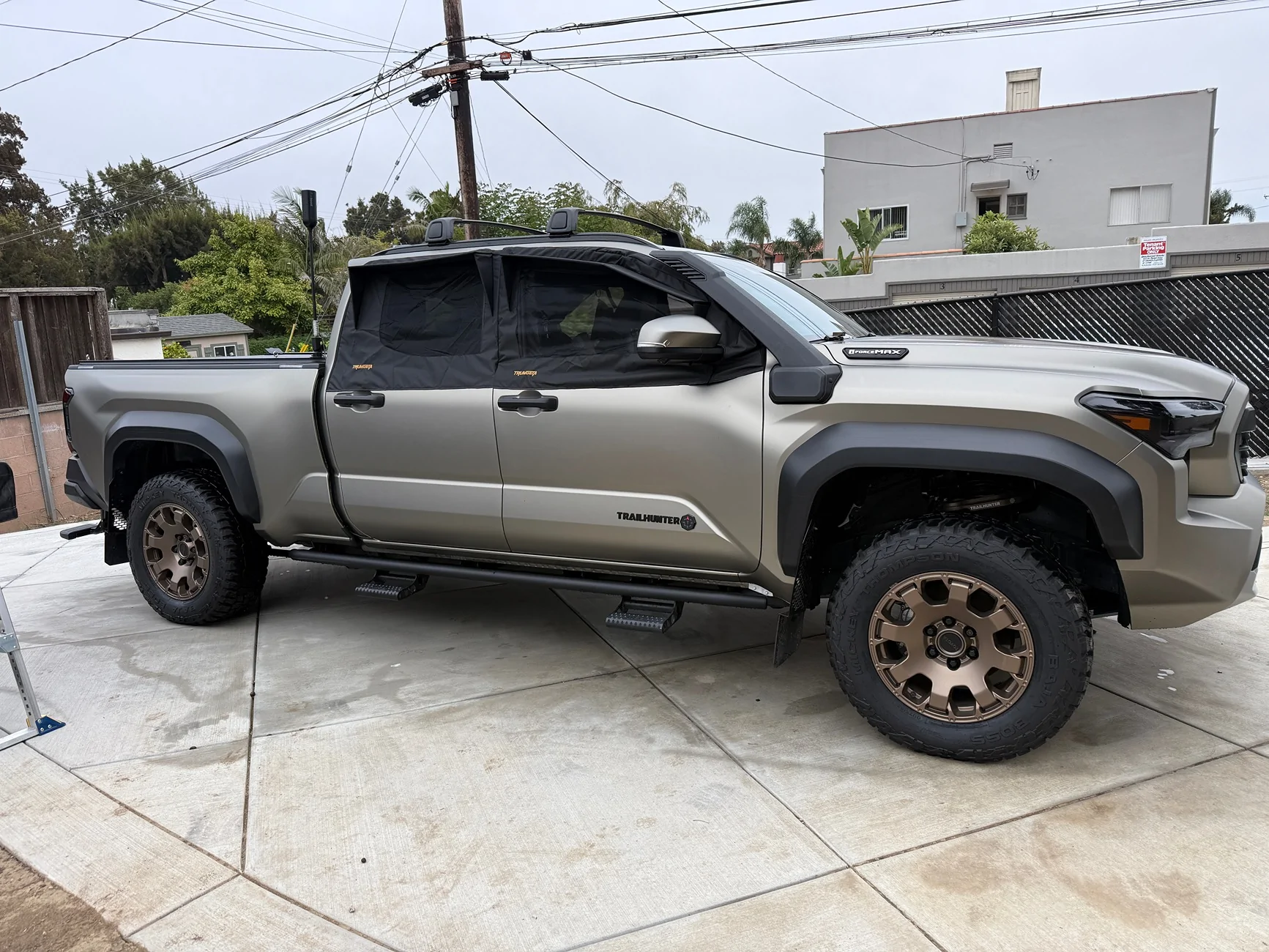

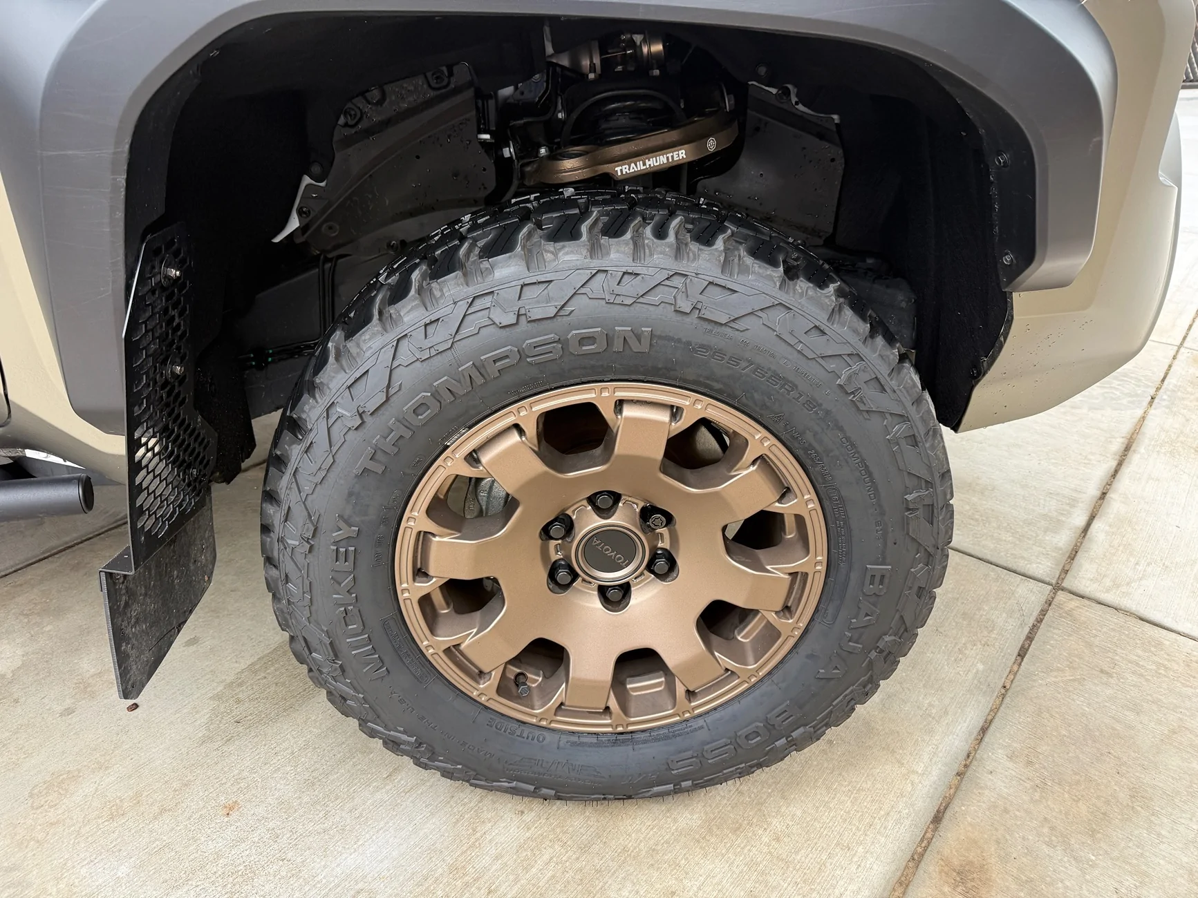

A few weeks ago I had my Trailhunter’s stock tires replaced with Mickey Thompson 265/65 18, XL load.

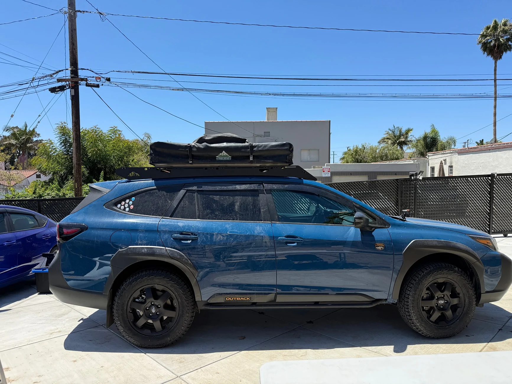

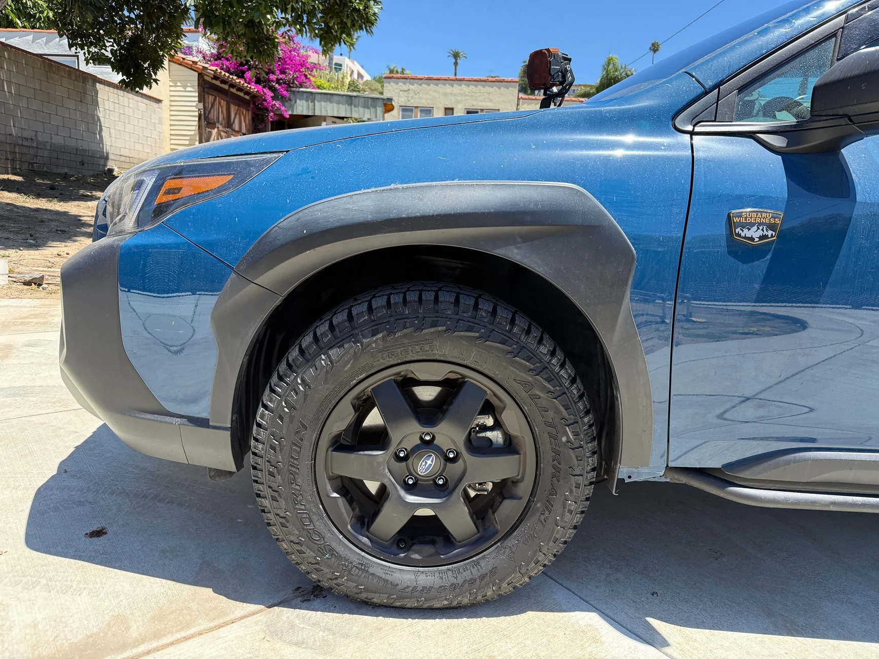

This morning I had new tires put on wife’s’24 Subaru Outback Wilderness. This is an adventure vehicle for lighter offroading and camping. She chose Pirelli Scorpion A/T+ in a size 20mm wider than stock. Handles great on road so far.
Take a look at both of those tires as part of your hunt. So many choices are out there. Good luck!
