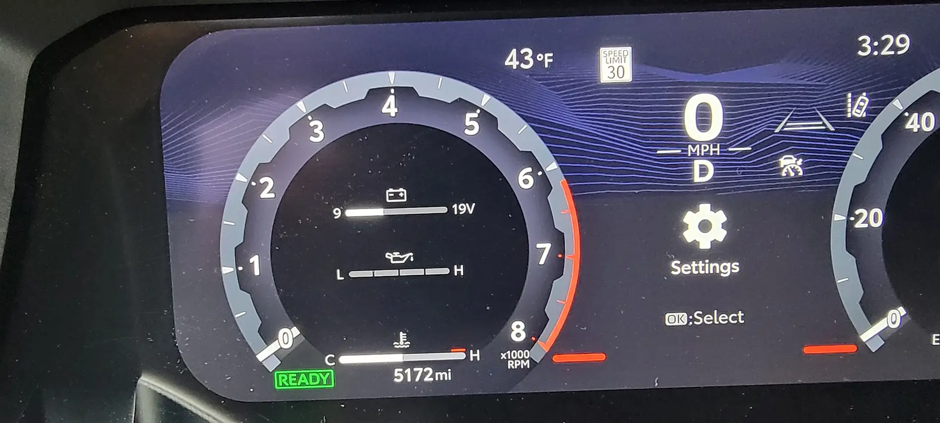

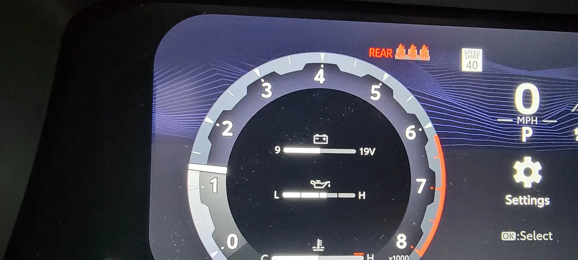

I have been watching my battery level since I had my battery replaced several weeks ago under warranty since it just died on me even though I have been driving my truck at least once weekly. Only had the truck for about 10months and dead battery.
Took some pics of the meter in the dash, on start up its been center (mid point of battery image). Seems to be about 14v. Then after a few min I see it dropping slightly and its just barely touching the battery image (not sure voltage? could be 12v?). Pics attached to show exactly what I am seeing. Not sure if this normal and I believe it is after reading this thread?
Checking with others on the forum?

@franx I would say after a few minutes of runtime it should not be dropping to that level on the gauge. It should only drop after extended run time and when there isn't much amp draw (no headlights on, minimal accessories, etc). If you have a battery health tester, try that and see what is says. You have to enter the CA's, and it will determine the state of health (%). They aren't that much money and are quite handy. Your battery could have a bad cell, and the sooner you know the easier it will be to get it swapped out under warranty.

MustardTiger thanks for the feedback. I did have the headlights on, the heater on, radio and maps running. When I started it up again later same thing happened, it was centered then after couple min dropped to where it was before. The current battery is a replacement that was swapped out just a few weeks ago under warranty so not sure if its a bad battery again?
