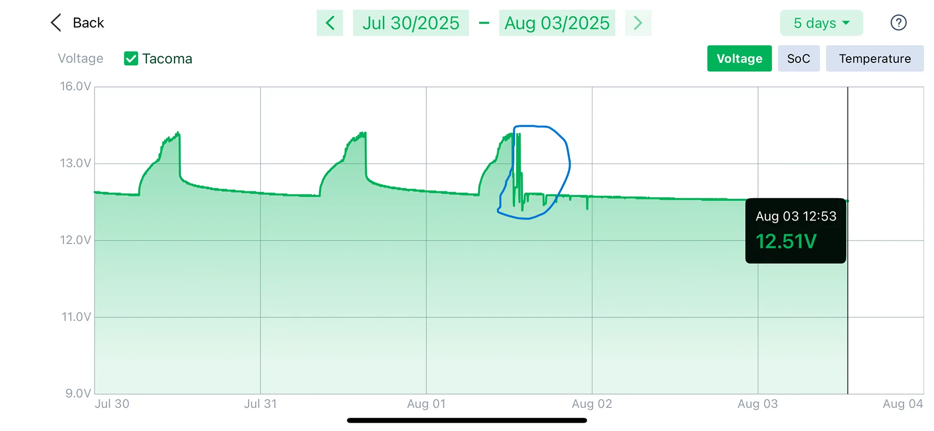

It's the original battery. I've circled the voltage of me driving.
Thanks, something in the charging system seems wonky If it’s sometimes applying 13.8v and other times not. Also seems like a lot of drawdown overnight - logout of the Toyota app to rule that out as a source.
Given that some like yourself have an issue, and other people don’t, it suggests a faulty component or something.
I’d push hard on the dealer to find what’s wrong. Hopefully you can get it sorted. If it were me and they gave a BS excuse, I’d start documenting what would be needed for a lemon law case.
I've got a laundry list for the dealer when I have the time to burn. The OBD2 port falls out because the dealer replaced it with an aftermarket tracker, back passenger tire leaks super slowly, no punctures. And an annoying rattle with the trim in front of the front doors as identified in this thread. Rest assured I'll keep them busy one way or another.:wink:

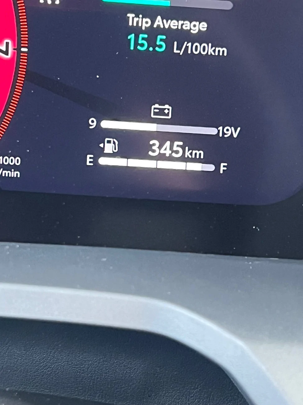

Has anyone notice a change in the behavior of their voltage gauge? I’m wondering if Toyota has issued an OTA update or something because mine is always at this level now…
before it was mostly always below the battery graphic
2,327
3,014
Sometimes mine is in the middle of that little battery, particularly when it first starts. But then it settles to left of the battery graphic and pretty much stays there.
I drove my truck a couple of hours this morning and now it is at 12.1 volts as usual. I have a service appointment in two weeks and I will see what the dealer has to say. My guess is they will say that this is normal for the hybrids, which could be true, but don't leave it parked for long or expect the battery to last a long time.

Edit:
Noticed an interesting thing while on a trip today. Was on a major highway doing 125km/hr-135km/hr. 12v Battery gauge read right in the middle of the gauge the whole time, which I hadn’t noticed before. Honestly, I haven’t looked at it in a while. When I went onto a secondary road and had to slow down the gauge dropped to where I usually see it to the left of the battery symbol. If I’d gun it to pass, it would jump to the middle of the gauge, slow down and back to the left. Does that seem normal?
