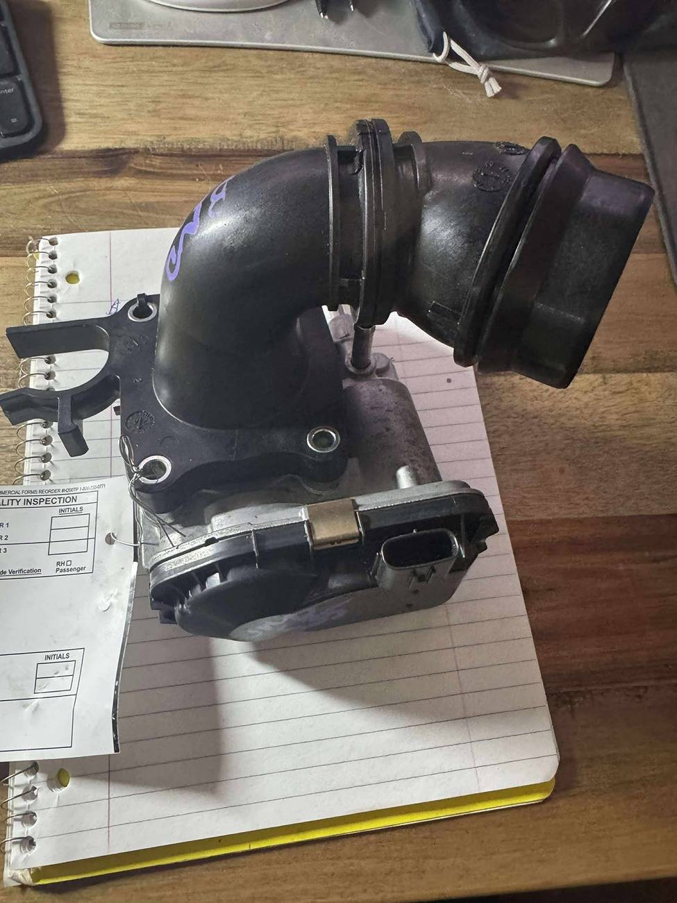

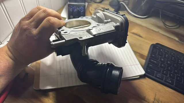

Thought I'd pass on a few measurements taken from a spare Throttle Body and Throttle Body Elbow off of the Tacoma (it's the same for other T24A-FTS platforms like the LC250/4Runner).
Located what I think might prove to be a choke point.. Enjoy!

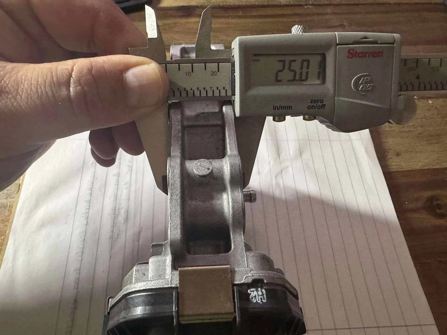

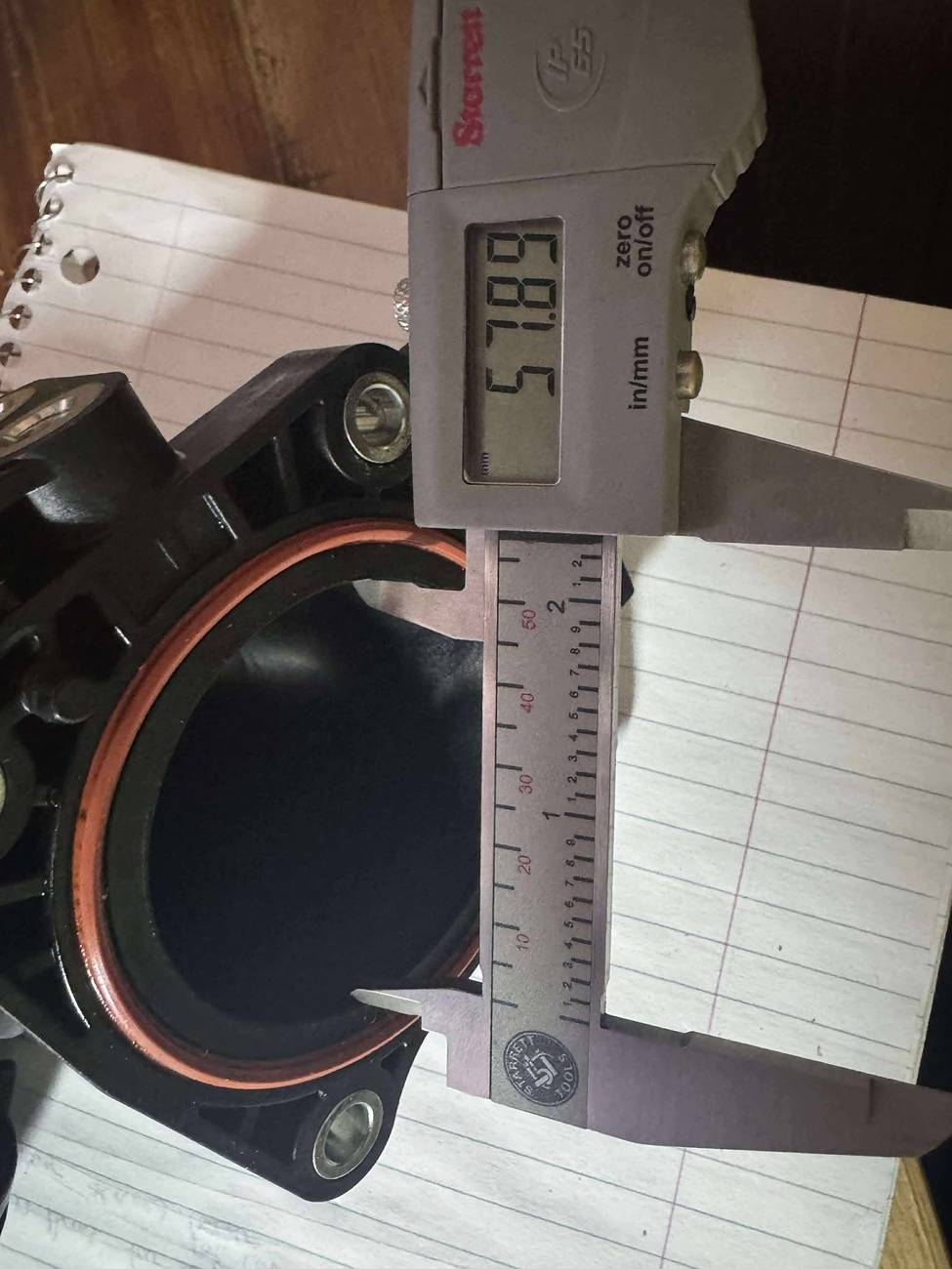

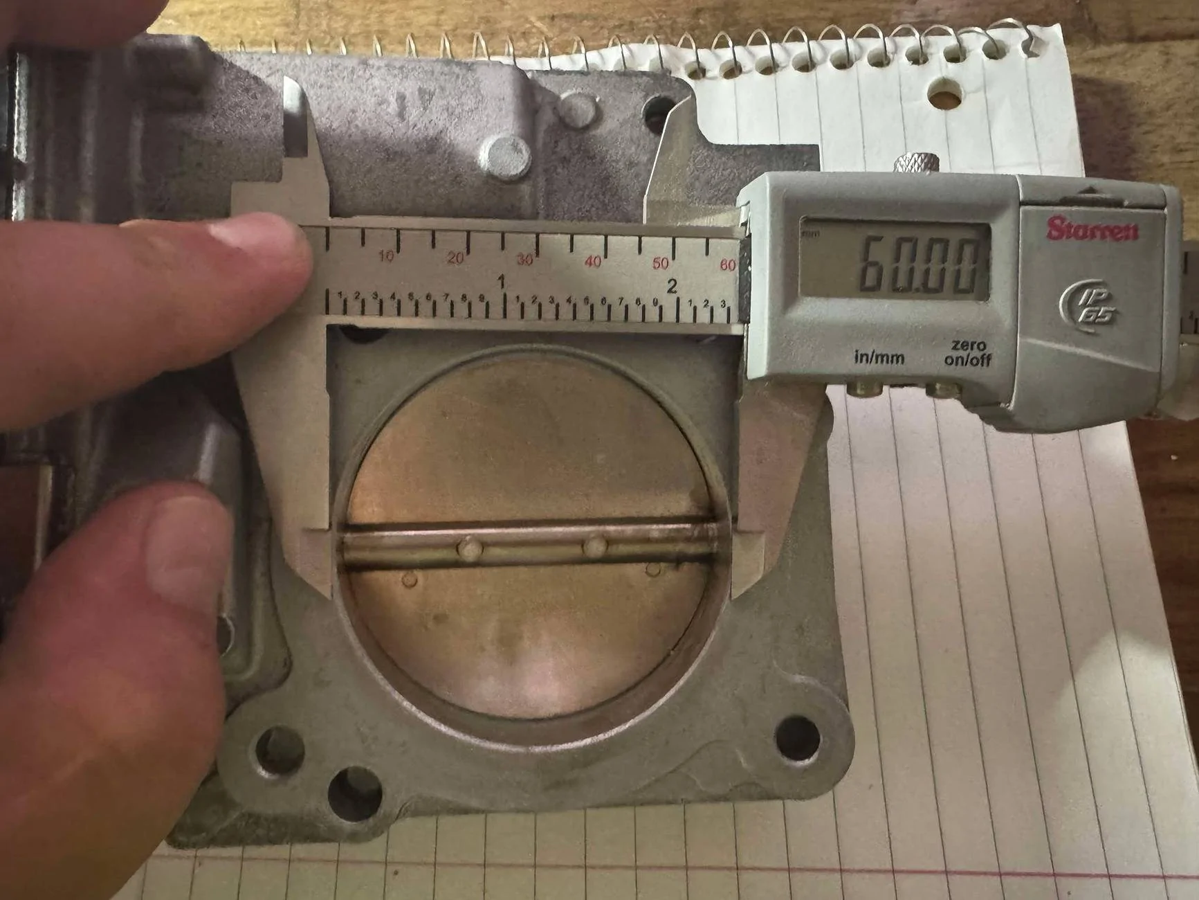

*My calipers aren't perfectly positioned here, but the ID of the TB is 60mm, which gives us a cross-sectional area of ~2827.4 square mm excluding the throttle plate/bar.

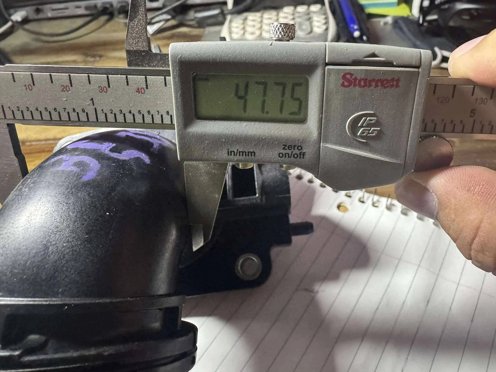

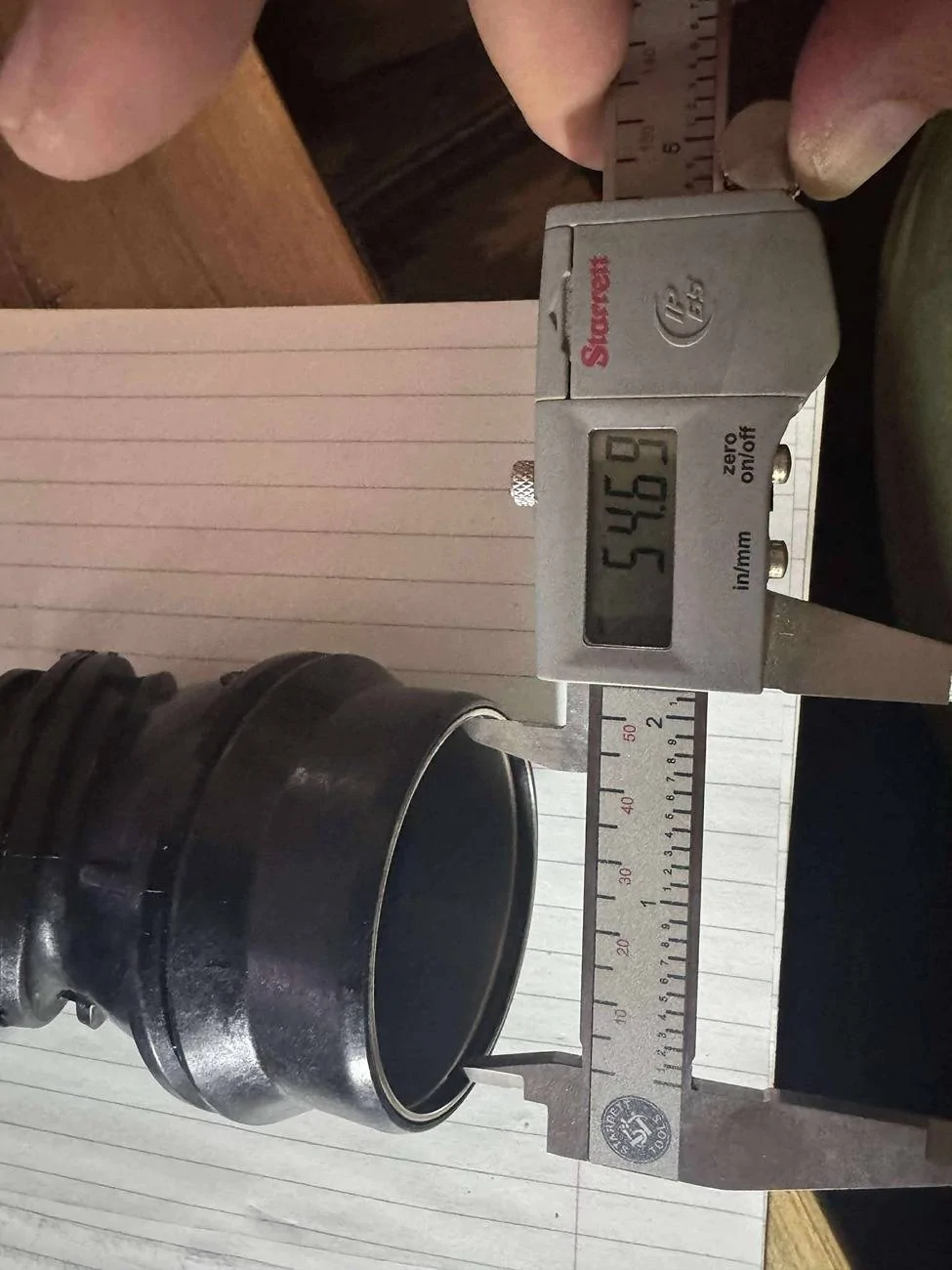

*Choke point located!

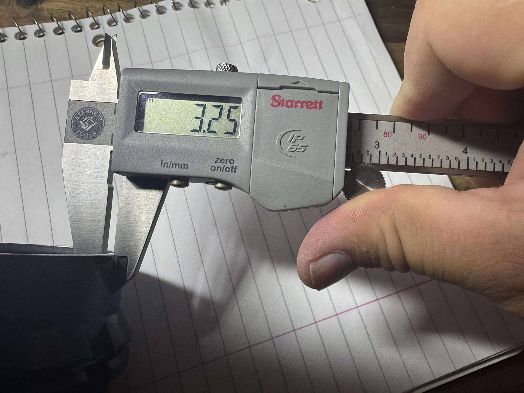

With an OD of ~47.75mm and a wall thickness of ~3.25mm, that is an approximate ID (at the radius) of about 41.25mm (~1336.5 square mm).

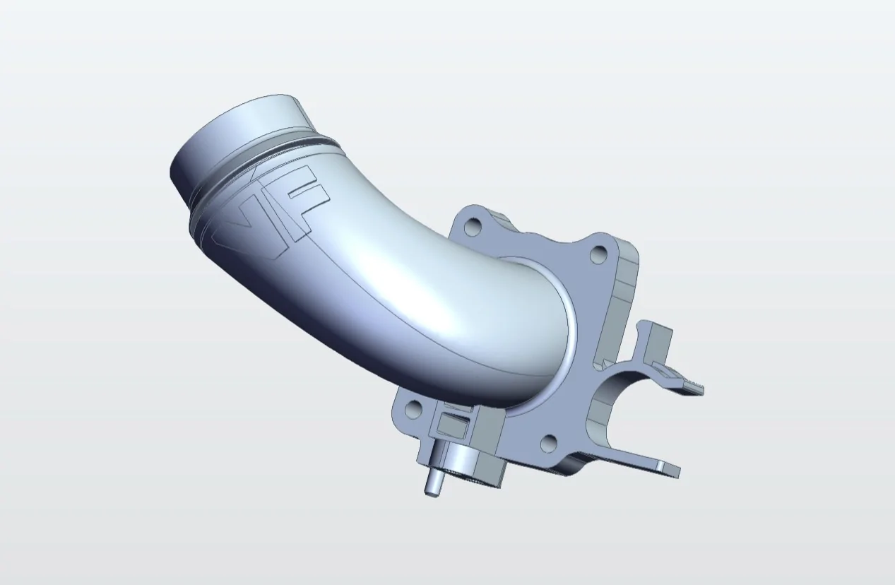

VF will be producing these.
"Coming soon...and available for pre-order this week.
Tacoma/4Runner/ Land Cruiser 2.4L Turbo CNC Throttle inlet pipe.
- Dramatically increases the Throttle inlet pipe diameter. No longer restricting down to 40mm.
- CNC Billet Aluminum
- Designed in the USA
- BOLT ON compatibility.
- Replaced the tiny, restrictive plastic one with a larger volume CNC Replacement.
Will provide:
- Dramatically less intake restriction
- More flow
- Better throttle response
and more
Pre-order for introductory pricing of $325!"
