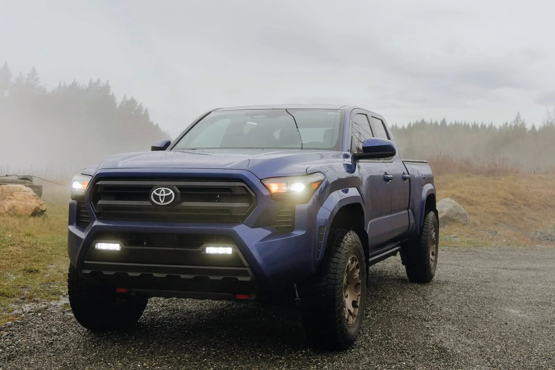

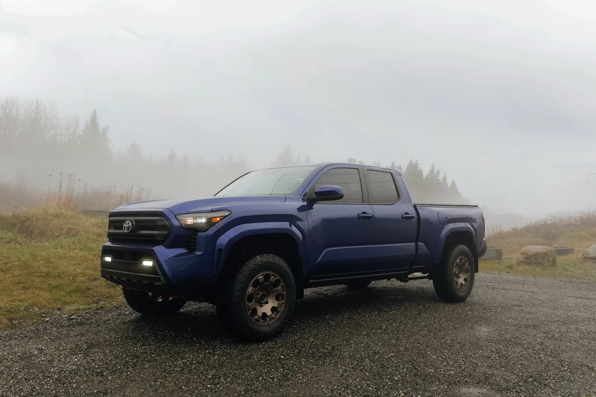

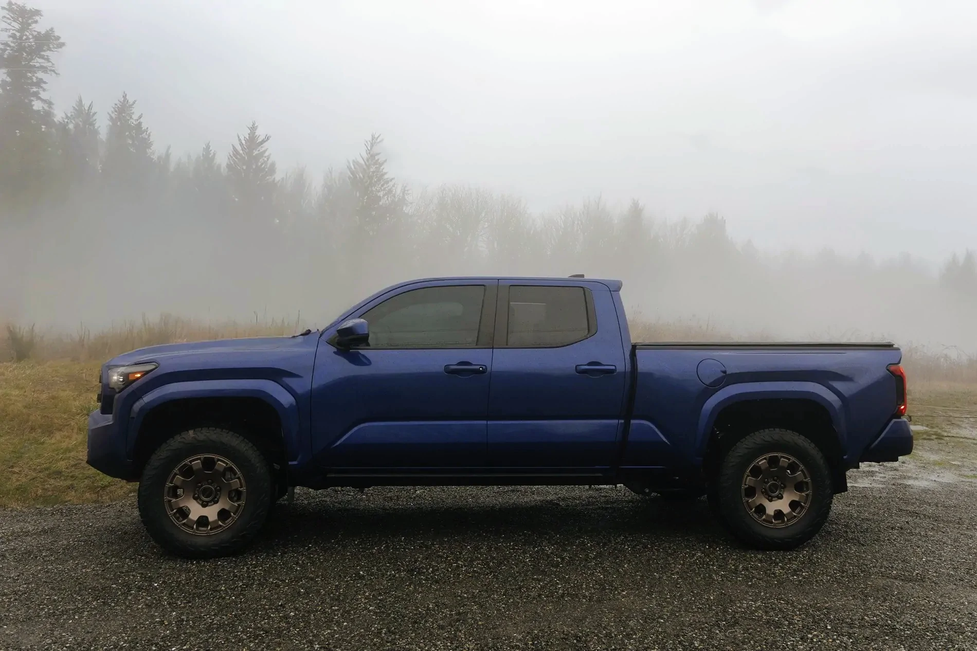

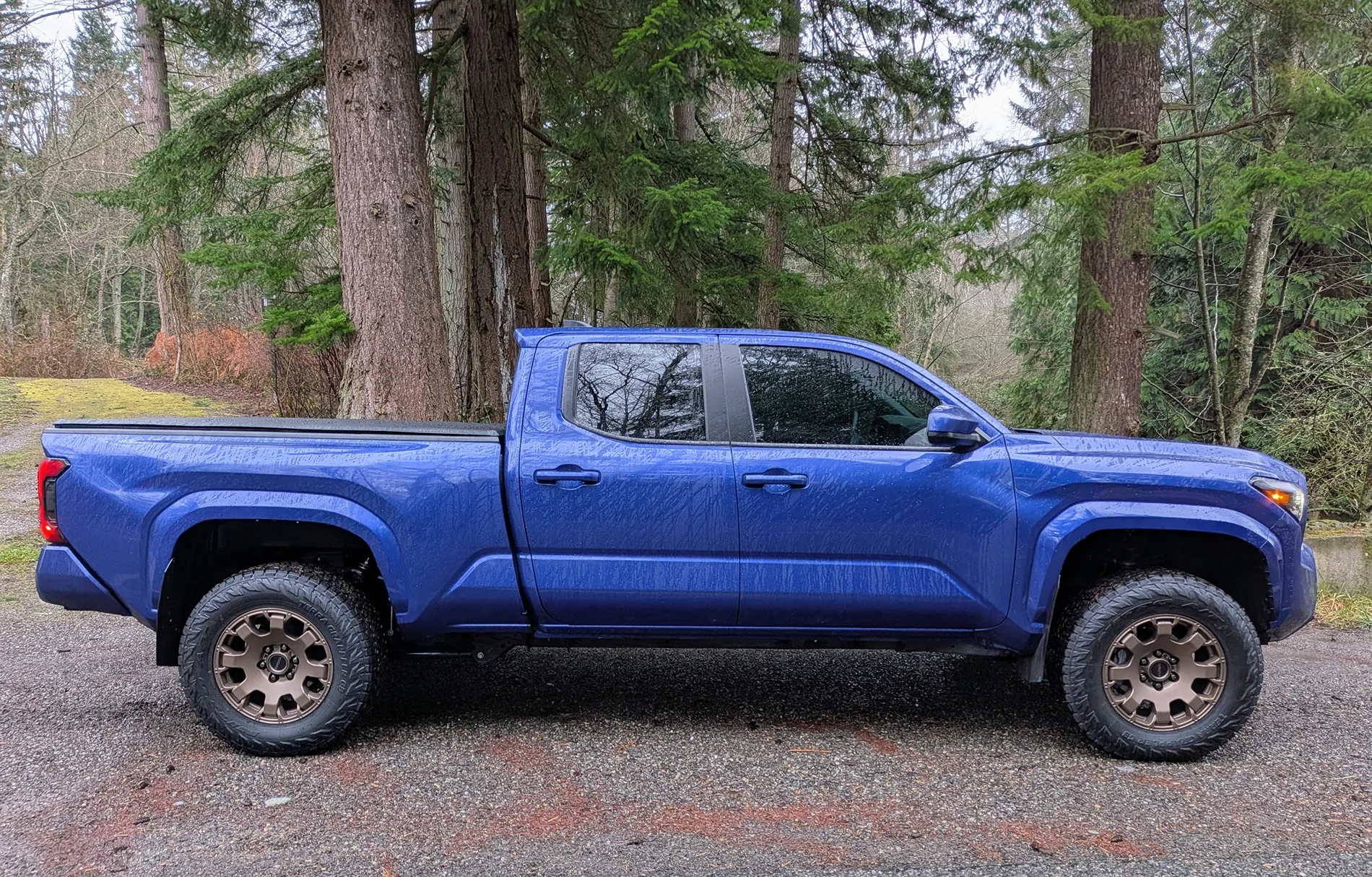

Here are a couple before and after shots. Will update the photos when I get out with a real camera.
Cheers!
Before:
2024 Tacoma Bilstein 5100s installed on a 2025 SR5 Tacoma PXL_20260127_001735187~4
2024 Tacoma Bilstein 5100s installed on a 2025 SR5 Tacoma 1283
After:
2024 Tacoma Bilstein 5100s installed on a 2025 SR5 Tacoma 1519
2024 Tacoma Bilstein 5100s installed on a 2025 SR5 Tacoma 43058-89123533a982316fb1b7e8850c00d4d8~3
2024 Tacoma Bilstein 5100s installed on a 2025 SR5 Tacoma 43062-ee6367049335766c773f98646e480a69~2
2024 Tacoma Bilstein 5100s installed on a 2025 SR5 Tacoma 43063-5d11b85035d9622b8b3b94ddc069c24f~2
2024 Tacoma Bilstein 5100s installed on a 2025 SR5 Tacoma 43064-7396739fa129f19db6c6d9705a95c5b9~2
