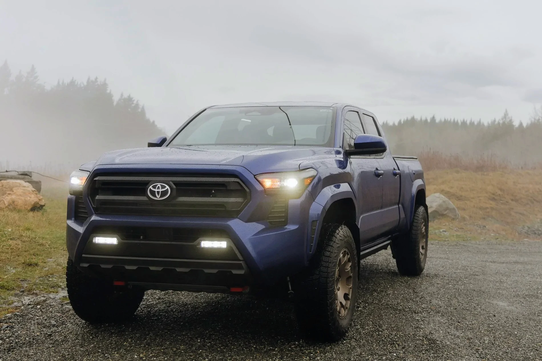

Heyyyyyyy it did its best. I have the Temu AI though haha
2024 Tacoma Bilstein 5100s installed on a 2025 SR5 Tacoma 1769897410227

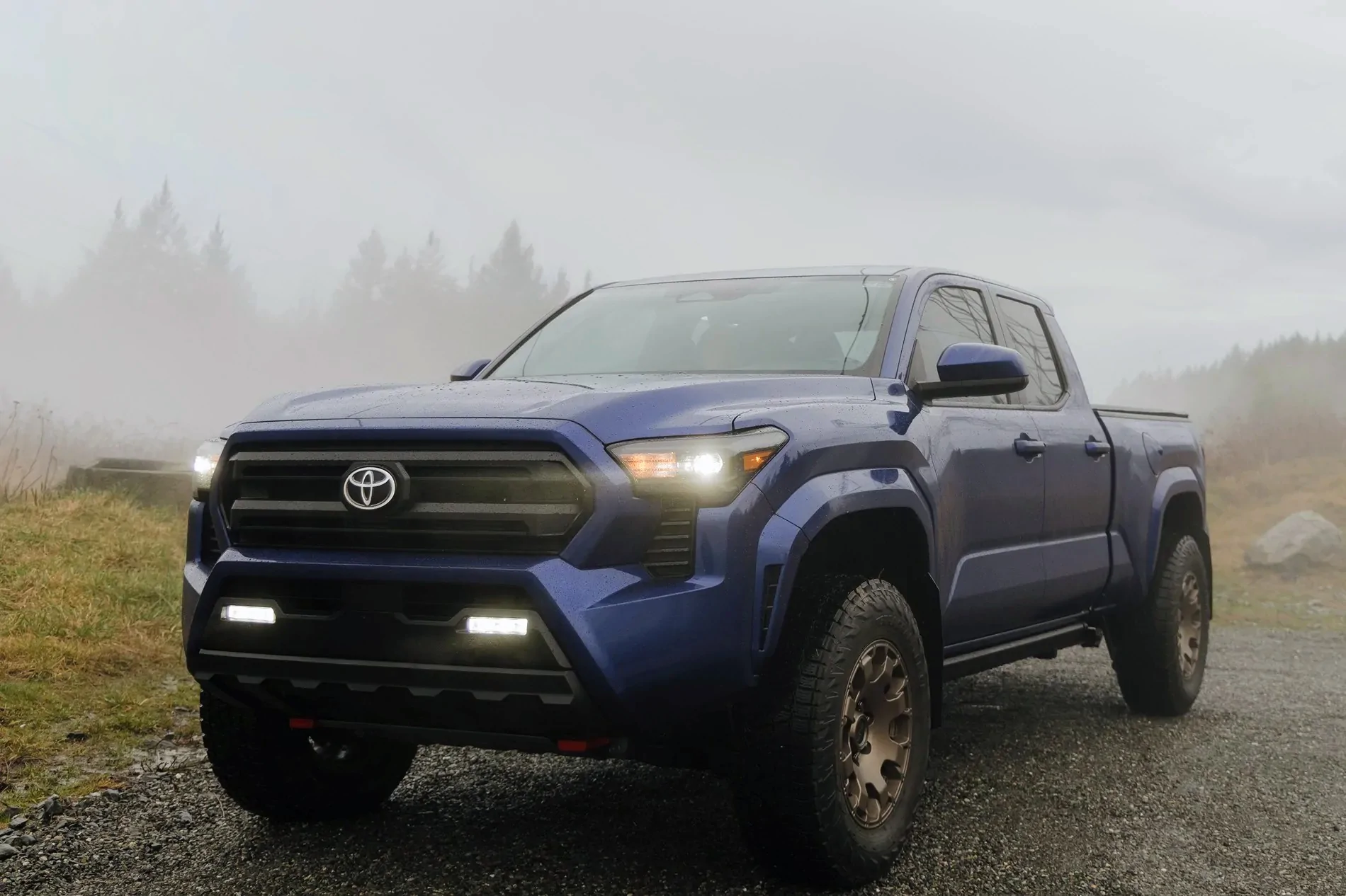

haha I haven’t really thought about the TH bronze wheels on underground but it actually looks decent - might consider those too. The blue/bronze is amazing though (vintage Subaru vibes). Those recent PNW foggy shots almost look pretty sweet.
Thanks dude ! I dig the blue/bronze too.
And yea, the foggy shots sure do look sweet, until you are stuck with the crippling depression that 6 months of foggy shots brings 😂

Updated photos
Truck looks great!

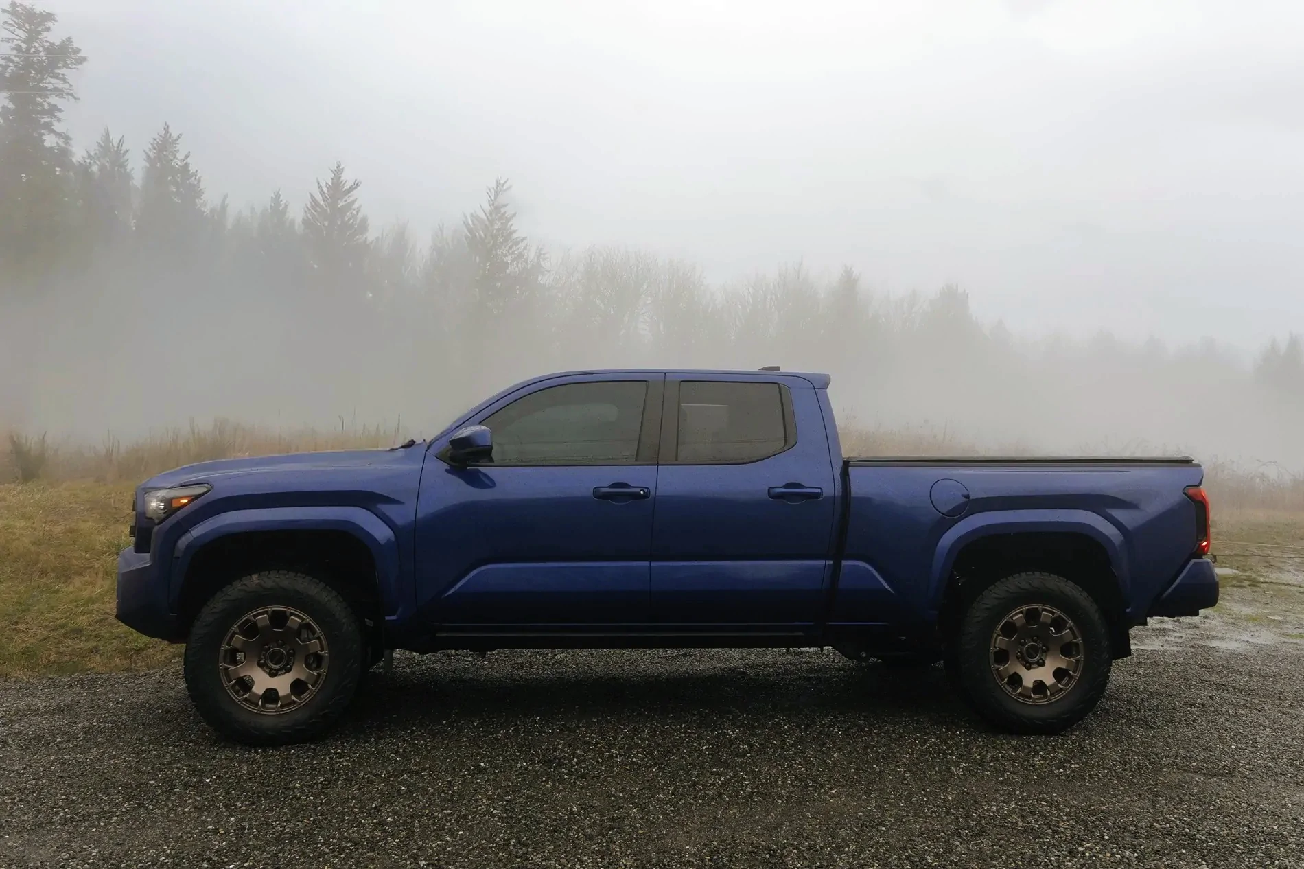

For those of you interested: I've done multiple measurements over the last few hundred miles and the truck remains completely level which means the 1.4" setting gave me right around 2" of lift in the front. Bilstein wasn't really helpful in providing an explanation, they just ran my VIN and proceeded to tell me that I have a TRD Sport (I don't, I have an SR5) and that the B8 5100 are not compatible with the sport due to the sport tuned springs in that package. Good for you sport folks to know! Although I did "meet" someone on reddit who added 5100s at the 1.8" setting with stock sport springs.
I am currently deciding whether I want to lower to the 1st perch setting or put a .5" spacer in the rear to get some rake back. I don't really have any way of telling how much dropping to the next perch setting will lower the truck since the perch setting tables are inaccurate, so I am leaning towards the rear spacer.
