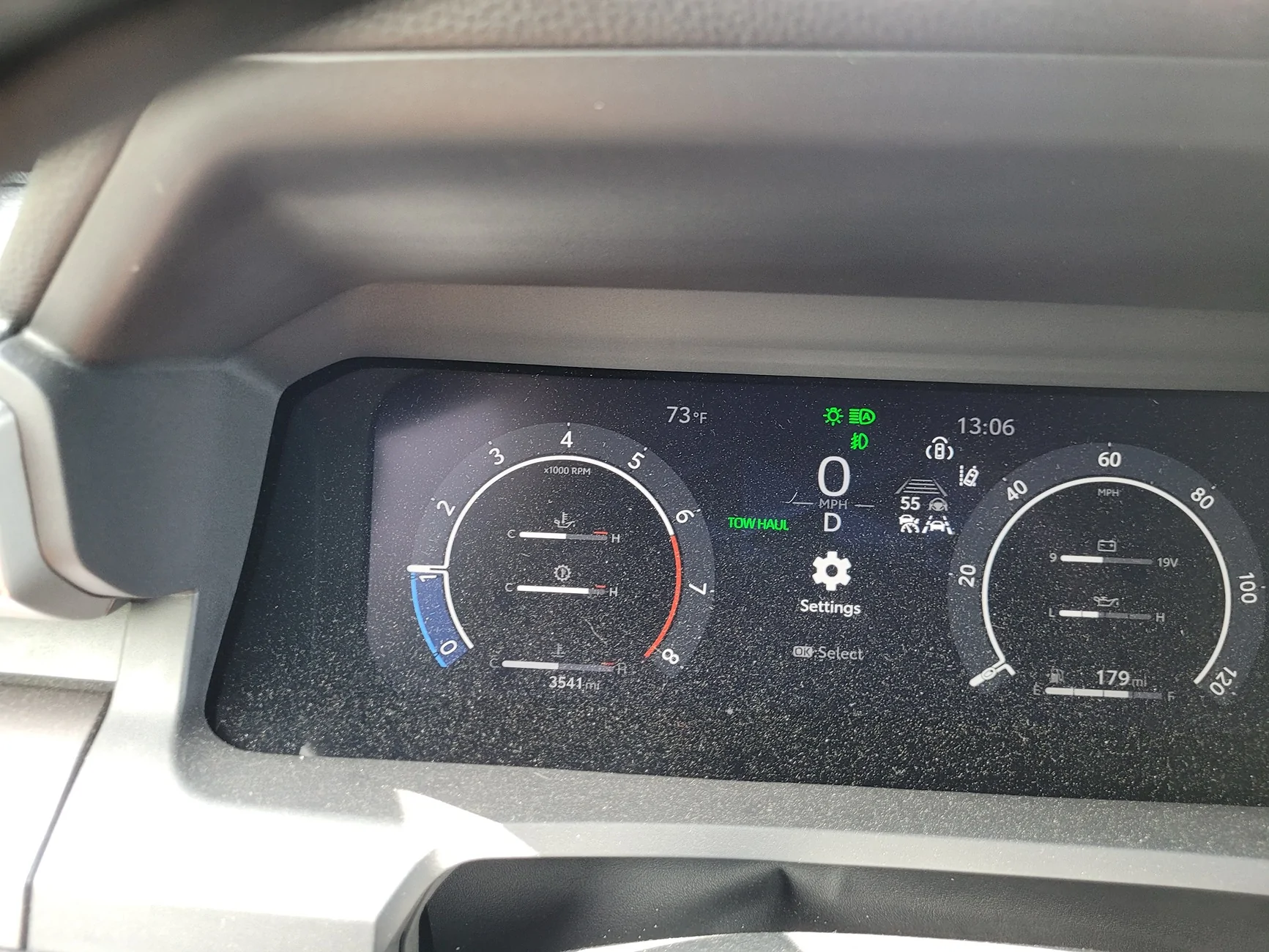

Just did a few days with an unloaded TRD Pro at 9-11k elevations.
Noticed a few things - in 2Hi in regular drive mode the truck likes to stay under 2k rpm's which caused the tranny to start to overheat.
When I went to S Mode and kept in 2d or 1st gear the temp dropped back down to mid range and stayed there all day.
Its not an airflow issue because no matter what gear I chose the speed and airflow remained the same and only started to overheat when it was in third gear or higher or under 2k rpm. 1st and 2d gear as long as I kept the rpms 2k or higher the tranny temps were stable.
Question now is, is it something with the torque converter that causes it too slip more under 2k rpm, or is it just an engineering/mechanical/gearing problem with 3rd gear or higher.
