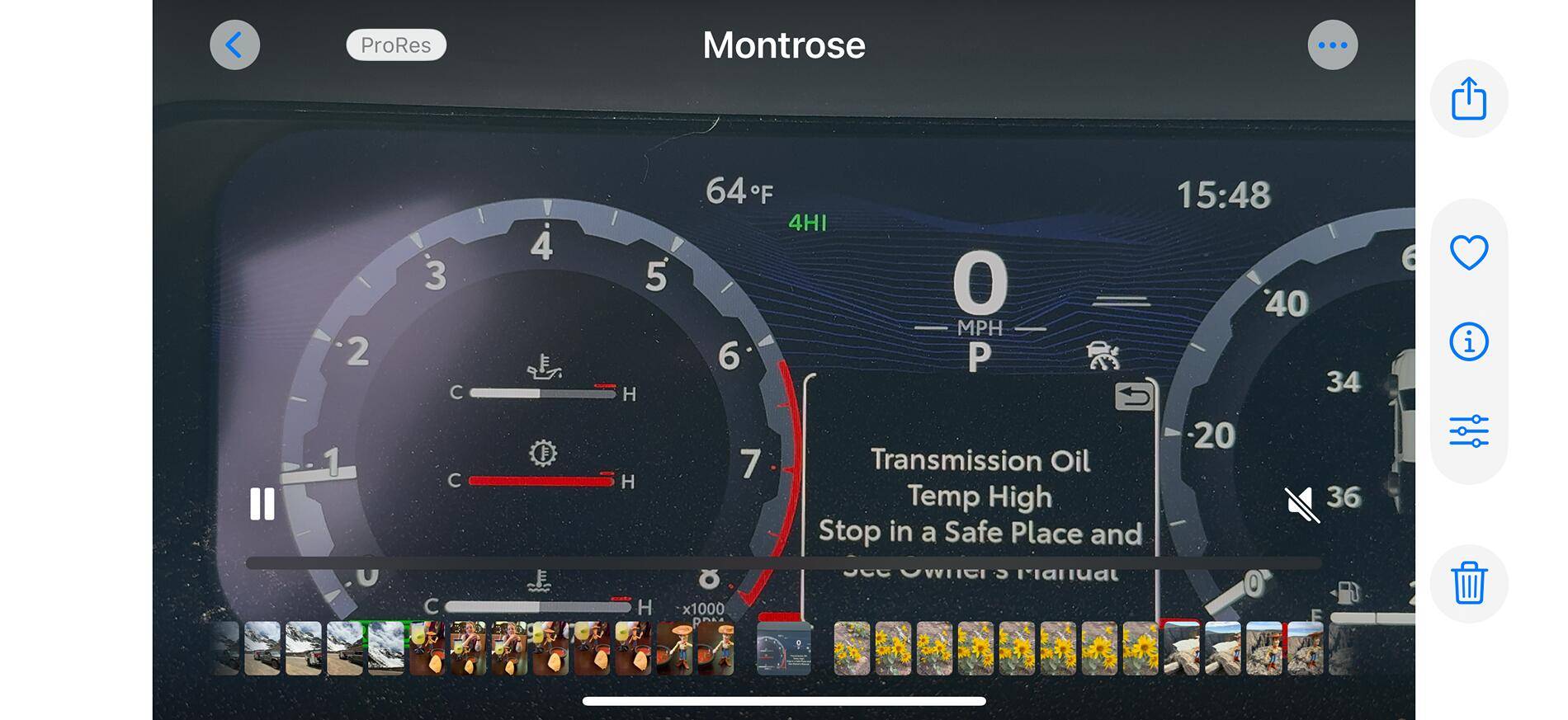

Had not heard of this until a couple of days ago and then expereinced myself. Had pulled Overland trailer (3500#) from Durango to Montrose on road. Fueled up in Montrose then went 12 miles outside of town to BLM dispersed camping . Trying to back trailer into spot (slight grad but less than 30 feet and dirt road), all of a sudden lost power and had warning come on. 1500 miles from home and still another 12 days of travelling.. Frustrated.. This vehicle should be built to take more than that,,

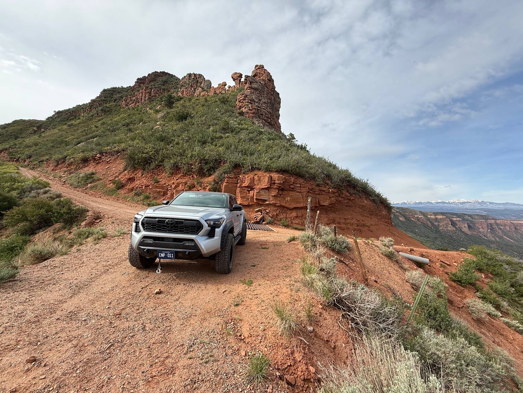

Did the same climb. Significantly less weight. I stayed in 2wd for a lot more of the climb and found 4lo to be too damn slow. Still bumped up against the red on transmission gauge and stopped to cool down a few times. I am OTT tuned and running heavy 34” C rated tires. A bit annoying but chose a Toyota for the aftermarket parts support that will be coming.

I wonder if it is a combination of the increased torque down low and the automatic not locking up due to whatever the computer decides. I have the 6MT so whenever I have obstacles / anything more than a mild climb I'm in 4LO anyway.
Good point. They may be over-taxing the automatic in 4 HI on steep terrain.
scottiev
Scott
May 8, 2024
CT
Nice shot.
You're causing your drivetrain more stress by using 2Hi instead of 4. That's going to hit your torque converter a lot, and all that excess energy is going to heat. And the upsized tires don't help. Use 4Hi or 4Low.
