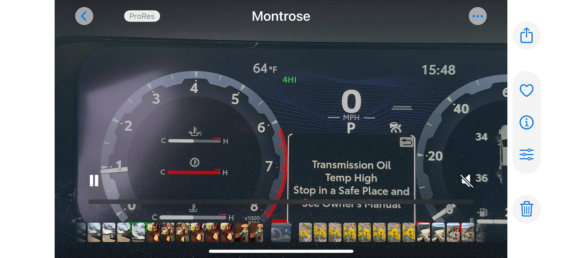

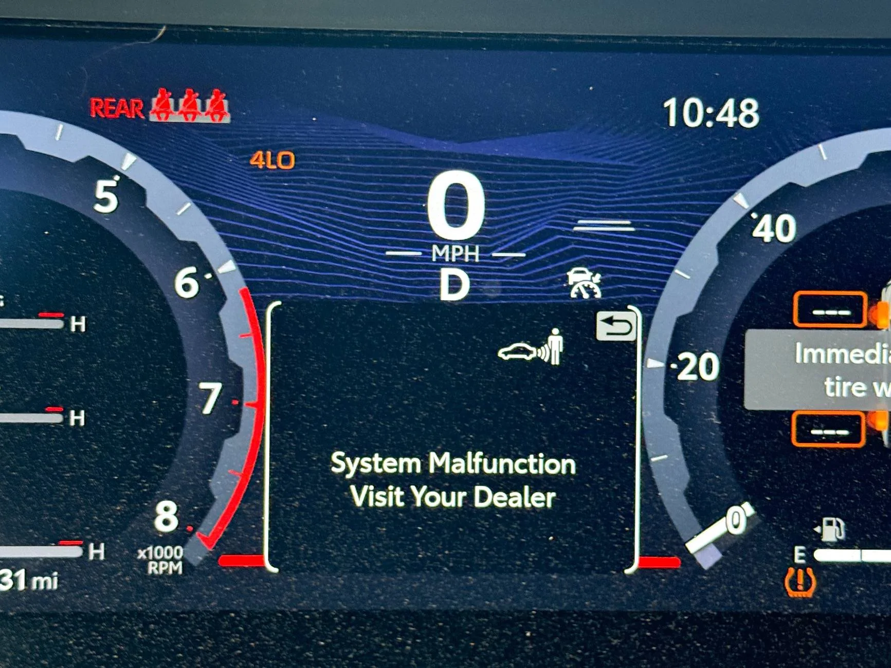

So took my TH in for oil change and 10K checkup.. Told them about the transmission heating up and also about the System Malfunction Visit your Dealer message I got running 4HI in Great Sand Dunes NP.. the message went away after stopped, turned off truck and waited couple of minutes.. Their replay was that they checked and there were no codes thrown at all and that if the Trans heats up and gives a Warning and goes into ‘limp’ mode, it doesnt throw codes.. Since nothing was wrong with the transmission when I took it in, their response was they had no idea.. First they blamed it on all the aftermarket stuff I have on (Method wheels with Falken 285/70/r17 tires, Prinsu rack, AluCab Contour Canopy and CBI Covert front bumper with Warn 10S winch.. Then they blamed it on the fact that I was out West and it must have been hot! Until I told them in May it was 50-70F most days..
Really disappointed.. They said they hadnt heard anything about Tacomas having problems with Transmission heating up..
wonder how to get a listing of all the problems being reported to Toyota about the new Tacomas?
2024 Tacoma 2024 Tacoma Transmission Overheating on Long Climbs Off-Road IMG_2622
2024 Tacoma 2024 Tacoma Transmission Overheating on Long Climbs Off-Road IMG_2146

All, if you go into the main infotainment (where you control the radio) screen there's a menu for vehicle alerts. I believe it's under the car icon. When the overheating happened to me (turned out to be loose radiator fan plugs) I was able to pull up the history of alerts.
