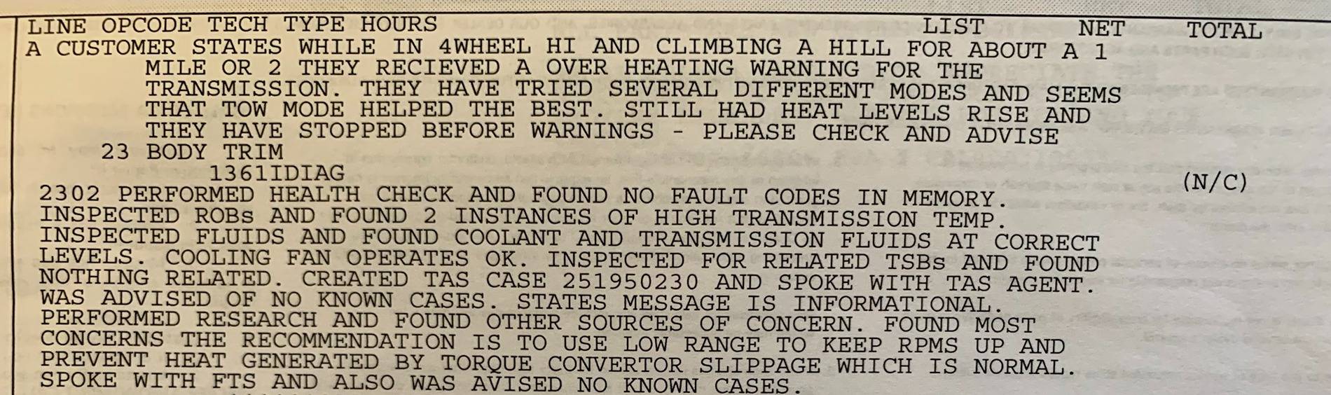

Just got the 4Runner back from the second dealer. They ran a health check and found no fault codes. They then ran the Record of Behavior (ROB) and found the two instances of high transmission temps. The first dealer I went to did not find this. The dealer that did created a Technical Assistance Case (TAS) with Toyota and it got assigned to a TAS agent to investigate. This was the first nationwide TAS created for this, so I humbly ask all Tacoma and 4Runner owners who have experienced this issue to take it to a dealer that will diligently inspect the ROB for diagnostic codes and have them create a TAS with Toyota. If Toyota has enough TASs then hopefully they will come up with a fix. Toyota did not say definitively whether or not this would be covered past warranty. Also, the 2024 Tacoma they gave us as a loaner had the same issue when we took it off-road. Thank you everyone for your posts on this.

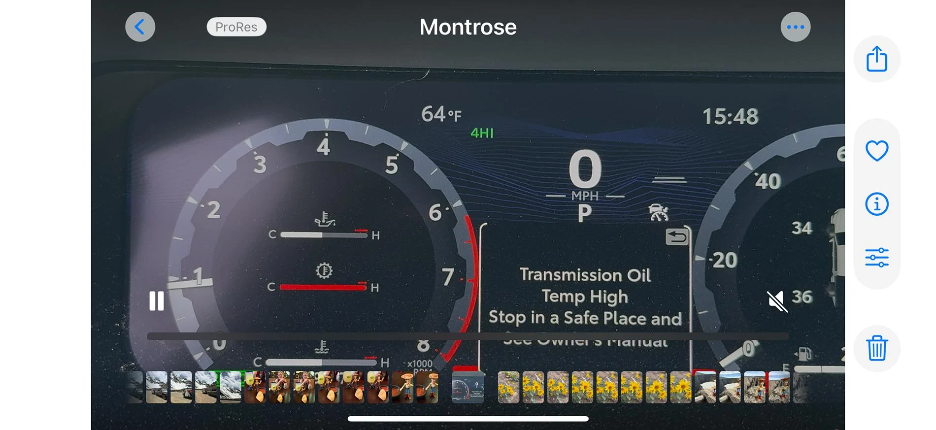

I have a 2024 TRD Off-Road with the tow package. Had it in Colorado two weeks ago and experienced this issue going up to the peak of Imogene Pass. I was in 4H and the trans temp was slowly increasing all the way up the trail. It never got to a warning message, but I did stop a couple of times to let it cool down in the hopes of not getting a message.

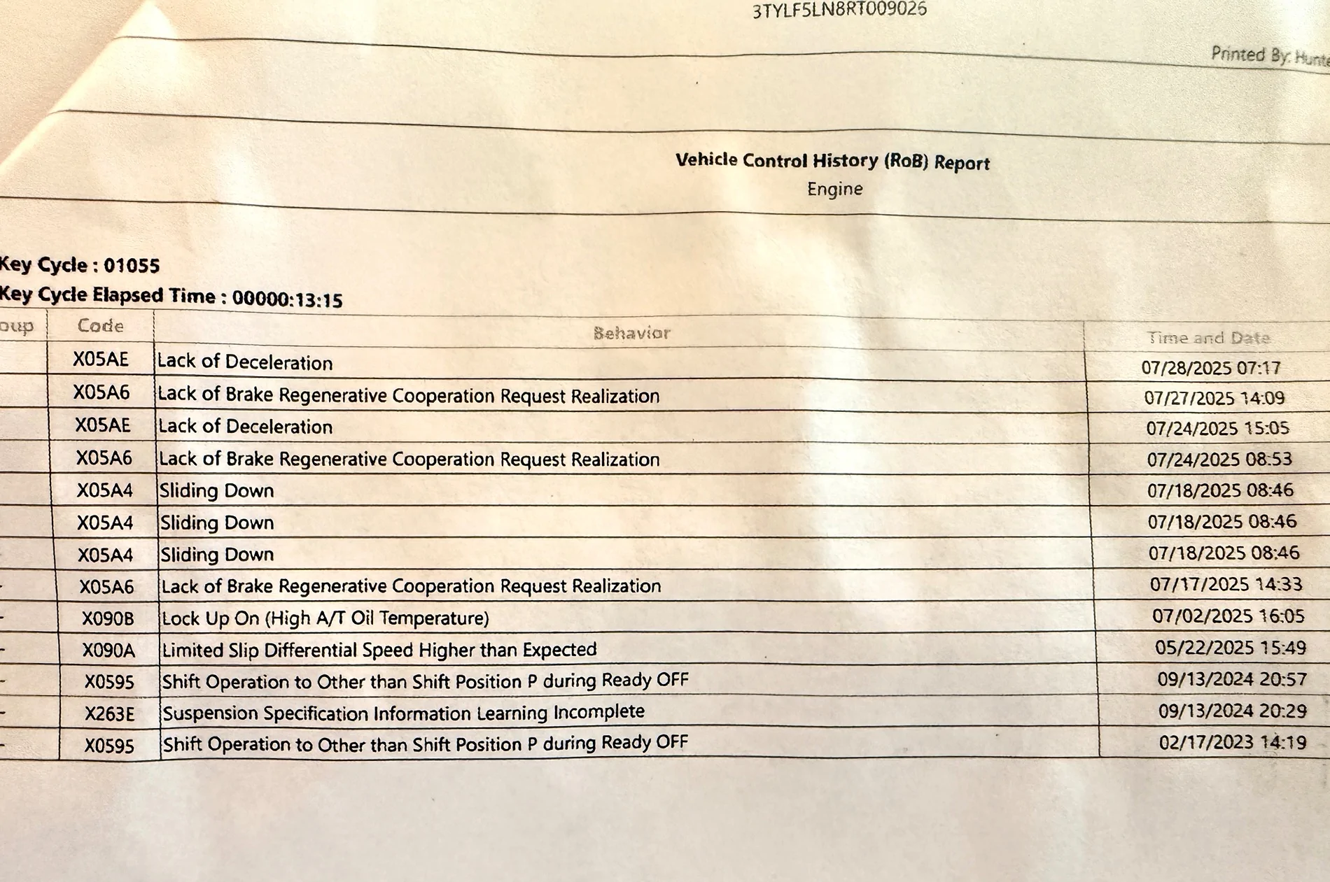

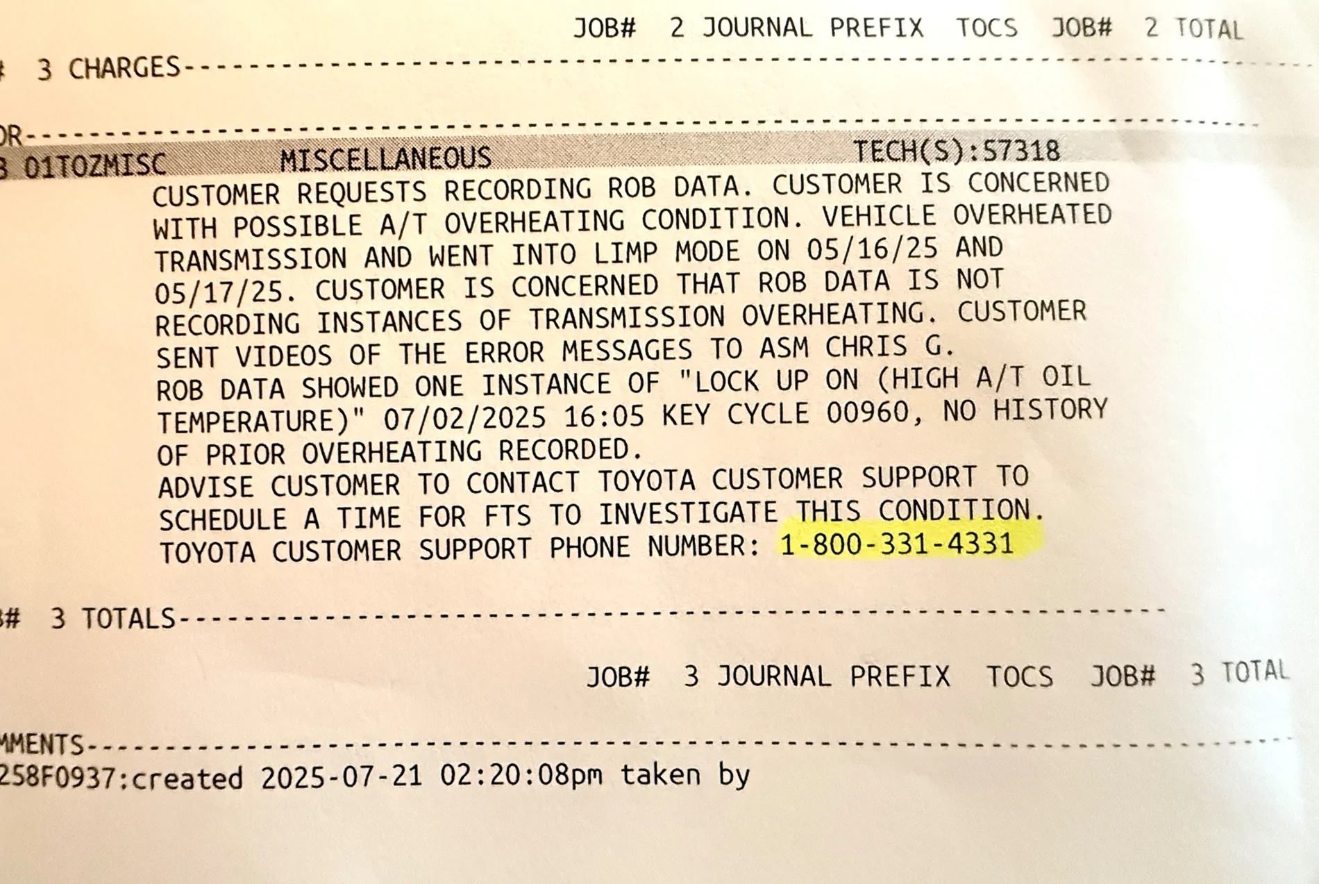

So, took my TH to dealer to have the Blind Spot Monitoring fix done and had them pull the ROB.. They showed me the printout.. Talked to the tech and told him that neither episode of Trans Overheating (which also trigger Limp mode once) was represented.. Even though I know the date and time and have a video recording of both.. They said they couldnt do anything about it if it wasnt happening there.. They suggested calling Toyota Customer Service as I would get quicker resolution.. They said to open a case, I would have to leave my trcuk with them for 1-2 weeks.. I said bull crap, let me know when a FST is scheduled to be here and I will bring truck and meet him and we can talk.. There is nothing the dealer can do in 2 weeks to try to cause the Trans Overheating.. The fact that the 2 instances didnt even show up on the ROB is disturbing..
Any suggestions on what to say or do to escalate this to Toyota Corp and their engineers?
