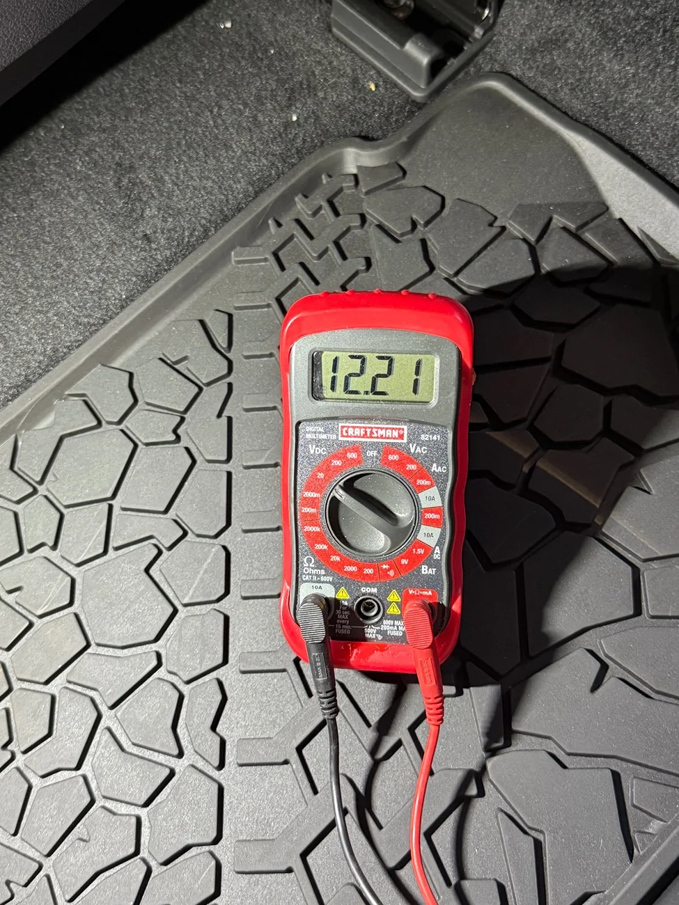

Took a voltage reading... 12.21V. This is on a 2025 TRD PRO purchased in February Not sure what to think.
Your truck will probably continue to start, because it uses the traction battery/motor to start the engine. Obviously having an alternator on some 2025 trucks has not fixed this problem.You can also reduce the chances of it going dead by not staying logged into the app, which was what Lexus told my wife to do with her BEV.
Everything that I have read says that a resting state of charge that low will eventually kill a 12 volt, so I don't expect mine to last very long. When the 12 volt fails I will replace it with a deep discharge AGM like an Optima yellow top.
If it were me - and this is easy to say sitting on the sidelines - I'd start documenting for a potential lemon law case. State of Charge vs Voltage data for sealed lead acid batteries is well known, and I challenge anyone to find an authoritative source claiming 12.21V isn't significantly discharged.
