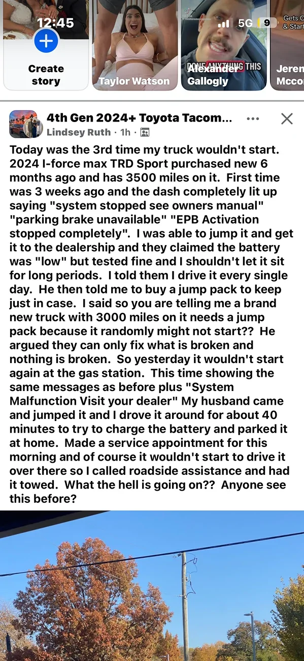

Same for me too. What kind of alternate universe are we in where an almost new Toyota can't be counted on to start and the dealer just shrugs and says that is normal?
Again, easy for me to say since I still have my 3rd Gen, but if it were experiencing this, I’d start looking into a lemon law claim. See what you need to document and so forth, state specifics can vary.
Just because somebody at the dealer says something, that doesn’t necessarily mean it is Toyota‘s official position. Make some noise. Get their attention. TV news consumer advocate if you have one. Open a lemon law claim to make it official and elicit Toyotas official response.
All properly functioning cars and trucks should keep the 12v battery fully charged. Failure to do so drastically shortens the life of the battery, as well as creates a safety risk when you can’t trust the vehicle to start anytime you need it.

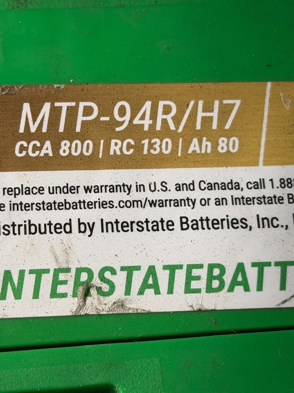

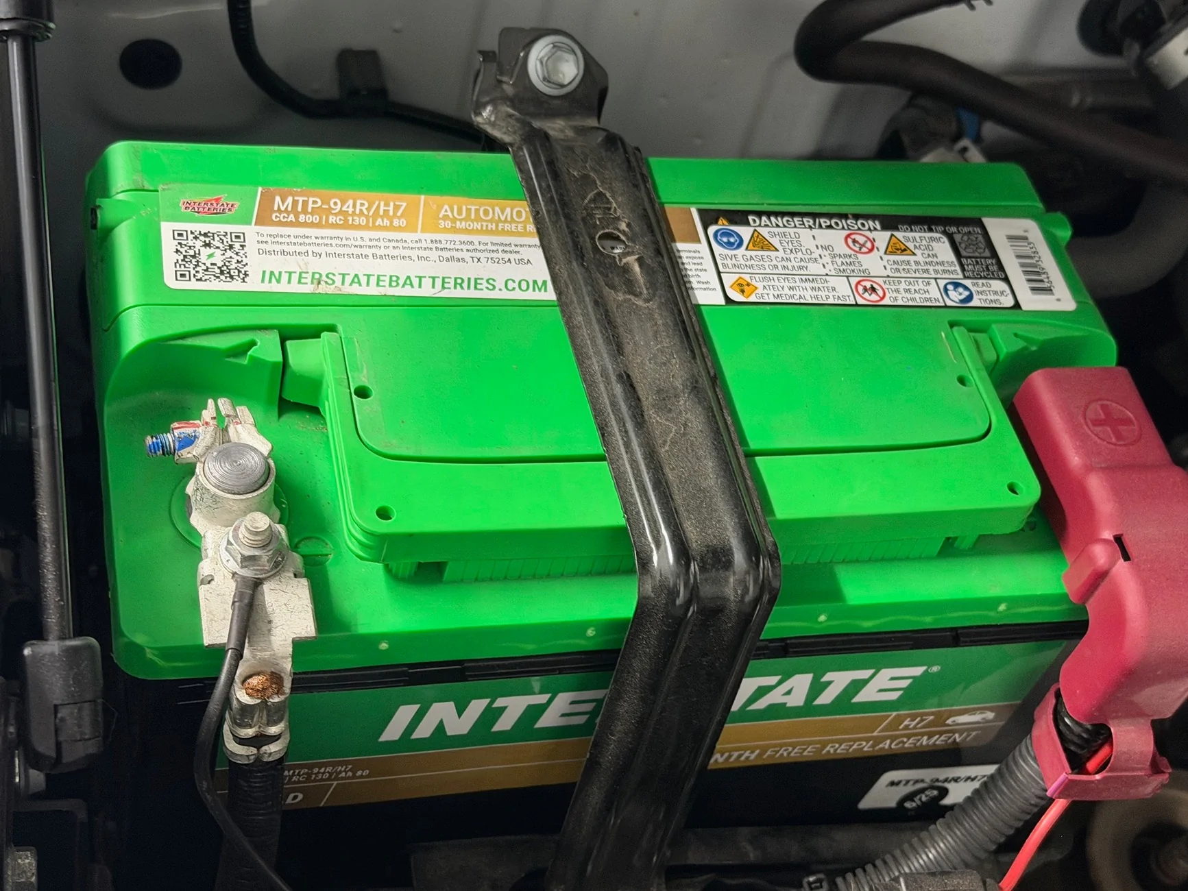

Well I have a 24 TRD Sport Premium and had battery issues.
First time died I was using the bed inverter with truck in ACC for literally 5 minutes to print a document off a printer I had plugged in, truck wouldn't start.
Then I left the truck in my garage for 3 days while on a trip. Truck wouldn't start. I took it into the dealer and they "tested" the battery and said everything was fine "it probably just needs to be charged". I then took it home. Left it on my charger for a while. It was working ok until the first cold snap hit us. Dead again after just sitting over night. Then died every time I turned it off.
I ended up replacing it myself. This is what I put in it based on one of my customers (Midas) that took care of me.
Battery issues seem to be fairly prevalent with many having good luck getting them replaced under warranty. I got tired of the BS and do not have time to leave my truck for an entire day for them to "we can put our lead mechanic on it and have him do some deeper testing" (WTF Toyota)
