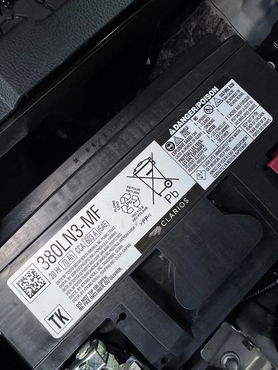

I’m pretty sure the consensus is that it’s not AGM but I haven’t learned much about batteries yet, I’m just happy my truck started after sitting for a week and a half
The label says "do not tip or open". I think that implies a standard flooded battery. The AGM type is still lead / acid chemistry, but the acid is in Absorbed Glass Mats (AGM) so it does not spill if tipped on its side.
Thanks for that pic. Did it look like there's a little additional space length wise for a H7 battery?
Sorry I have no idea what I'd be looking for regarding batteries, I can do a lot with a vehicle and rebuild engines but I haven't gotten into learning about batteries
According to Optima's website a DH7(deep cycle H7) is a perfect match for a Tacoma hybrid.
