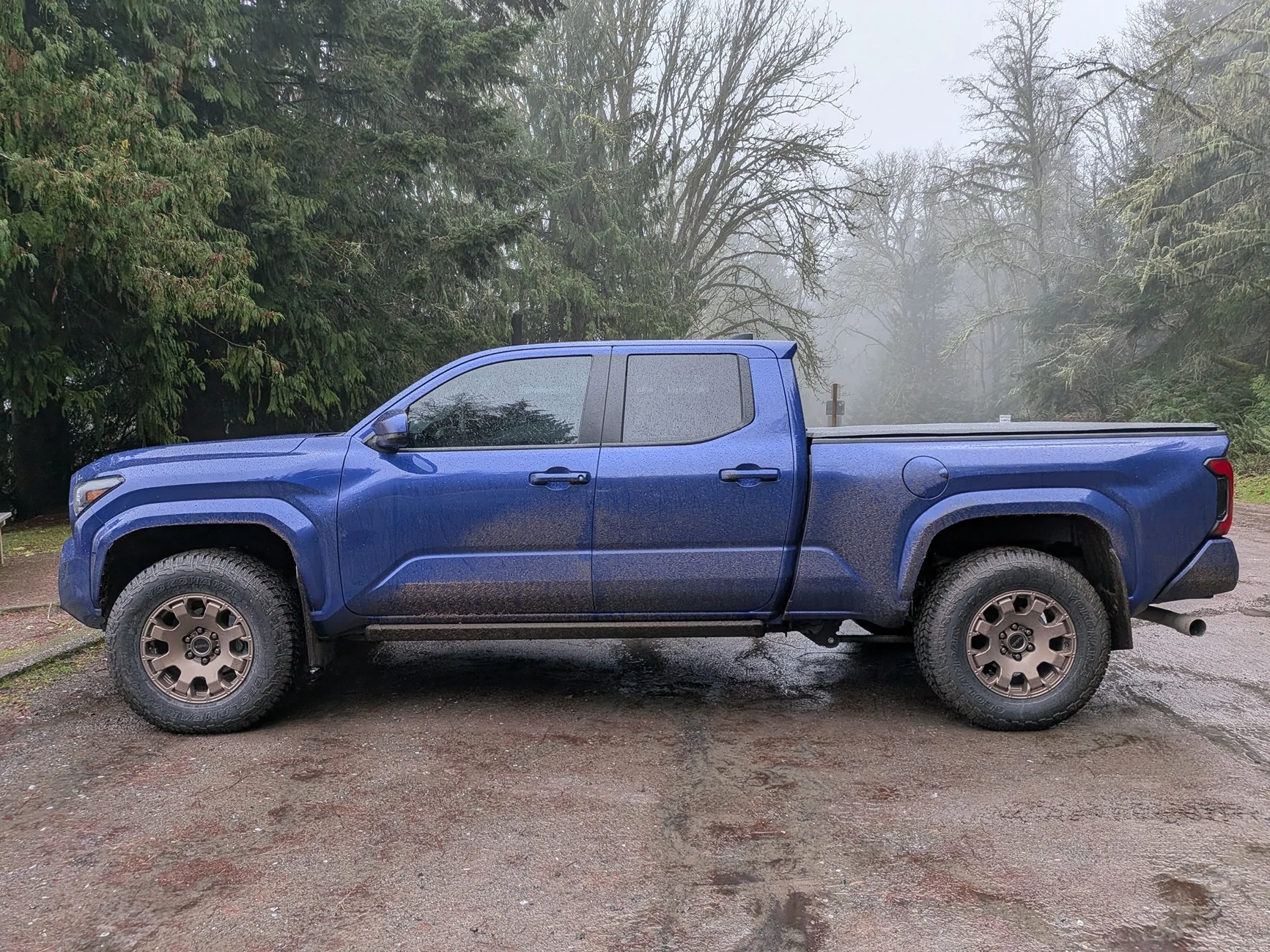

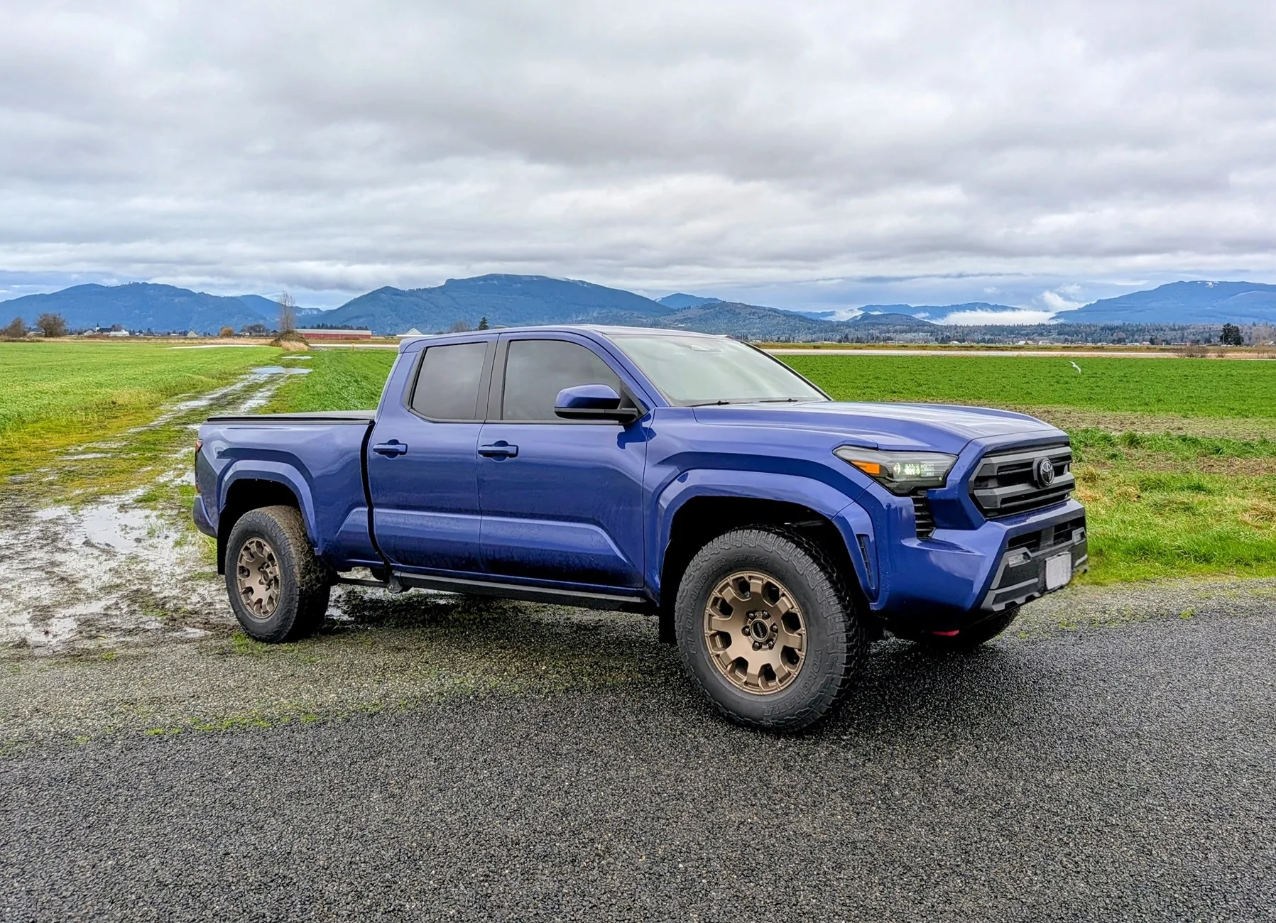

That size tire fits fine, even on a stock SR5. Could've just got some different flaps.
Tufskinz. Ark. Rokblokz. Rekgen.
Ran that size stock +25 and running that size now with 1.5" lift on +40.

Totally get it! I was just mostly saying for folks reading this in the future. I ran that same wheel with 275/70r18 on stock SR5 suspension which is even lower than yours. No rubbing, no problems.

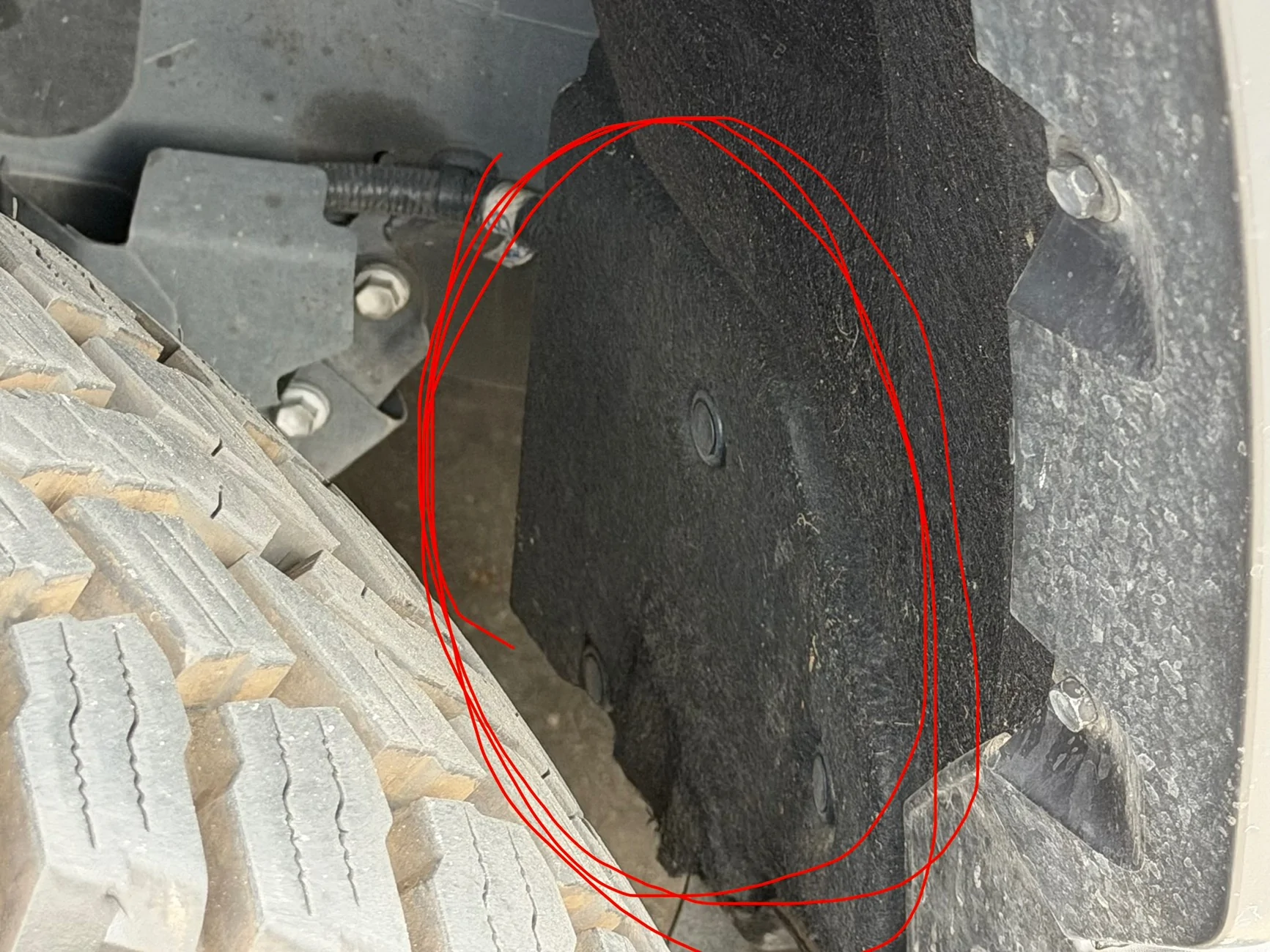

275 fit ok but only after I changed the caster a little. It was rubbing here. Still haven’t been able to locate the part number for the little piece yet.

Don't have a part number for it, but thats the crash brace cover. Pull those two pins and there's a big chunk of steel behind it that unbolts. Ark also makes a cover for when people remove the brace so there isn't a gaping hole there afterwards.

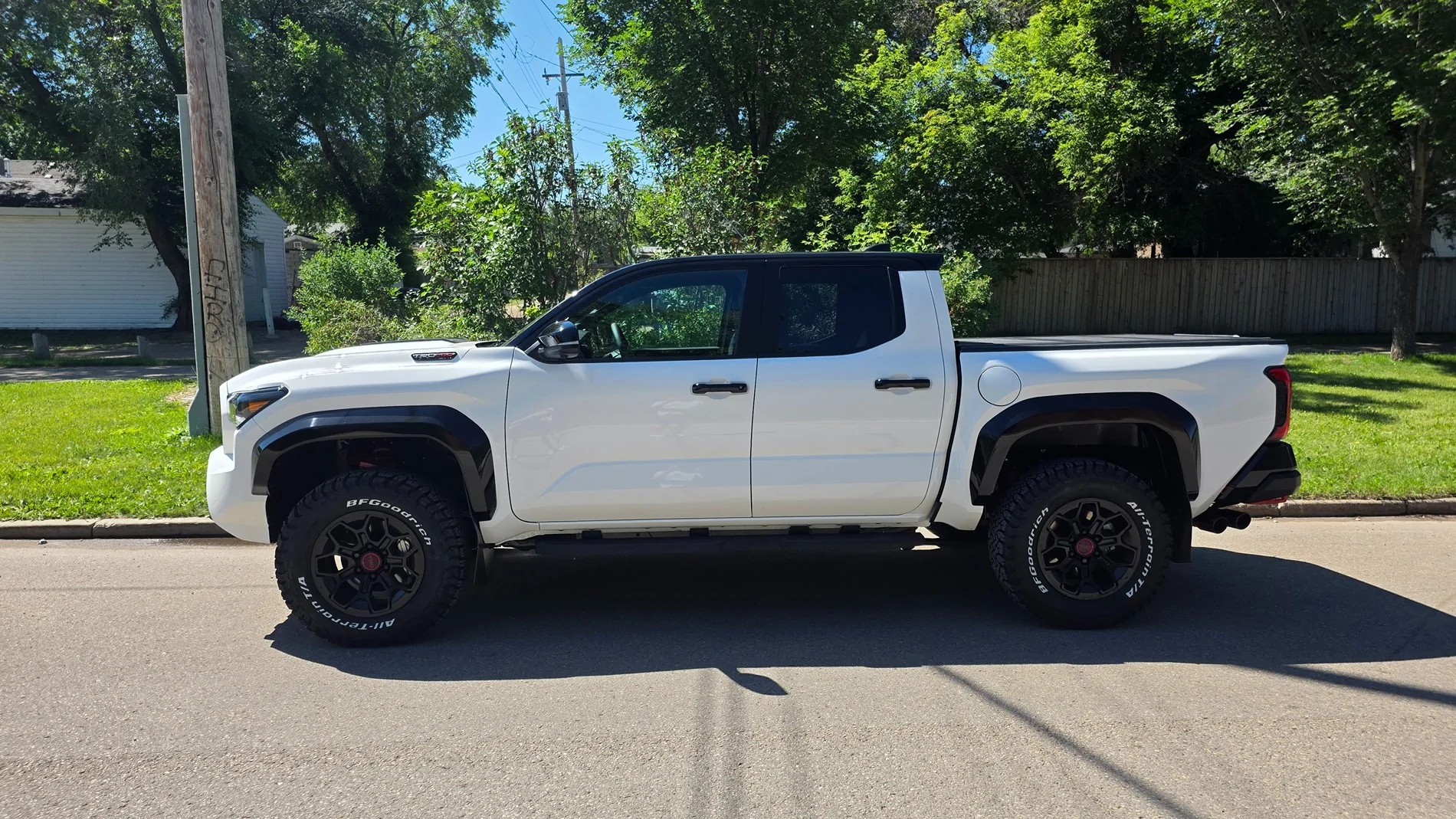

I just replaced the stock tires on my TRD Pro with 265/70 R18 K03s in D load rating. I think it looks a lot better than the stock Goodyear Wranglers. As an added benefit my MPG has improved slightly. Most people go with wider tires but I didn't want that.

Looks great! I’d welcome the added fuel economy but the 10-ply are pretty heavy. Not holding my breath :)
