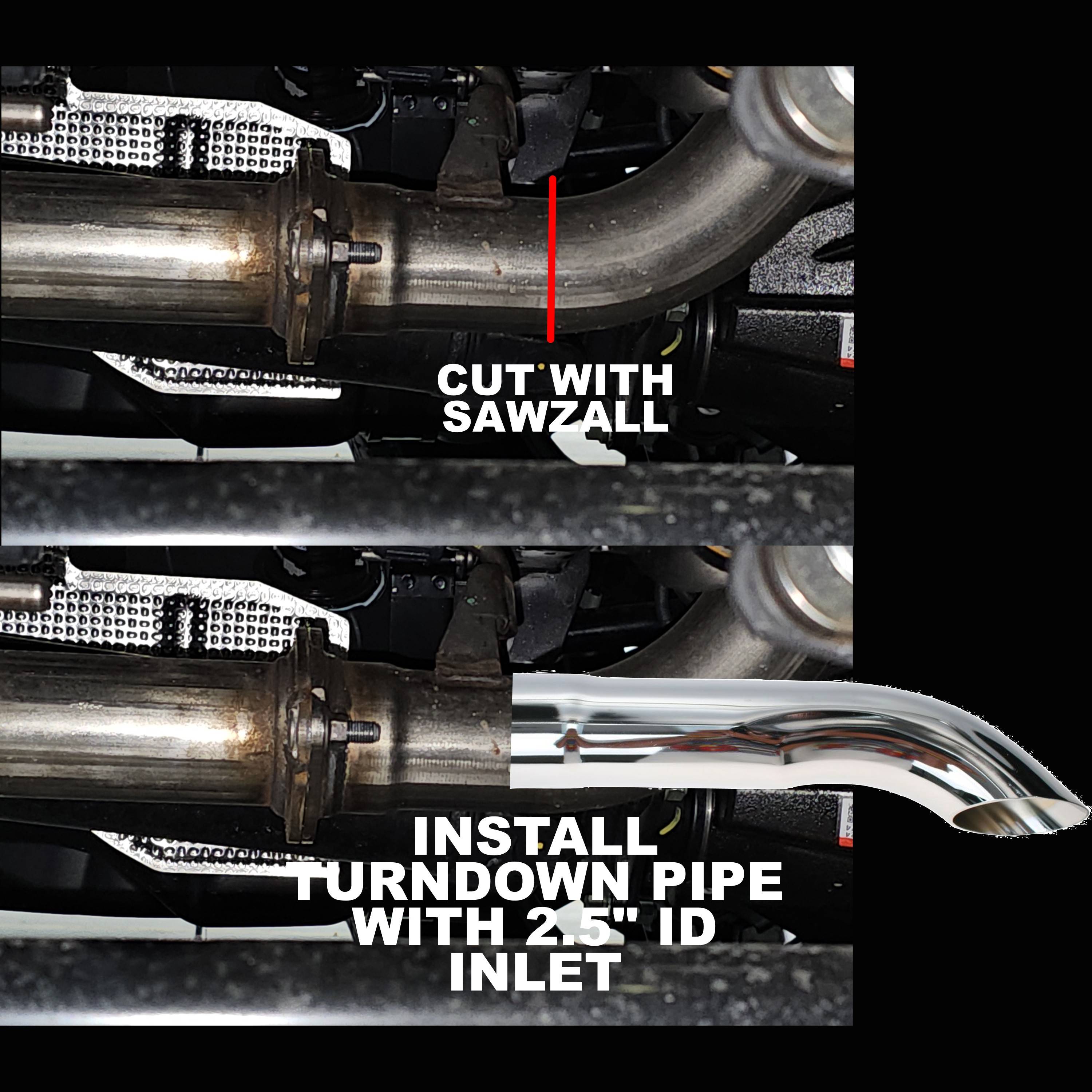

This thread had me thinking, you could easily complete this "mod" for $30 or less by simply cutting the exhaust before the bend and attaching a turndown with a clamp or welding into place. A quick search showed there's some nice stainless steel options. I'm personally not interested but thought I would put it out there...
2024 Tacoma Aftermarket: NYTOP Axle Dump Exhaust Tip for 4th Gen 2024 Tacom + Resonator Delete TURNDOWN

I've been wondering the same thing this entire time... Seems very possible

Yeah but then you don't have the bragging rights of being able to say you spent $300 on a $30 part.

I think finding the proper bolt on flange (is that what it is called?) and then adding the turn down would be best. No cutting required.
