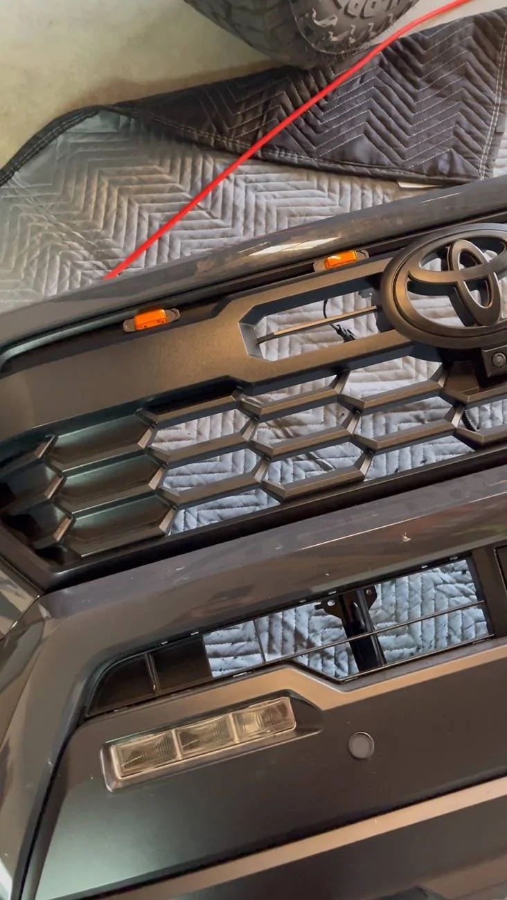

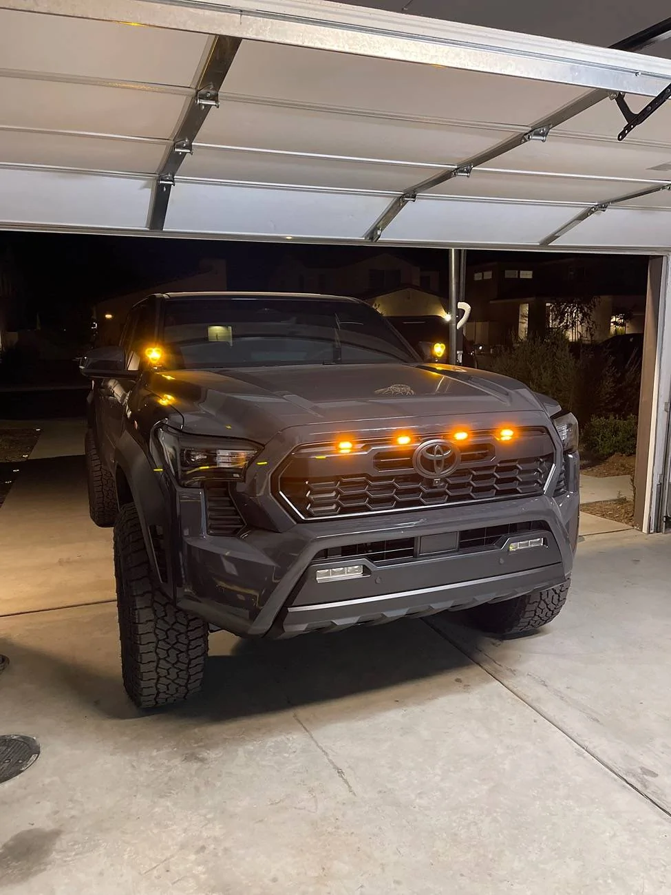

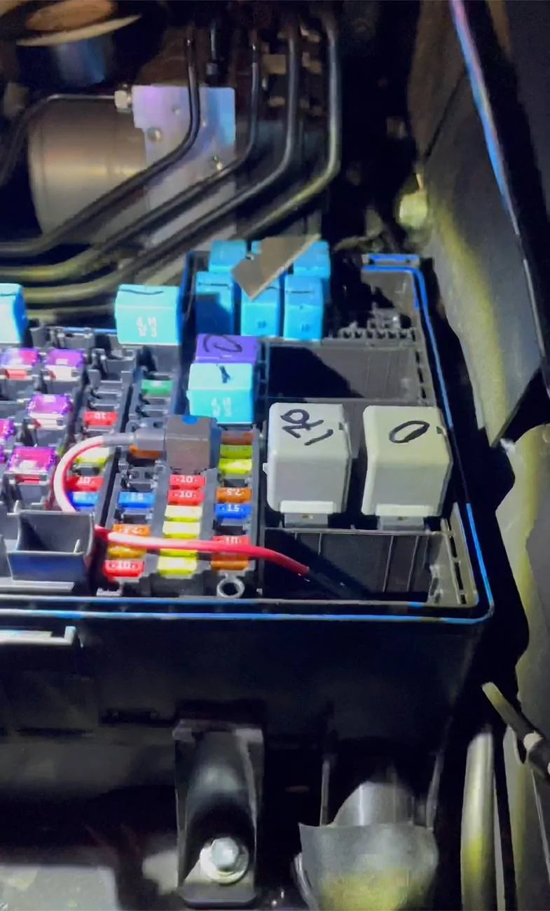

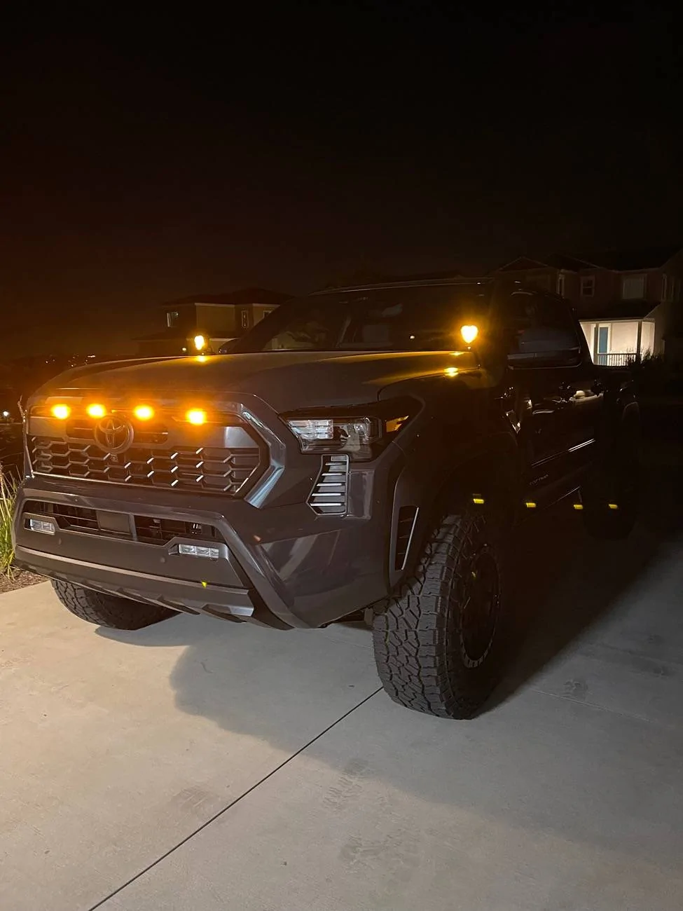

Was getting curious on how the 4th gen would look with raptor grill lights so I ordered some for a 3rd Gen from Seven Sparta(Amazon) and this is the outcome.
Cutting:

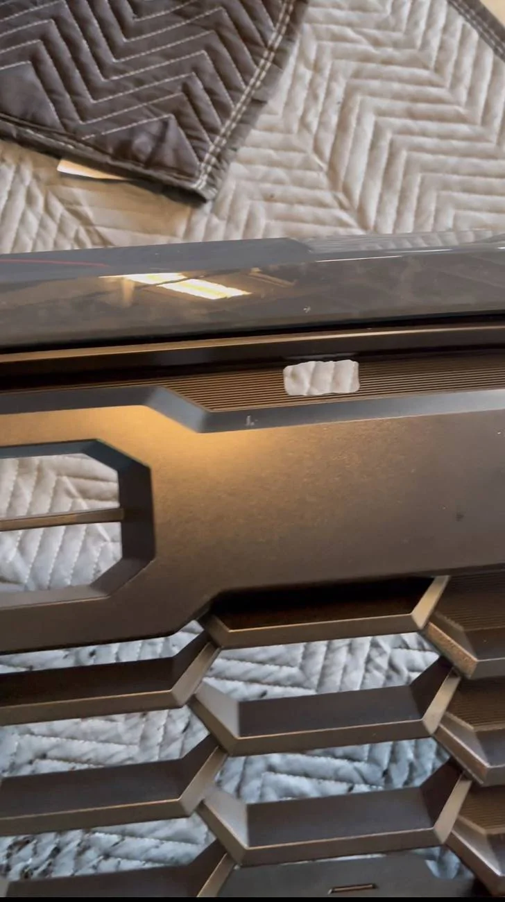

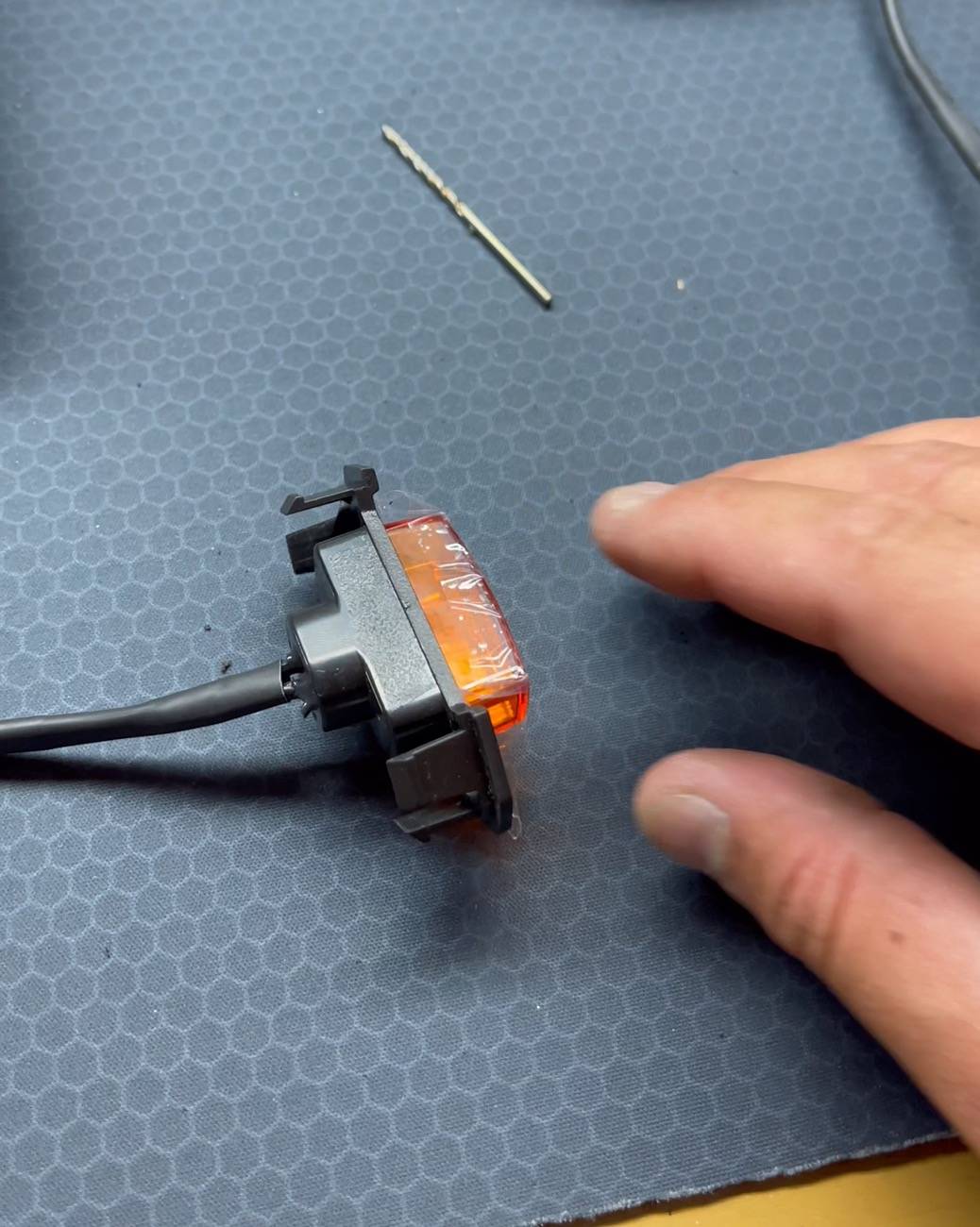

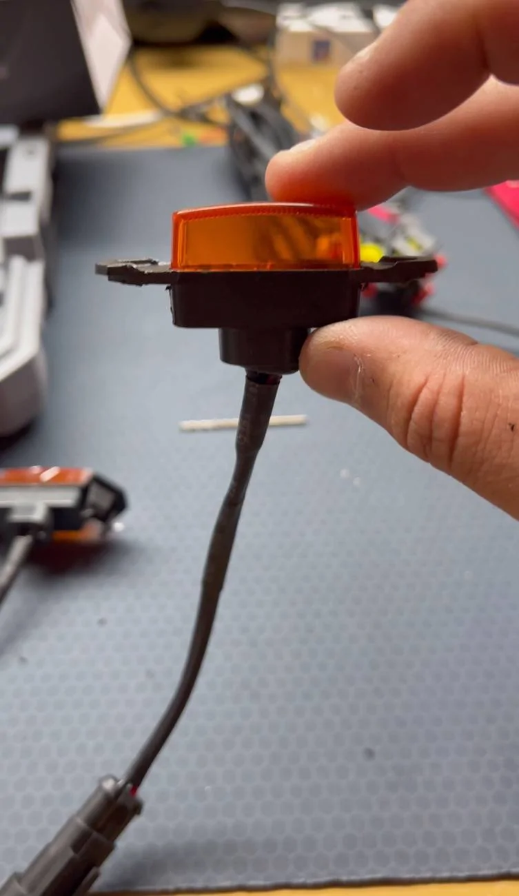

On the grill itself, I cut each of the 4 holes to a rectangular shape to match the size of the back rectangle shape of the led lights, this way I would be able to push the light from the outside in. In order for the lights to sit snug I had to trim everything except the 2 horizontal tabs on each side of the light(see picture). This would help the light stay put and avoid falling towards the inside of the grill when pushed or pressure washed. Once they were all in placed I pulled them towards the engine bay and held them with a bit of pressure using multiple zip ties.
Wiring:

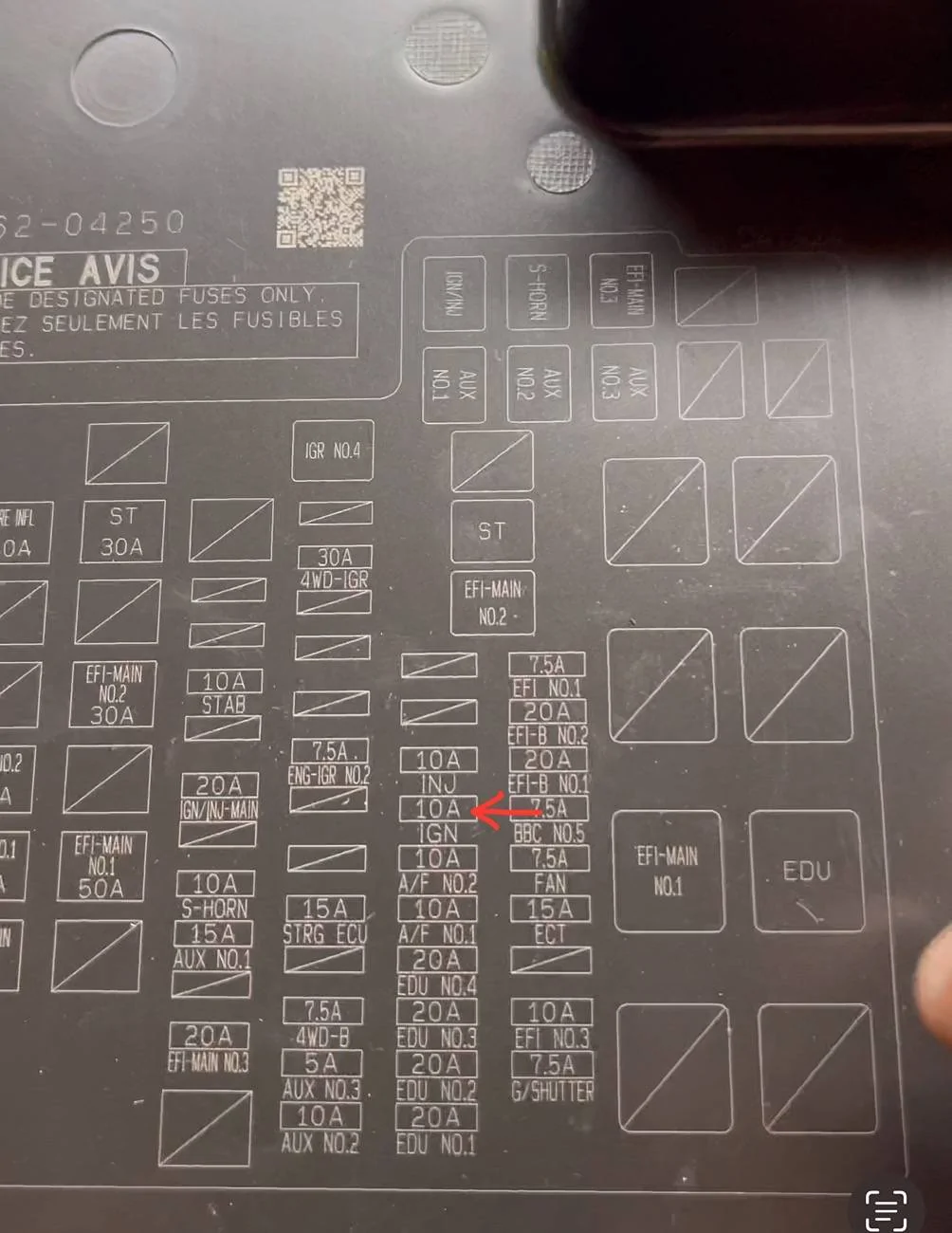

I tapped into the driver side fuse box using the supplied fuse tapper. I chose the 10A IGN fuse which is 7 from the bottom up since I wanted the lights to be on when the truck was on to act as a DRL.

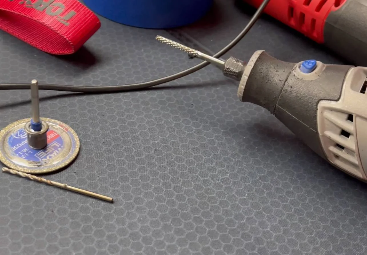

Tools:
Used a Dremel with 2 attachments.
1) Cutting wheel to trim all the tabs on the led lights.
2) Diamond bit to trim the rectangular shapes in the grill.
Here is a video I posted on YouTube if that helps you guys.

very clean - nice job
i'm curious, do you keep spare fuses on you in case it pops that ignition fuse?

God that looks so good, I'm almost tempted to do it myself so when I muck it up (which I will) I have an excuse to force myself to buy the pro grille

Once I started adding lights I did put an assortment of fuses in the small removal circle compartment between the driver door and the dash. Perfect spot!

Just go for it. It’s not hard at all, just take your time when trimming. Hardest part is figuring out how far apart you want them. Once you see them running, you won’t regret it.

Being that you used the ign fuse have you noticed your raptor lights coming on randomly while truck is off?
I installed my raptor lights using the IGN fuse and yes, I have noticed them randomly turning on. I thought it was cuz mine is the hybrid and it was doing an electrical test and turning them on. Actually good to know (for me) that it’s happening to the non-hybrid too. I’m still troubleshooting a fix. Unless you got one?
No fixes yet. I just removed the red wire for power. Only the yellow wires are still connected. They still work for the blinkers.
