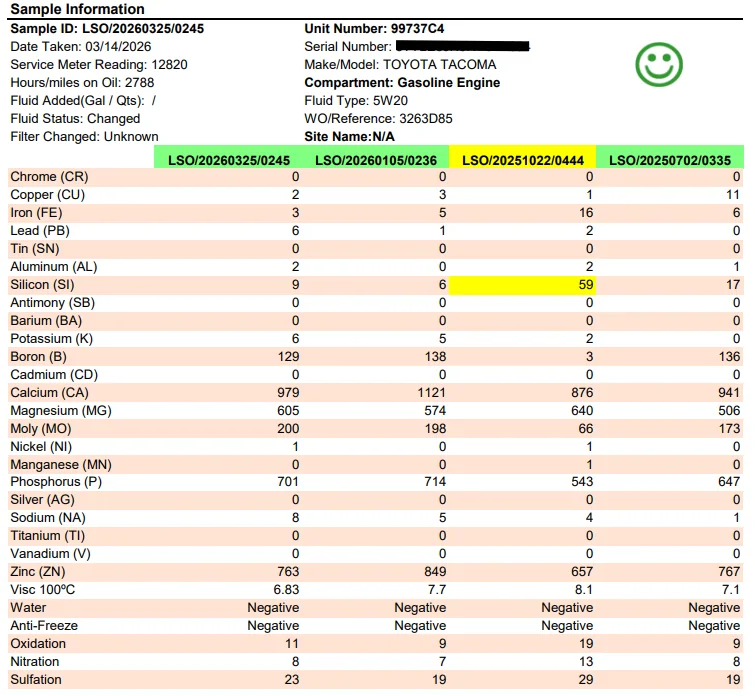

I've always been in the camp of frequent drain intervals 3k mi or less; full-syn became my norm years ago. In the last 30k or so in my last car (toyota), I used nothing but Valvoline Restore and Protect, and it made a positive difference with oil burning, so I set out to use that from the start with my truck. The thin, low-tension oil rings are actually my primary concern for longevity, along with carbon coking in the turbo, and I plan to put 200k mi on my truck.
I got my truck used with 1,500 on it, so I began sampling at 2,500-5,000 miles and roughly 2,500-mile intervals since then. I believe the elevated Silicon in the 2nd sample was dust in the hose used to drain using the fumoto valve, and I did the sample at the start of the oil drain, so I think dust contaminated that sample.
The first sample was Restore and Protect 0w-20, and the next three have been 5-20. I don't know how to explain some of the differences in the additive pack across the samples.
I'm on the coast in California, so my regular temps are very mild 40-80 typically. I did take a trip to Death Valley before the last sample was taken, and while it wasn't hot it was still 95+ degrees at times, and it's common to drive in 100-degree-plus temps on road trips, which I did several times in these samples.
I also have the Banks iDash and have observed oil pressure dropping with oil temps above 220F, which I don't hit unless in hot temps going up a grade and under boost.
Typically, the pressure is about 60psi on the hwy at ~2,200 rpm, and while at 235f it was down to 50ish PSI.
Long story short, I like having a thicker base weight oil and samples indicate what I'm doing is A-ok.
