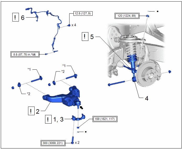

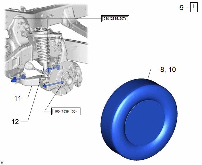

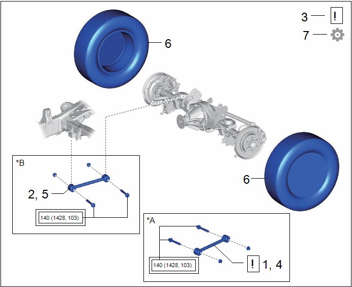

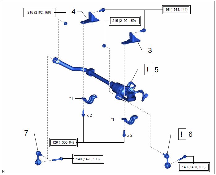

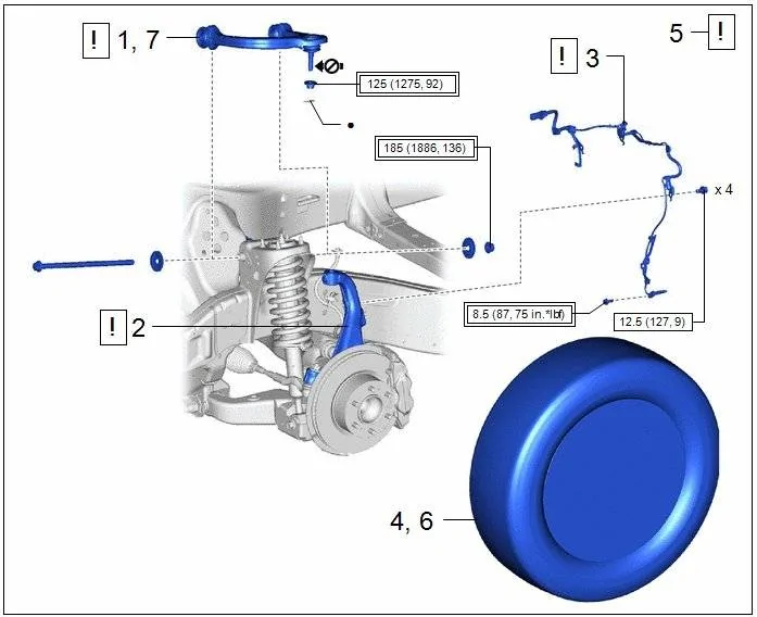

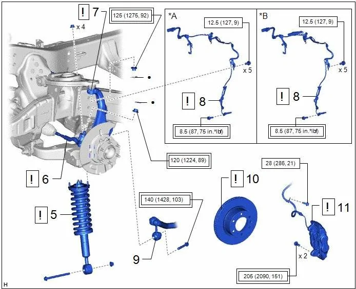

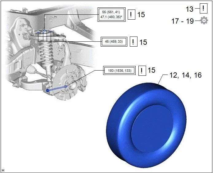

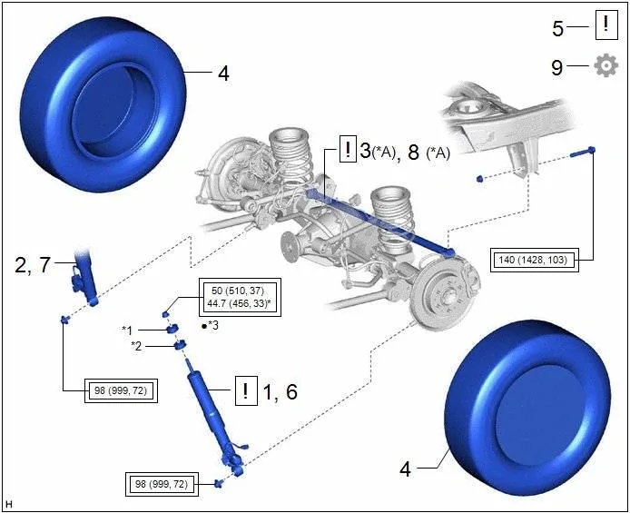

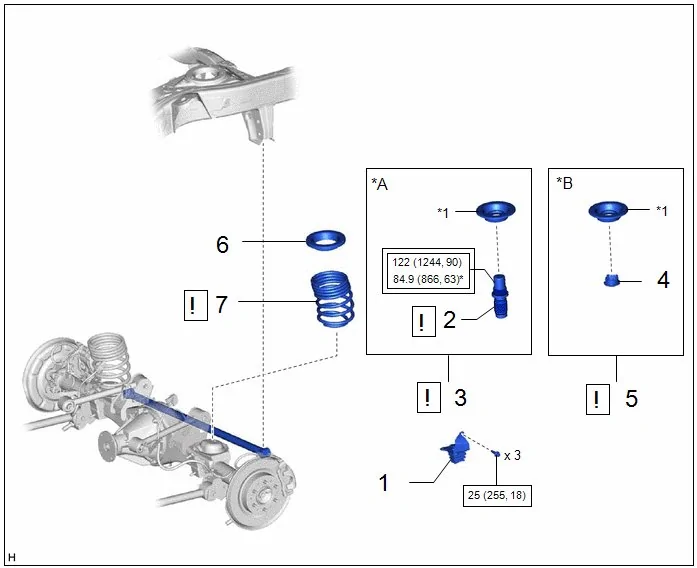

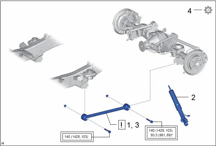

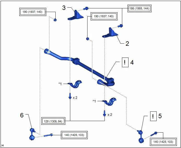

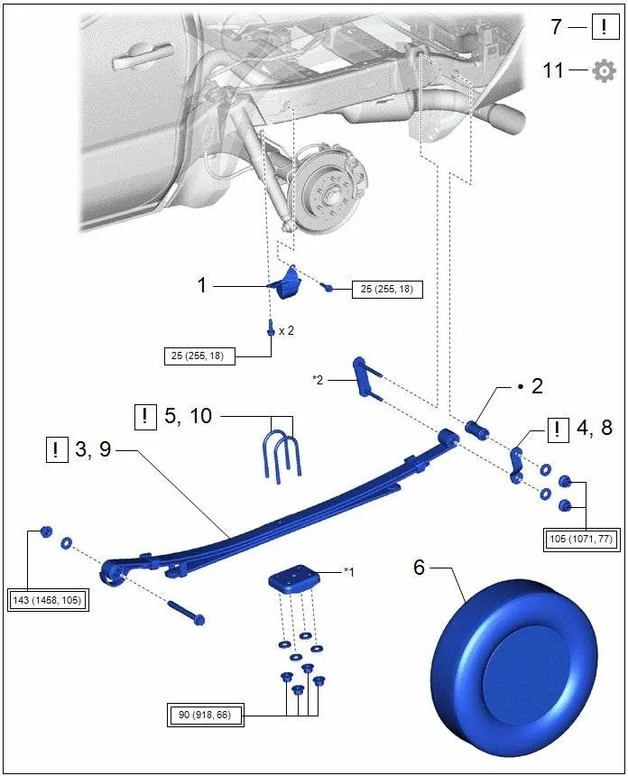

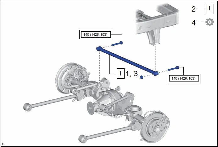

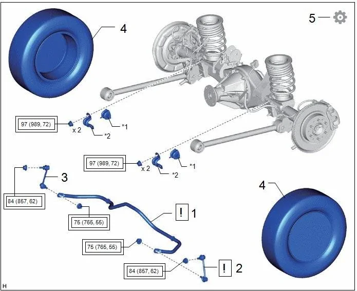

Hello,
I did a quick search and didn't see any of these posted for the 4g taco so I figured I'd share some useful torque spec information.
THESE ARE FOR REFERENCE ONLY!!!!
These values may not the same for every taco, they are all going to be very similar and in a lot of cases the exact same, BUT, there may be variations and you must do your own homework and double check everything with the appropriate manual. YOU MUST also make sure your torque wrench is CALIBRATED or what's the point!
These were early production numbers so keep in mind that things change with time, updated values may be completely different. MAKE SURE you know what you are doing before messing with your suspension.
That being said...
There are 3 values for each item, they are in the following format... N*m (kgf*cm, ft.*lbf)
Hope this helps.
IF YOU NEED ANAY ADDITIONAL VALUES, PLEASE REQUEST BY COMMENTING HERE.
2024 Tacoma 4th Gen Tacoma 2024+ Suspension & Wheel Torque Specs Guide Screenshot 2024-04-26 124816
2024 Tacoma 4th Gen Tacoma 2024+ Suspension & Wheel Torque Specs Guide Screenshot 2024-05-14 105552
2024 Tacoma 4th Gen Tacoma 2024+ Suspension & Wheel Torque Specs Guide Screenshot 2024-04-26 124852
2024 Tacoma 4th Gen Tacoma 2024+ Suspension & Wheel Torque Specs Guide Screenshot 2024-04-26 124929
2024 Tacoma 4th Gen Tacoma 2024+ Suspension & Wheel Torque Specs Guide Screenshot 2024-04-26 124942
2024 Tacoma 4th Gen Tacoma 2024+ Suspension & Wheel Torque Specs Guide Screenshot 2024-04-26 124958

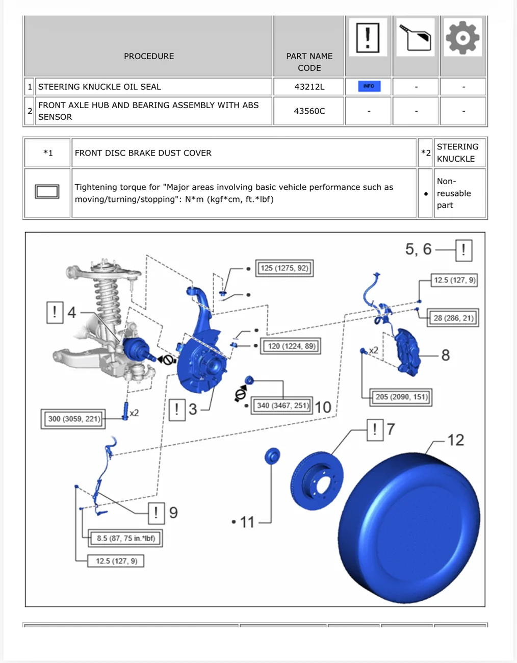

what is the torque spec for the front cv axle nut. About to put on my lift and do the ecgs calmshell bushing but i cannot find the torque spec for the axle nut anywhere. Is it 173 like in the 3rd gen’s?

251 lbf and they say not to reuse it.
