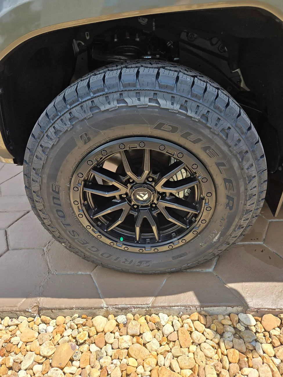

I have 25 Taco Limited Hybrid. I lost 3-4 mpg in the city when I changed the wheels and tires.
Fuel Rebel 18x9 20mm offset. Bridgestone Dueler AT Ascent 275/70 R18 E. The tires/wheels are heavier than stock. The tire fills the wheel well much better now, my wife saids the Taco looks tuffer. Looks good and more capable or better mpg?
