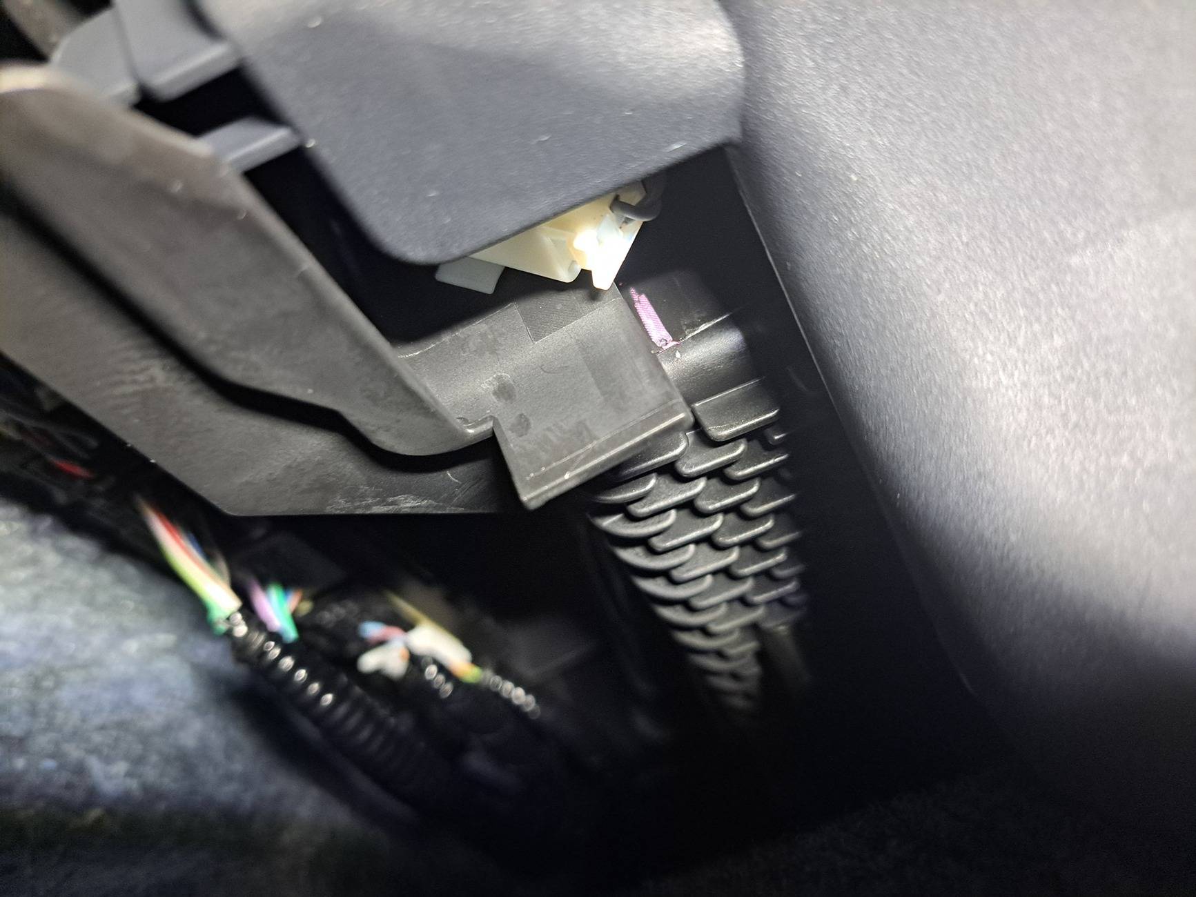

i just got a sr5 with the infamous 3ty vin - this thread got me worried so i ran out to check- no drips, but interestingly, did find a colored mark right at the seam - quality control check? reinforcing strip?

My recent build also has the pink mark, I was thinking QC check as well.
