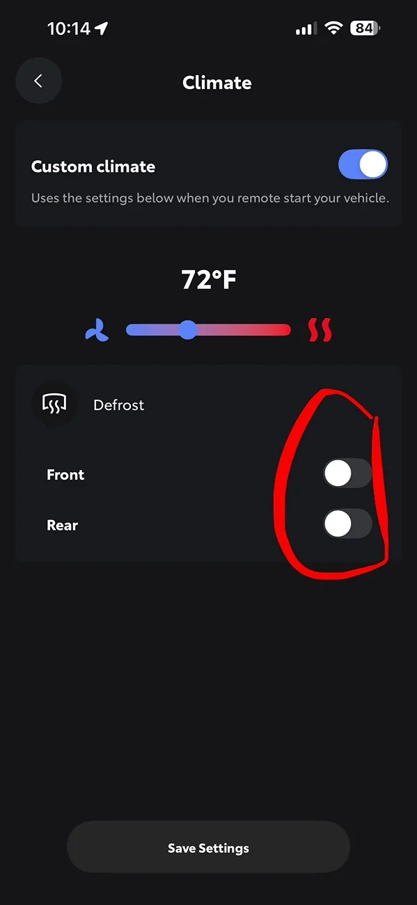

Another thing to consider …if you’re starting your truck with Toyota app…make sure you have the defrost setting off. I thought my AC/Heater wasn’t working. Turned out defrost was coming on every time I remote started the truck with the app.
2024 Tacoma Anyone else's heat suck? IMG_5287
