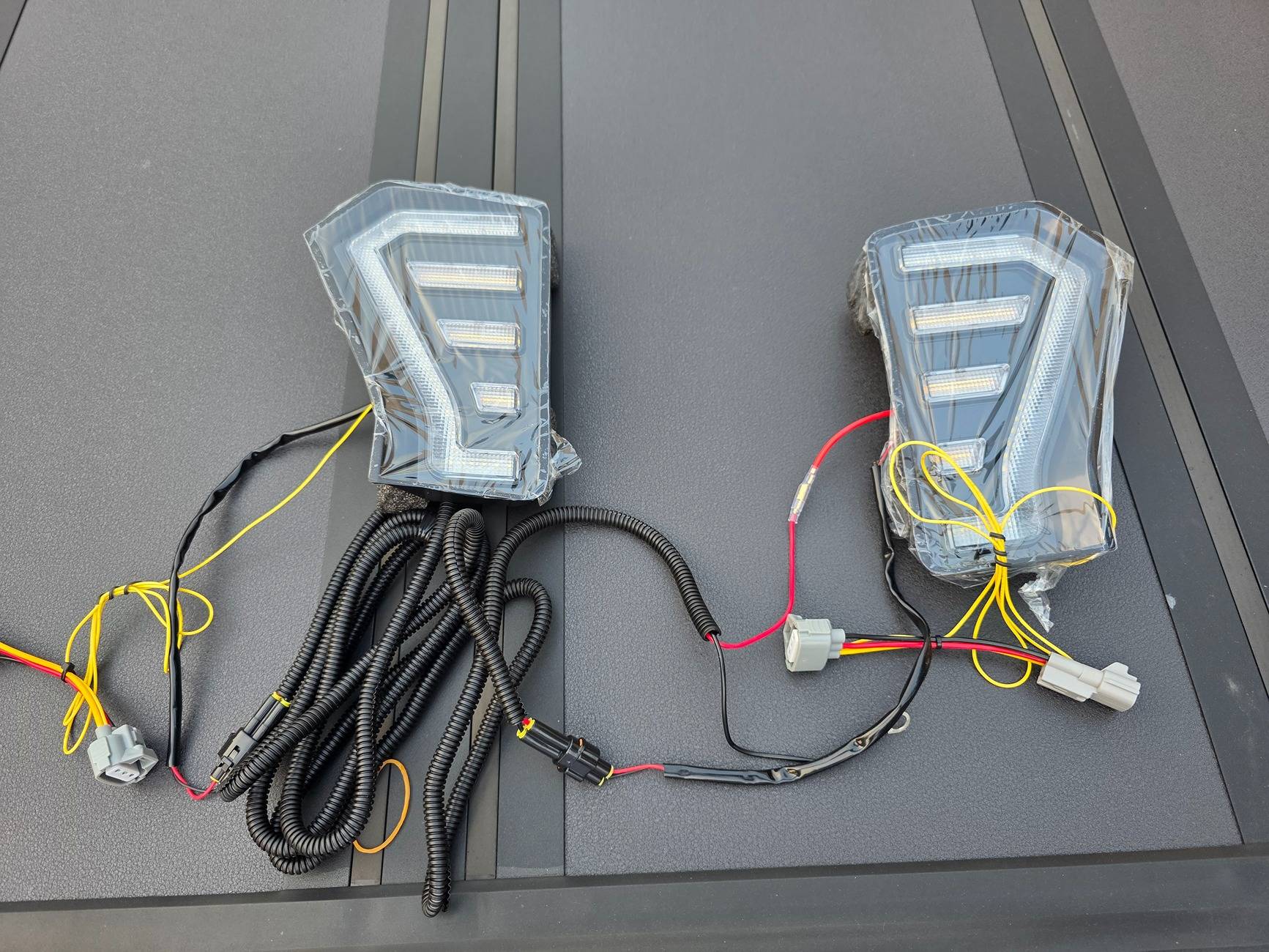

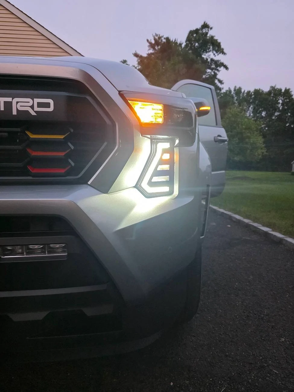

I just finished installing the Aspire V2 fang lights on my Tacoma. Whole install took about 45 min, but 30 of that was getting the factory plastic pieces off and zip tying the wires out of the way.

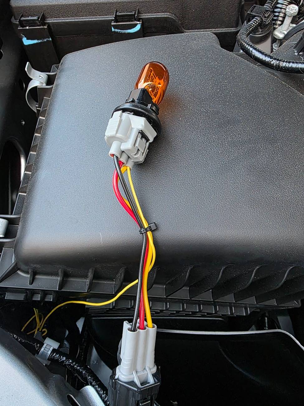

Legitimately plug and play. Once the Fang light is in the bumper, you untwist the yellow turn signal bulb, take it out of the housing plug it into the female end of the prewired adapter, plug the other adapter end into the truck wire housing and put the bulb back in.
I finished in the dark, so pics aren't great. But will upload new pics later

They do stay on while the truck is on. They aren't projected, so at night they make it brighter in the immediate area in front and to the sides. Maybe 10-15feet. Like a brighter glow. I can't imagine they are affecting oncoming drivers and definitely aren't high enough or directional enough to be too bright for someone you're following.
Out of the box, these were already wired into a harness that plugs into the turn signal light bulb plug, so without significant modification, you wouldn't be able to set them to an AUX switch. There are others available on Amazon for half the price that i am sure you can wire to whatever you want to, depending on your ability.
