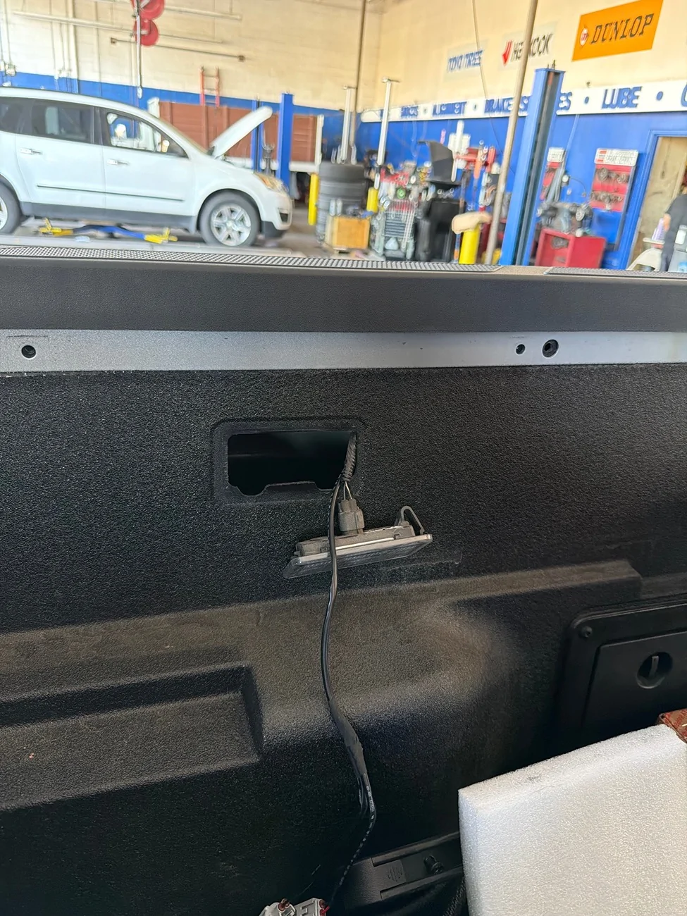

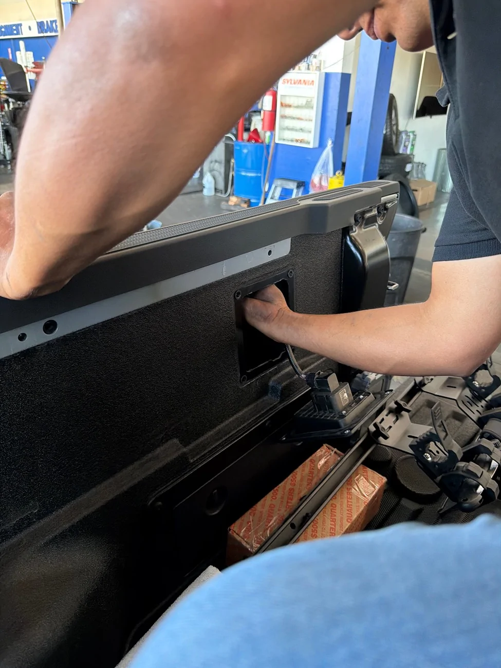

Ok. I got mine done. I popped the bed lights out by pushing the back edge tailgate side of the light toward the front. (The side with two notches is toward the bottom). Then I removed the storage compartment on the driver side and power plug on the passenger side to access inside the bed. That’s where I was able to connect the wiring. I was also able to zip tie from inside those two access areas. If you wanted to you can remove the tail lights to clip in the connector or just zip tie it all from behind the access areas.
Your way is definitely more clean but I just didn’t want to mess with the flares and liner.
Great job! I think that might be the way to go. Seems to be less intensive, that's for sure. :clap:
