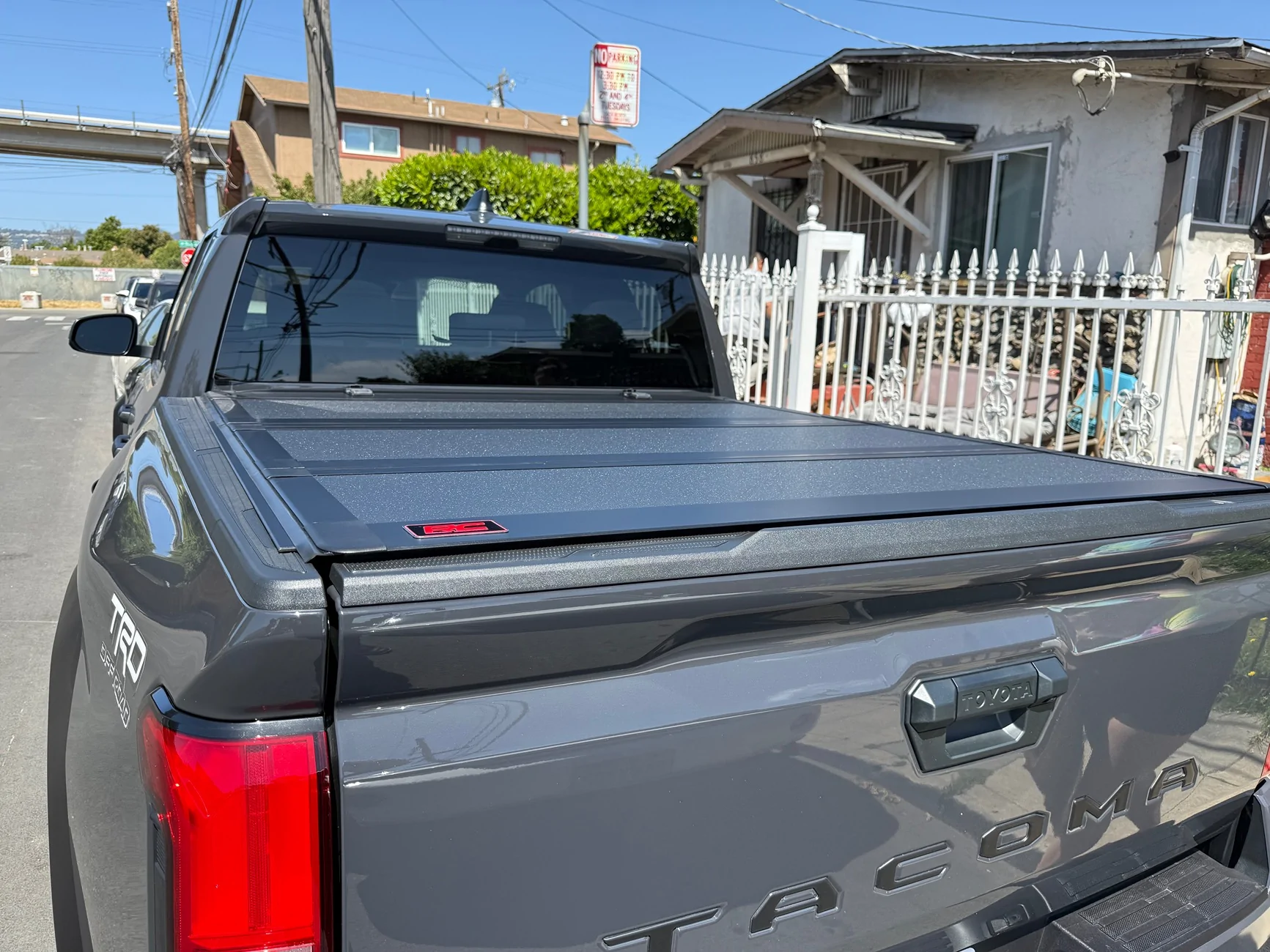

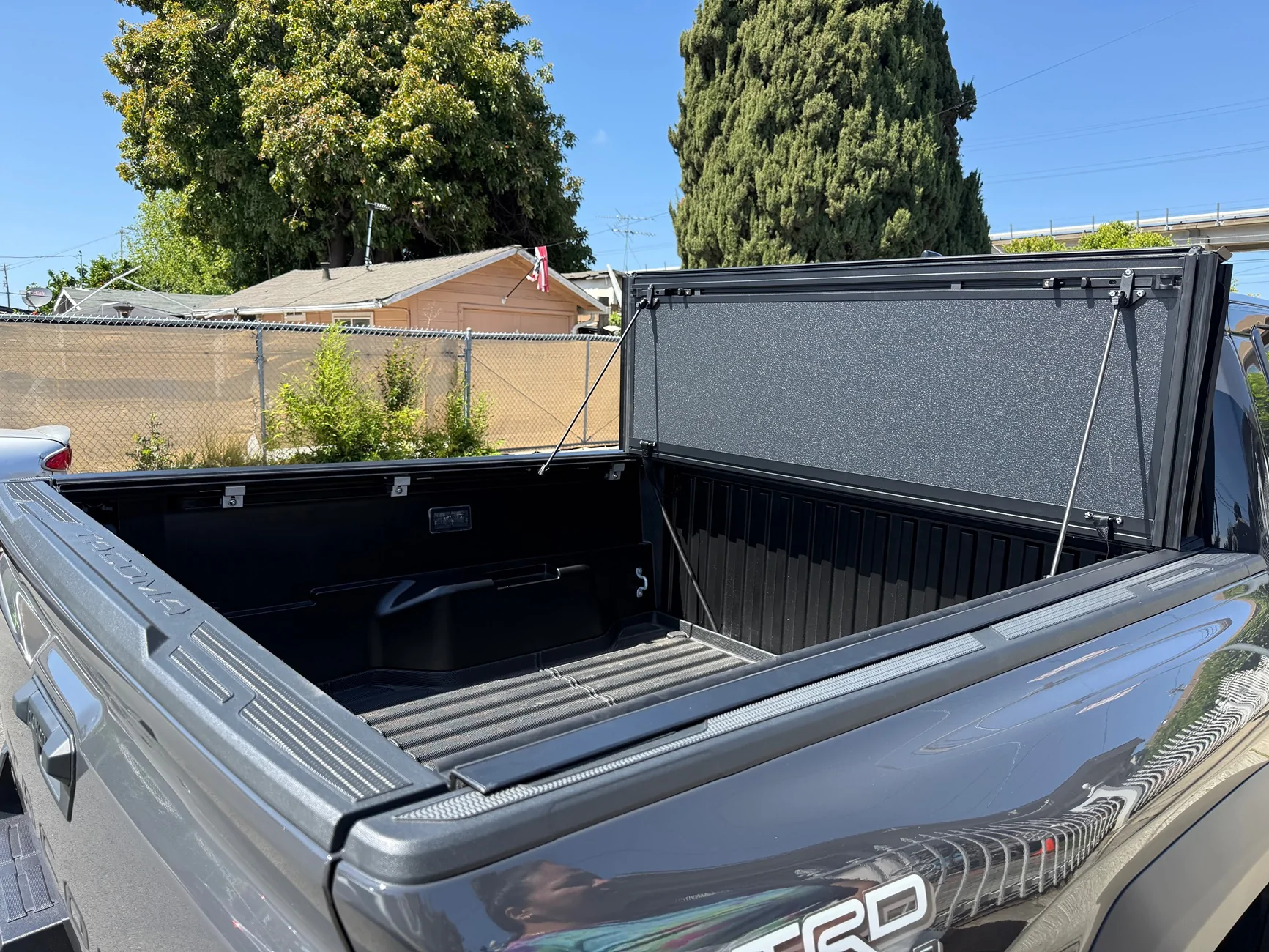

I have it on mine. It’s perfect. Great for the price and does the job keeping it water tight. I have the off road (not premium) same fit though. The one thing I didn’t like was the gaps on the bed rail towards the front of the cab. I recently saw someone made a fix for it on this forum so I swooped them up and that helped a lot. Great purchase though. Very interested to see how it holds up for a couple California winters….

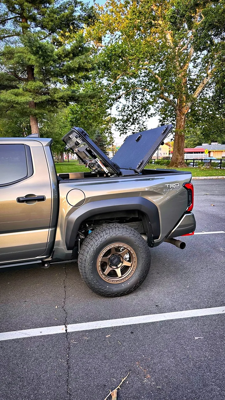

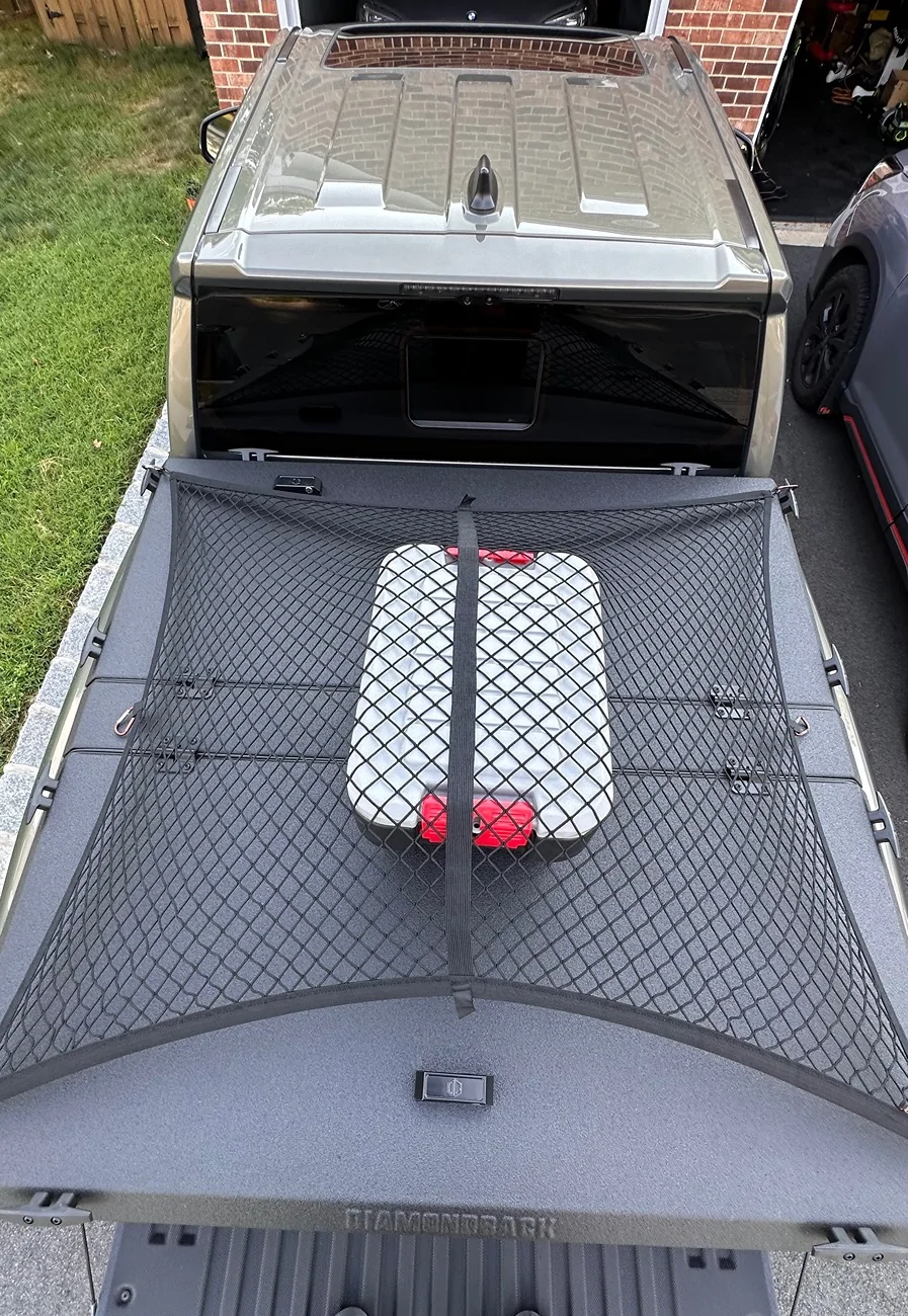

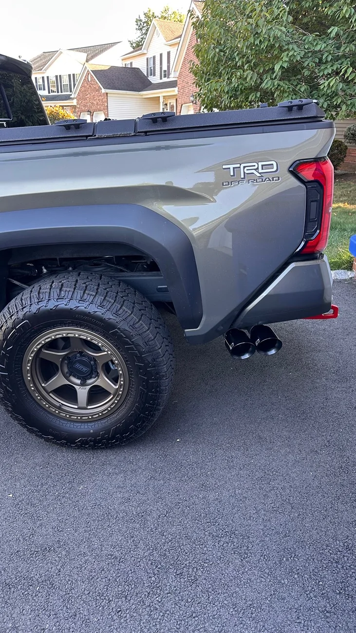

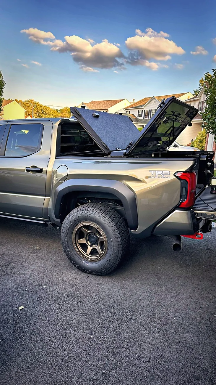

My diamondback cover interferes with the auto tailgate closures. I have to help it close once it gets closer to the covers edge and it’s because of the thick rubber seals that are on the cover. I was suggested to use silicone spray on the rubber but had not done that yet. Either way I love the diamondback covers over everything else on the market because of its versatility and impenetrable armor and I can load up to 1600 lbs on top of the cover if needed.
