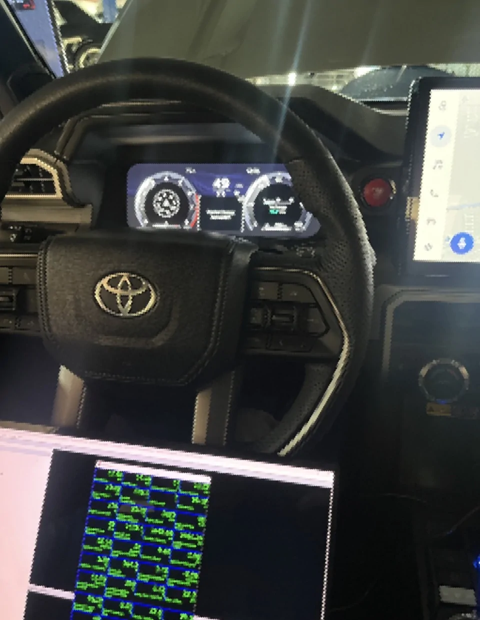

I've been spending more time on the dyno with my truck and Cobb Accesstuner Pro. While the tuning strategy varies a great deal from the Subaru world I've been a part of for 18+ years, they are very intuitive to tune, and making power gains is easy. I'll spend some more time this week and post some results. So far I have stock mapping and Cobb OTS, along with some early revisions of my custom mapping dyno plotted.
Throttle mapping, like other platforms I've tuned has proven to change the whole demeanor of the truck and retains eco, normal and sport functions, each with their own throttle tables.

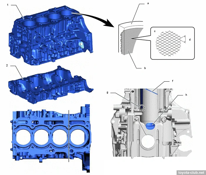

>Someone has been around some Subarus
Toyota made the bottom end pretty stout on these at least...

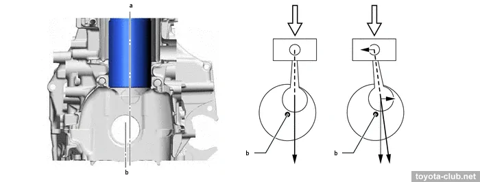

Like a lot of modern turbo engines, manufacturers are placing (too much imo) faith in the offset crank.

Time will tell what these will hold, but for the average owner with simple bolt ons who wants the truck with bigger tires or a camper shell to still be fun to drive, you aren't asking a lot of the powertrain. A properly tuned engine is very often safer than an OEM calibration even with more power. OEM's tend to prioritize power behind fuel economy, which, especially in a turbo vehicle means running it too lean into boost.

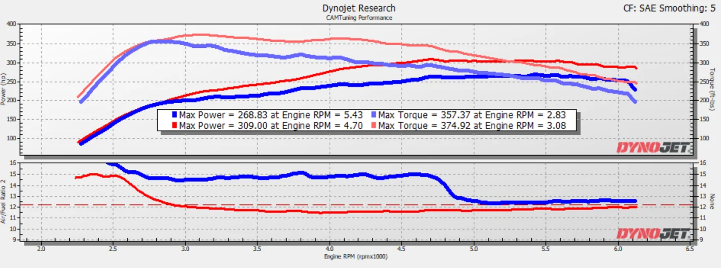

Quick sneak peak of the progress on our in house development TRD Off Road AT truck. This is on 91 octane, 4th gear dyno pull on our AWD dynojet (pulls done in 2wd). This truck is 100% mechanically stock with 6500 miles. Red is tuned by me on Cobb Accesstuner Pro, and the blue is the factory calibration. I'm extremely pleased with the improvement in power and torque, especially with the correction of the air fuel ratio in the lower rpm where the factory calibration keeps the truck leaner than ideal for a boosted application. Running richer without sacrificing power in that range is so much safer for the engine.

Damn the stock tune is way too lean.
I fear for the guys running 87.

It really is. Luckily the knock control system on this truck is really fast, so it will protect itself on 87, but I'd much rather have that fuel to keep it from detonating, and keep EGT lower. Surprisingly even when it is lean in the first part of the pull, the truck is not angry about it.

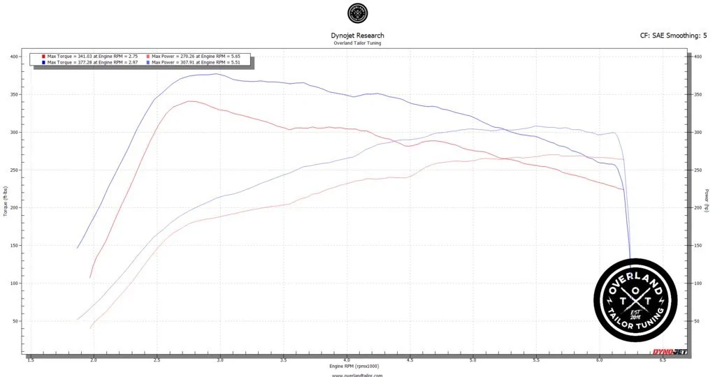

Showing basically the same results as OTT, but you've achieved peak hp almost 1k rpms lower which is kind of wild:

Well it's the wall of torque that is impressive/scary.
Smoothing is different on each chart but CAMs tune looks the least peaky torque wise, which is safer, nicer to spinny parts :)
