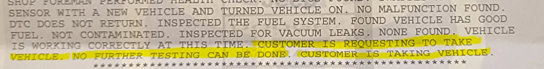

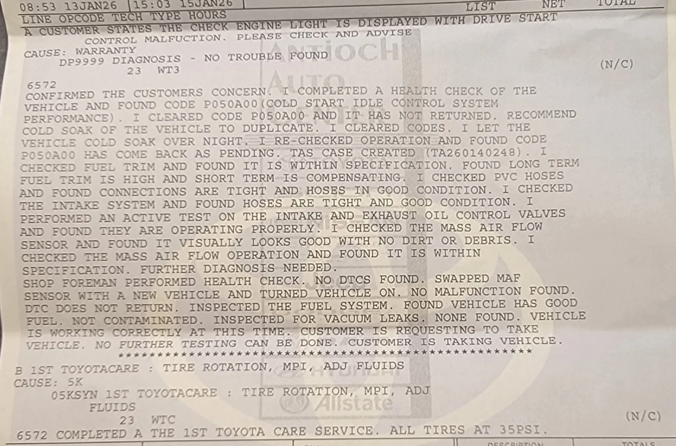

Just to close the loop, they basically found nothing wrong, replaced the MAF, and called it a day.
I didn't expect a miracle, but they kinda wrote it up in a way like I was demanding to have my vehicle back, so their hands were tied:
this was after they had had it for two nights, called me and told me they were at a loss, and there was no obvious fix. At every point in this process I told them "i mean do what you need to, but I'd like to eventually get it back" (again, no offer of a loaner or anything of that sort).
Full text:
Anyway, I have it back, will repost if it comes up again, but just closing the loop here for y'all.
