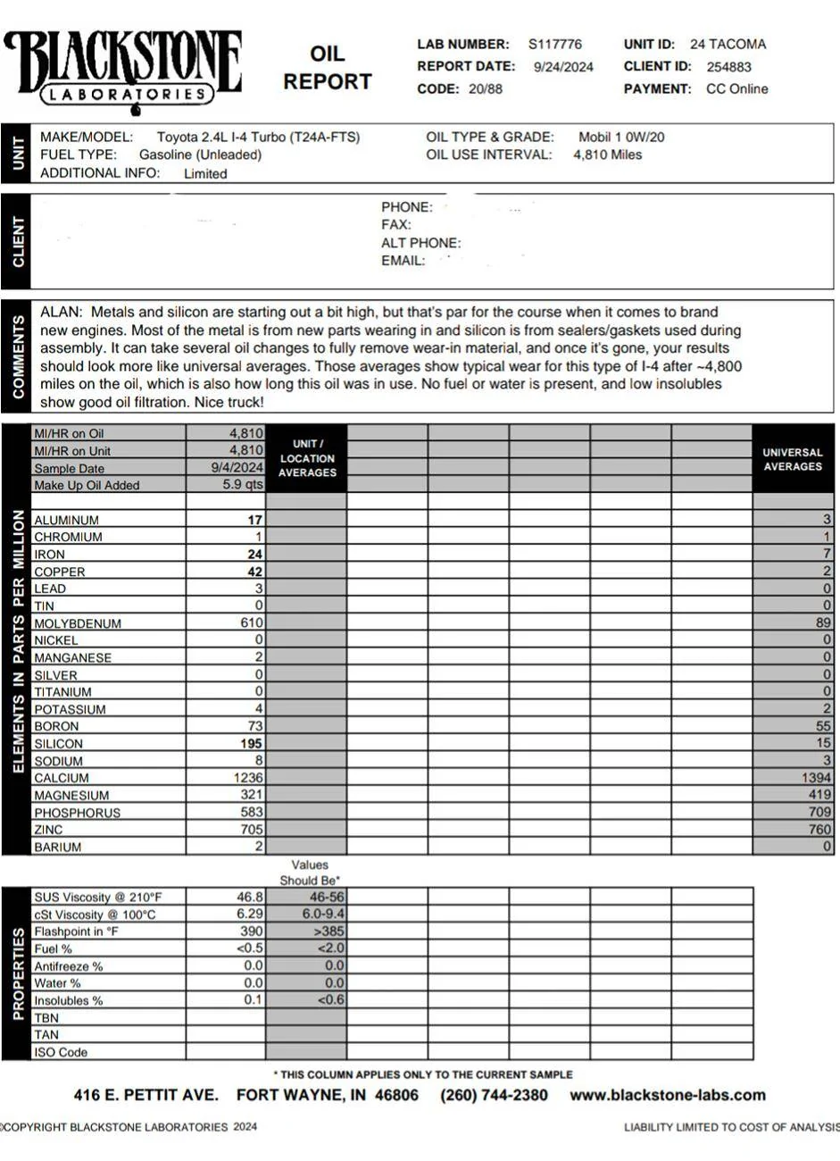

Decided to do a Blackstone analysis for my first oil change just to see if anything out of the ordinary popped up. Elevated silicon, copper, iron, & aluminum but this is somewhat normal for break-in oil.
I'll probably do another one at 15-20K (3rd change) miles just to see how it's doing, but otherwise a relatively uneventful and expected report.
Anyone else here send their oil off to Blackstone?
2024 Tacoma First Blackstone Engine Oil Analysis - Seems Normal (2024 Tacoma 2.4L I-4 Turbo T24A-FTS) Screenshot_20240925-083350

I wonder if the molybdenum was
From break-in lube which is sometimes
Used on valve train on new engines… I will send in a sample, just need to get to my first oil change interval-should be soon.

It's from the Toyota motor oil.
For a long time they used really high levels of moly. Pretty much higher than anyone else. I don't think the newer formula of Toyota oil includes as much moly.
It was definitely an outlier as far as oils because most oil brands are maybe up to 200 ppm. Valvoline's high endurance synthetic or whatever their flagship oil is uses higher amounts of moly than most other brands. I think around 350ppm.
You'll see it even when people do a second oil sample. They'll swap in something like mobile 1 which has low levels of moly, and the moly will still be triple whats in the M1 formulation due to the retained oil.

Was this a first oil change at 10k miles? Toyota genuine oil is really good stuff. Look at that amount of Molly, Dam… more then amsoil signature series over double actually

Just under 5K miles.

I do not know what the factory oil brand is, perhaps eneos… but Toyota dealership oil has all of the indications that Mobil 1 makes it… the bottle design and location is a strong indicator of it. Perhaps a second oil change with oil test would prove my theory correct… different oils, based upon your moly ppm spec in the Mobil 1 oil.

The oil is made by Exxon/mobil. It’s not anything close to Mobil 1 chemically. The Toyota oil is made to a much higher standard specifically for Toyota.

Higher standard is a bit of a misnomer... same standards, different additive composition. The Japanese OEs all have a high moly content in their OE formulations as they believe it will ever-so-slightly decrease fuel consumption. I don't believe there are any off-the-shelf oils that have this much moly in it... even Liqui-Moly probably is around 200 PPM.
