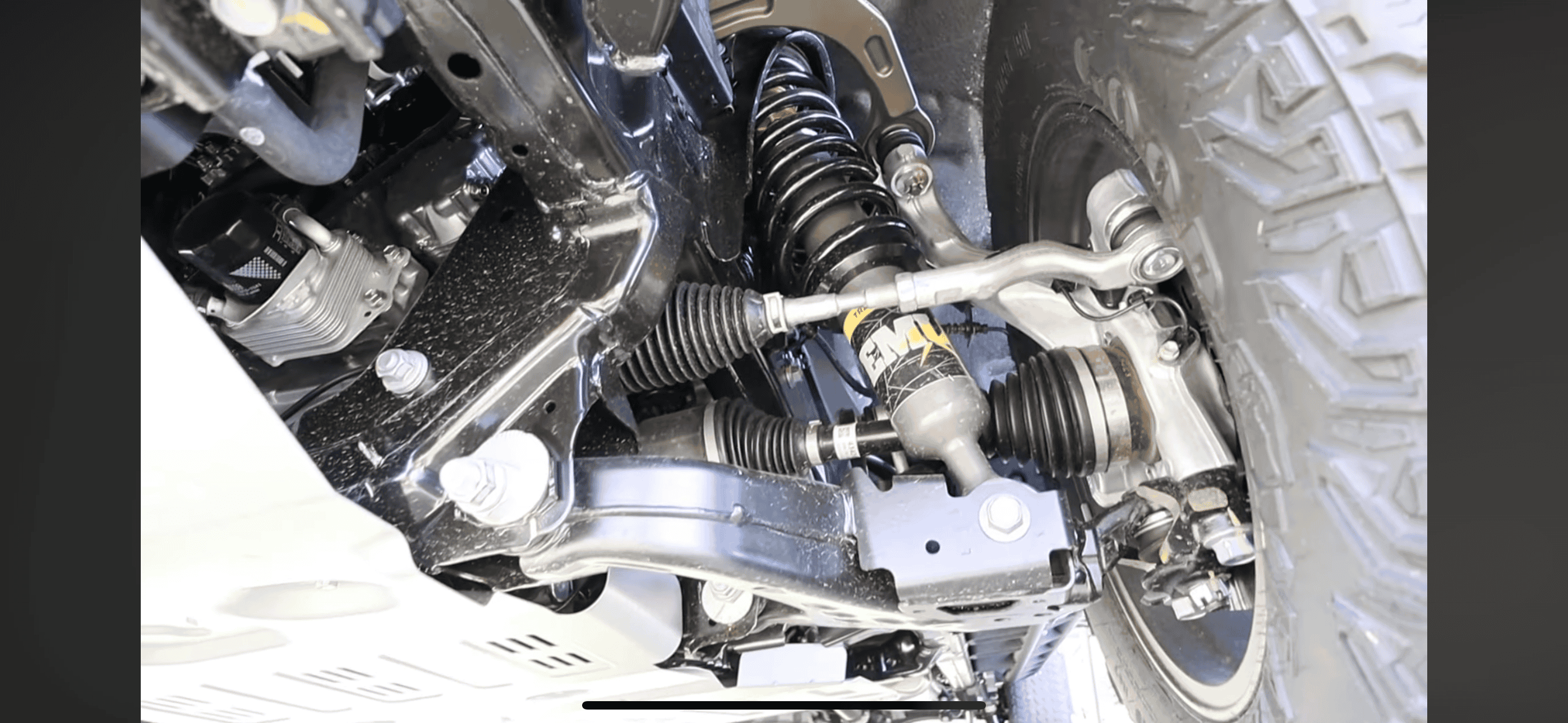

iForce Max oil filter location driver side front. Looks like an oil cooler and drip guide. I wonder if there is a way to capture drips without removing bash guard? I normally use an oil vacuum pump through the dip stick for changes so just a bit of oil left in the sump to capture when changing the filter.
