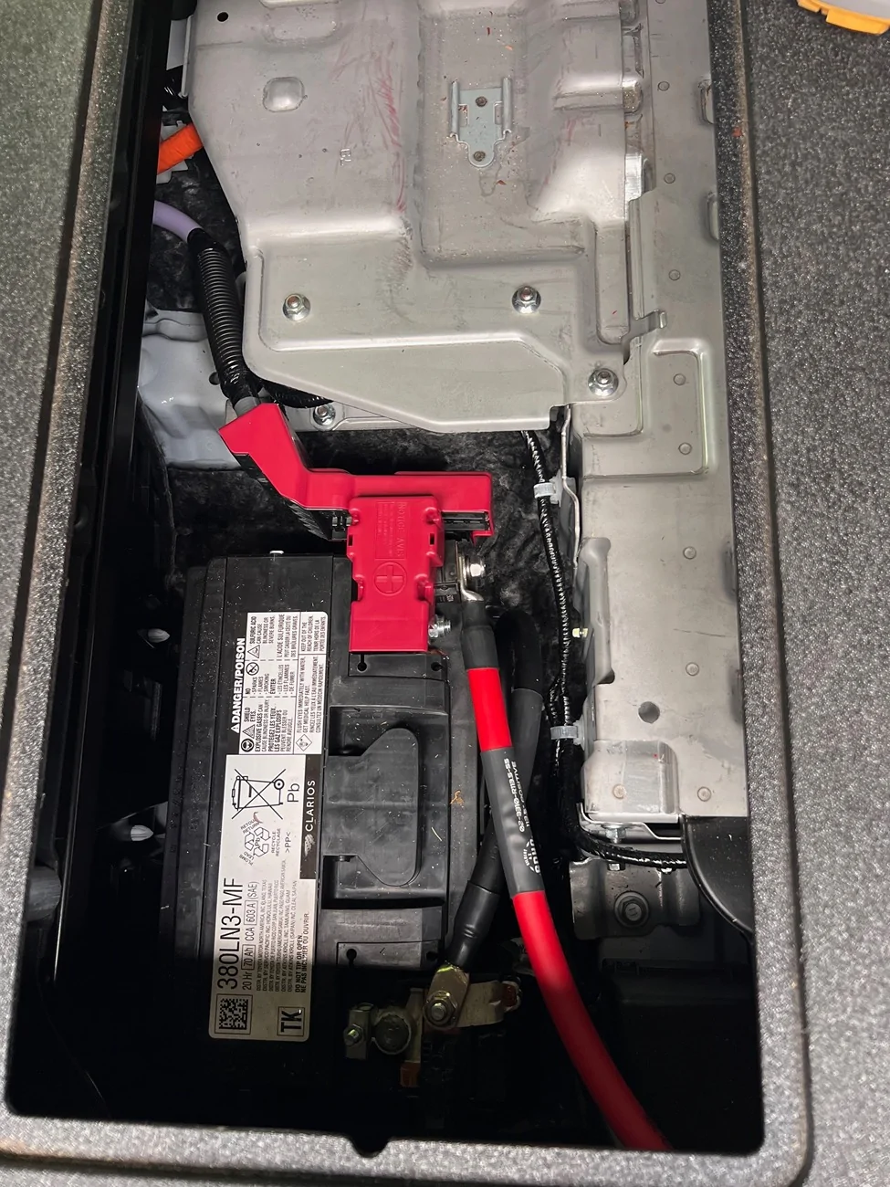

I wasn't really happy with the exposed battery connections, particularly after I added the SDHQ power relocation so I could power a winch on the front bumper. Lots of very high power exposed connections in this area, and I didn't want to start throwing stuff down there.

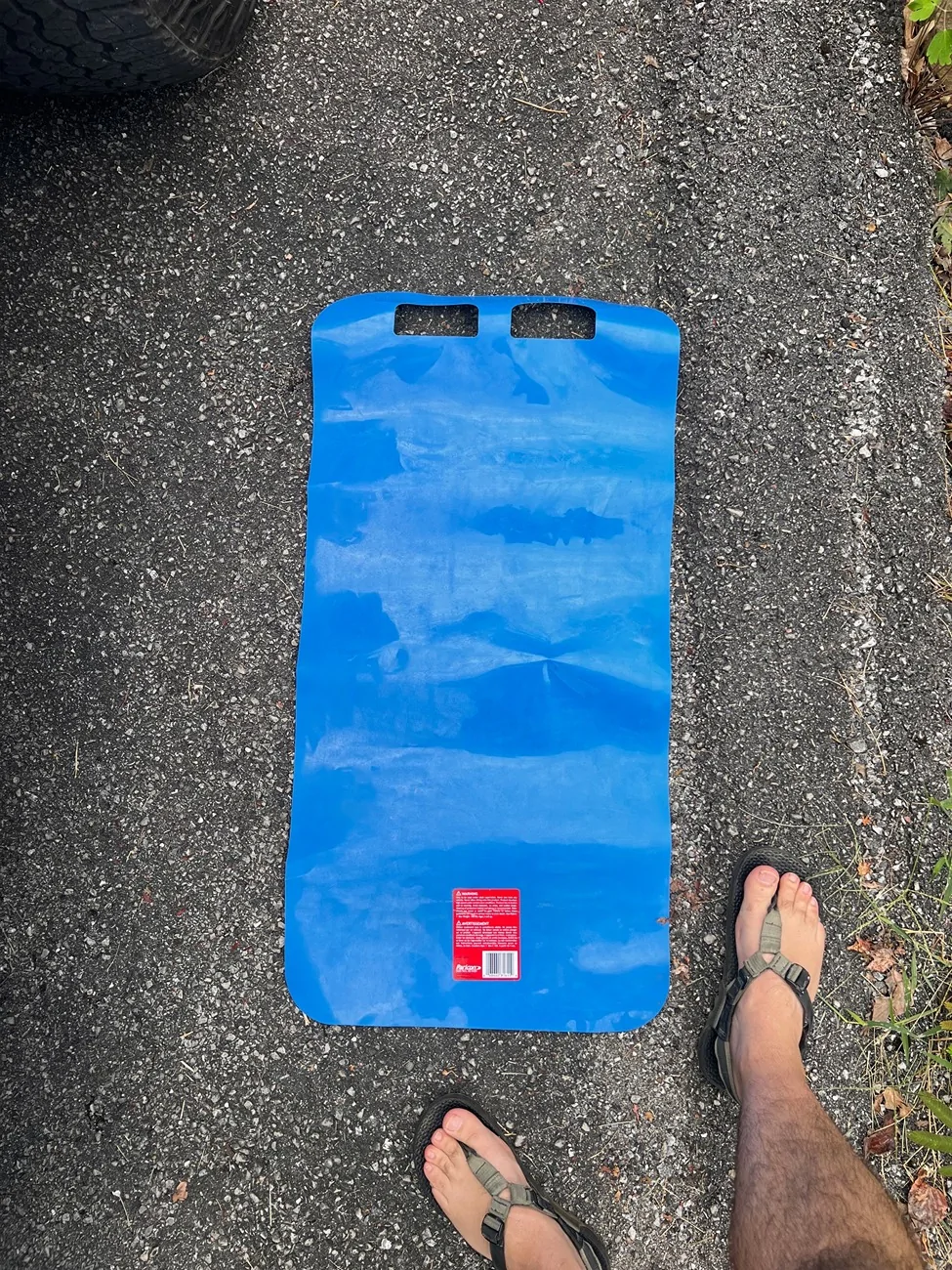

I had one of these heavy plastic toboggan/sled/lava tube crawling tool hanging around, and figured it would make a good insulator for the battery compartment, as it is fairly rigid. (Paricon Flying Carpet is the official name.)

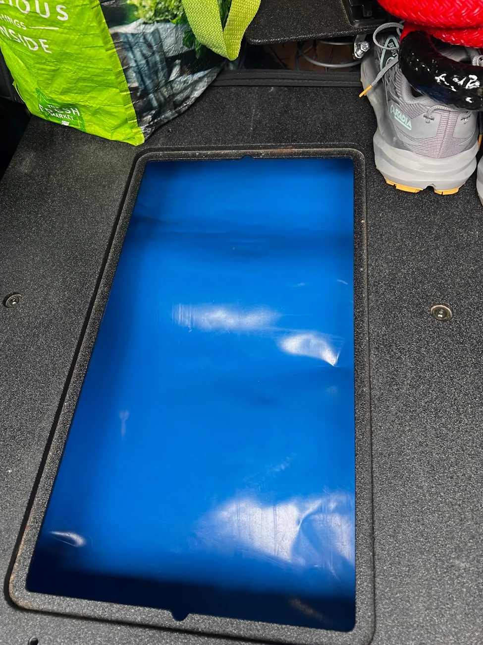

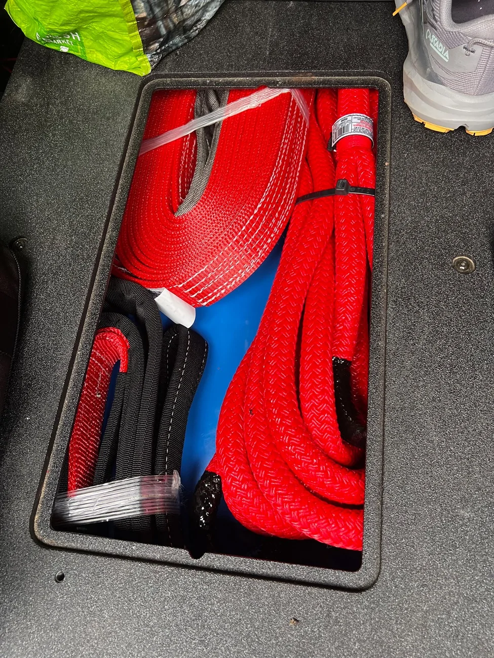

It happens to fit perfectly. covers all the battery bits, and leaves an almost 5" (why?!?) high storage area under the platform. Ends up being a great place for storing all my recovery straps, bits and bobs. I had it stuffed on the floor in front of the third seat, but this is way better. All of this is above the level of the filtered vent, so air flow will travel below the sheet to keep the hybrid battery cool.

That does look good and functional, just make sure you’re not blocking air flow for cooling.

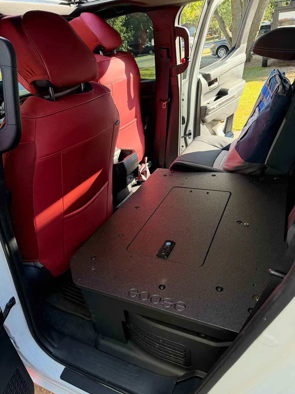

There are plans to secure it. The seat up against it is good enough to hold it down for now.
