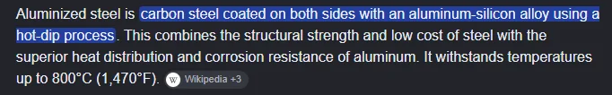

Not that I believe everything online, or Wikipedia, but based on what LRA states, it is still a steel tank, not an aluminum one. That would be why it doesn't outright requre a skid plate. That being said, anyone with proper fabrication skills and tools would be able to build their own skid plates if they really wanted to. I'd be more interested in knowing how much of the 2mm thickness is steel, and how think the aluminum coating is.
