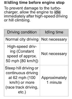

This video mentions idling the engine after hill climbing or high speed use and sure enough the 2024 Tacoma Owner's Manual has an entry about that.
2024 Tacoma PSA: allow 2024 Tacoma engine to idle immediately after high-speed driving or hill climbing (per owner's manual) 1708890971062
Soooo, does this mean if I've been going down the highway at 70-75 for a while and I pull into a gas station, I need to let the truck idle before pulling into a pump and shutting it down?
Edit: Poking around the web indicates slowing down to run on surface streets counts toward the "idle" time so by the time you actually pulled into a gas station, you're probably fine. The only real scenario I can come up with is pulling into a rest area off the freeway. That's generally a pretty quick slow down to a stop so you might want to do short idle in that specific case.

Yes, idle for a minute after high load or speed to allow the turbo to cool. A minute is what I saw. I will probably idle for a minute if pulling off highway to refuel.

Any deceleration counts towards the 1 minute time. Exit ramps, rest stops, gas stations should all have a declaration unless you like coming in hot. On scenario I can image is if you have an emergency stop on side of highway and cut off the engine.

It's a turbo thing. helps to keep oil circulating in the turbo to help it cool. There used to be kits available where it would have a timer on it, when you shut the car off, it would run for another 3 minutes and then shut the engone down after 3 minutes after you took the keys out of the ignition and left the car. Kind of an opposite of an auto start, an auto off.

Agree… it’s really not the biggest deal, the kit that let the engine run after shutting the vehcile off was designed for racing applications, after a car got off the track, check with some diesel guys, everything diesel is a turbo. It is commonly written, but it’s not something the average have to be neurotic about.

I am kinda amazed that Toyota doesn't just have one built into the software. At the same time 1 minute even while driving isn't a big deal at all.

I watched the chief engineer talk about the commercial grade turbo and how it has larger hoses to cool it. Hoses they would put on a V8. He also said they ran the engine in different angles to simulate off road positions.
It made me feel pretty good about getting a Tacoma with this engine.

The idea of letting the truck idle for a minute is to allow engine oil to circulate through the turbo to cool it down and also to prevent oil coking. It also allows engine coolant to cool the turbo down too
