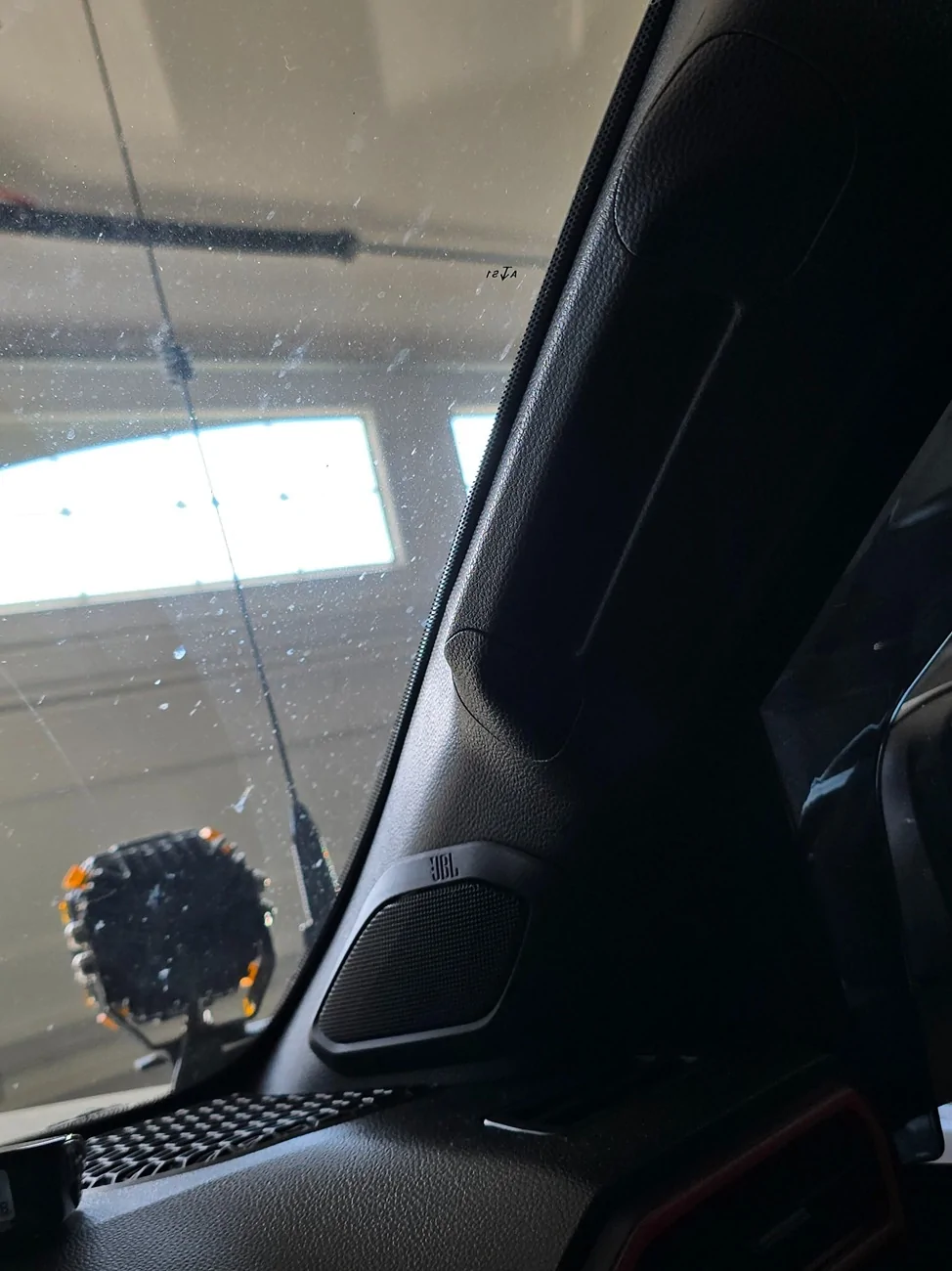

My son just installed my new handle yesterday. The original had the JBL speaker grill connected by melted plastic points on the ends instread of them using the screws in the holes. He tried to use the screw holes in the new handle, but they didn't line up to be of any use. What he did was to dremmel them down to the main surface area and had them attached just by the clips in the handle which do match and hold. That didn't provide enough to keep the speaker in place due to the amount materials behind the speaker that would push it outward.
The solution was to continue to use the clips, and then to seal around the entire inside housing area with black silicone. After a day of curing, it worked perfectly and no silicone can be seen in the grill area or anywhere outside. The handle does provide a good grip for supporting you to enter and exit the vehicle and it looks great. It all matches just like the factory one on the passenger side.
It would be nice if the screw holes on the new handle matched up with the OEM JBL speaker assembly, but other than that, all is good with a few extra hours of work.
I have said I wanted a full handle and not just a grab handle, but in the end I do find that it does provide a good enough grip to assist with entering and leaving the vehicle and worth the effort.

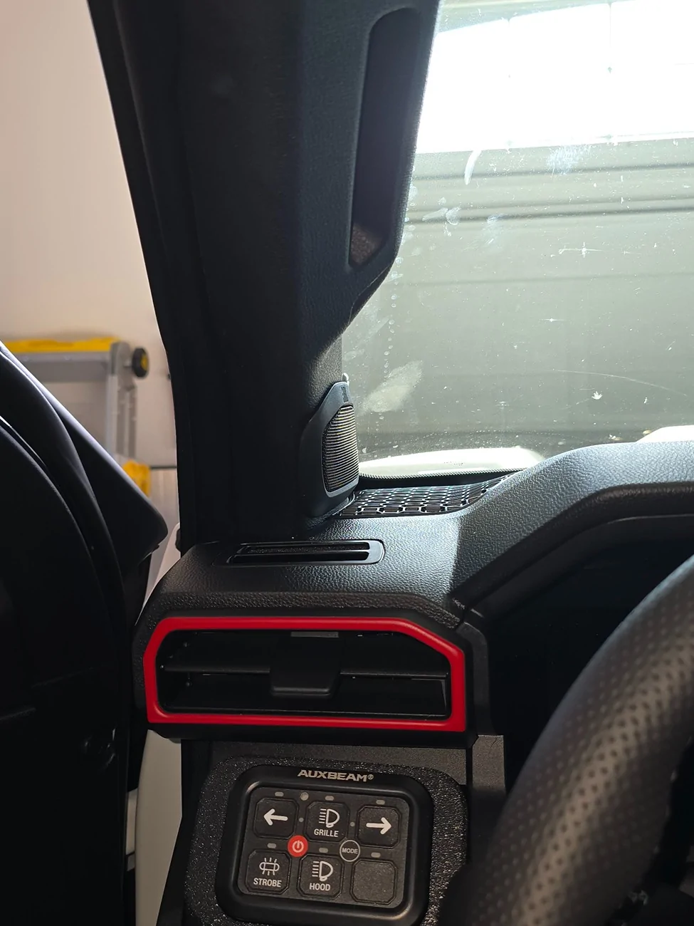

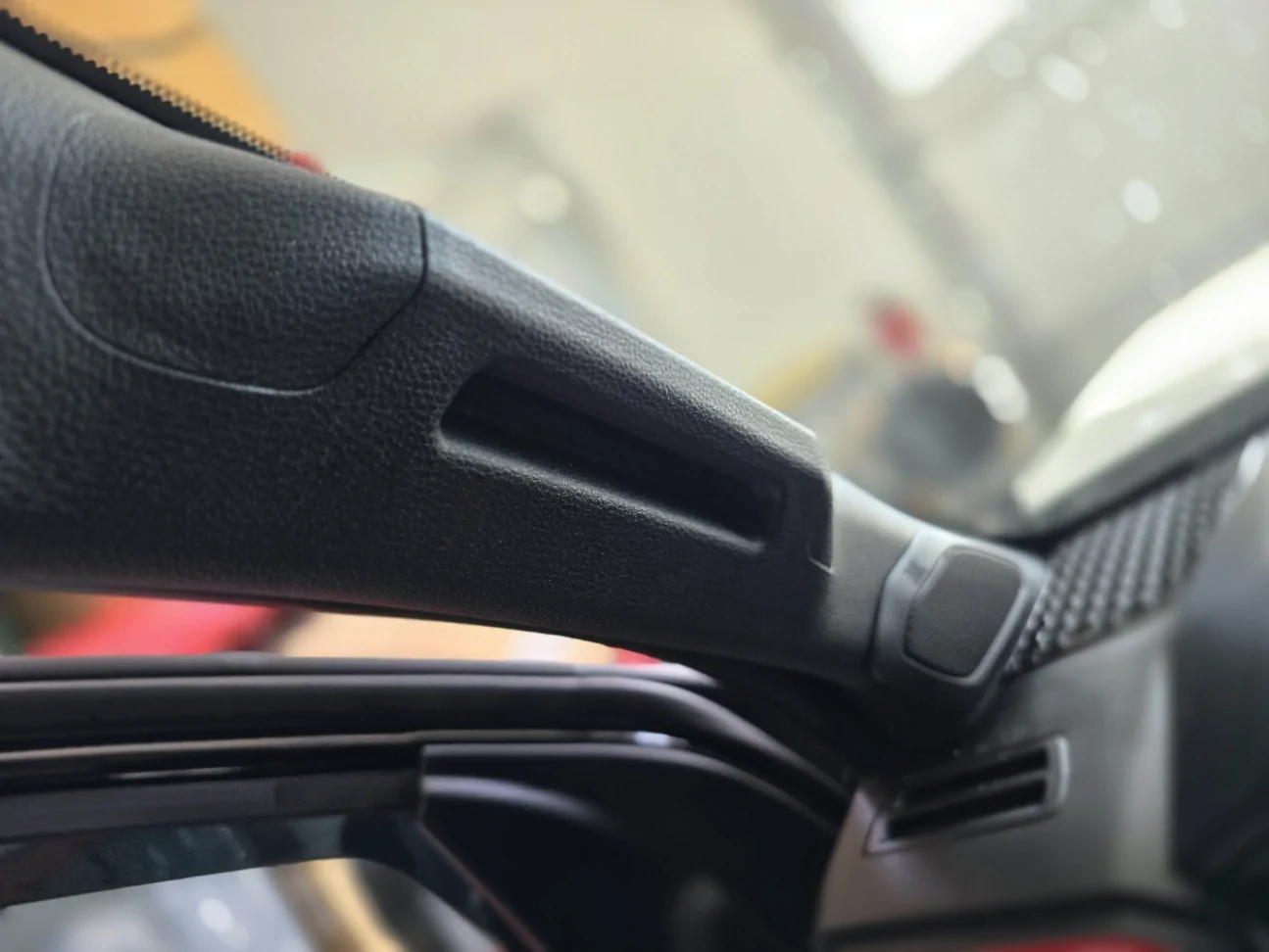

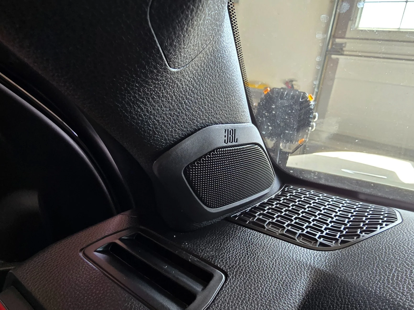

Unfortunately I don't have any pictures of the process, but both speaker assemblies do match perfectly with the exception of the screw holes in the rear which weren't used during my replacement. We used black silicone to ensure the grill was held in place besides the plastic spring clips that did align perfecly, but just weren't effective alone to keep the speaker grill in place. You will need to dremmel off the OEM melted plastic which was used in the screw holes by Toyota to get the grill removed from the panel. Not sure why Toyota didn't use screws. Really not that hard a process and the final result is a well fitting match with the passenger side.
If you don't want to go through with the process I will say that the replacement handle's speaker grill is very well made and does match the Toyota panel with only the JBL lettering missing.
Here are some photos of the handle panel, speaker, and some of my front cab enhancements.
